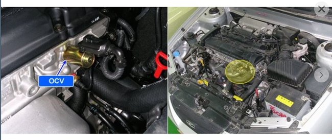

Would you recommend changing the oil control valve? Recommendations to fix the issue would be?
Nov 5, 2018 at 7:37 AM
I would start by flushing the oil system. It may have sludge in the valve.
Use a product called sea foam for the oil. Add it to the oil and let the engine run for about one hour. Then change the oil/filter. Then change the control valve, clear the code and see if it comes back.
Nov 5, 2018 at 7:40 AM
STXHAMMER
  • 47 POSTS
Okay. So change the oil control valve or the variable valve camshaft position actuator solenoid? Or are they the same really?
Nov 5, 2018 at 7:52 AM
The control valve is part of the solenoid.

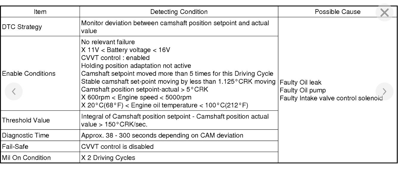

P0010
Descriptor
Camshaft Position-Timing Over-Advanced Or System Performance(Bank 1)
Probable Causes
Faulty Intake Valve Control Solenoid
Faulty Oil Leak
Faulty Oil Pump

Is that the valve we spoke of?
Nov 6, 2018 at 1:48 PM

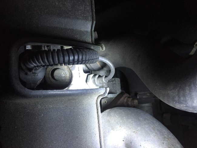

I attached a picture way back at the beginning of our posts.
