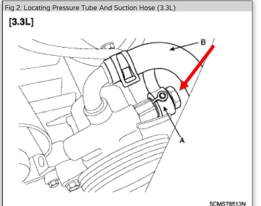

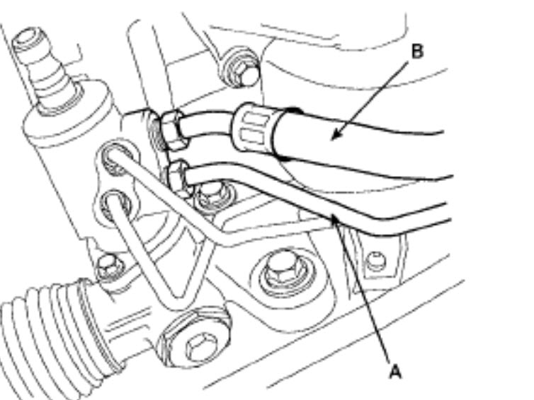

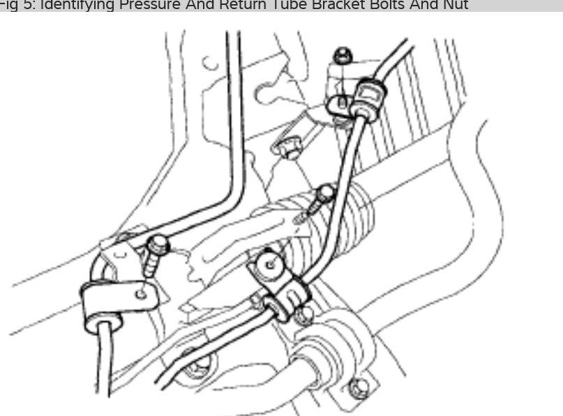

How do I get the high pressure line off the pump?
Tuesday, May 23rd, 2017 AT 4:40 AM
HMAC300
MECHANIC
48,601 POSTS
See pictures. You will need line wrenches to loosen at rack/pinion and need to take off bracket bolts to remove the line. Do not lose the washers that attach to pump they are for sealing and if you lose them it will not seal.
