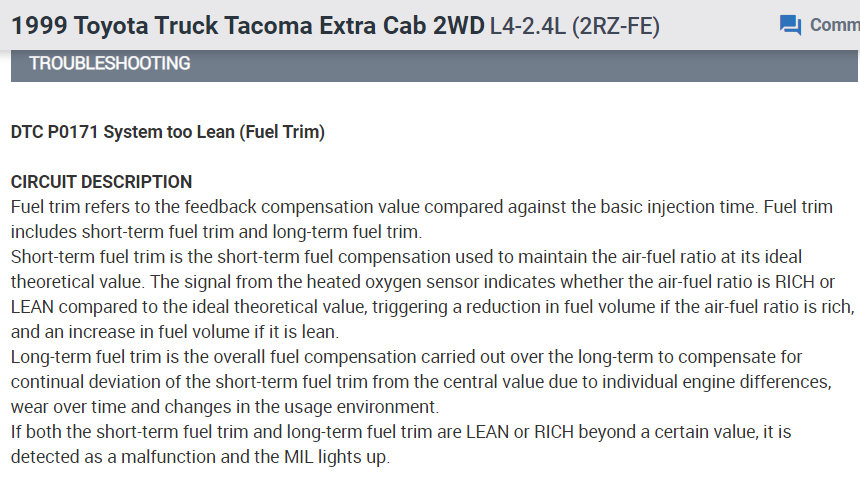

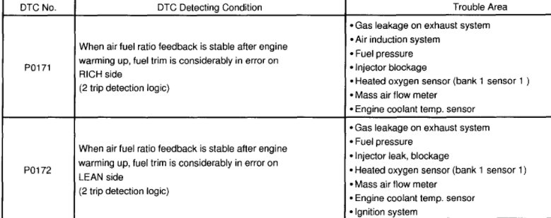

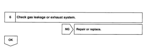

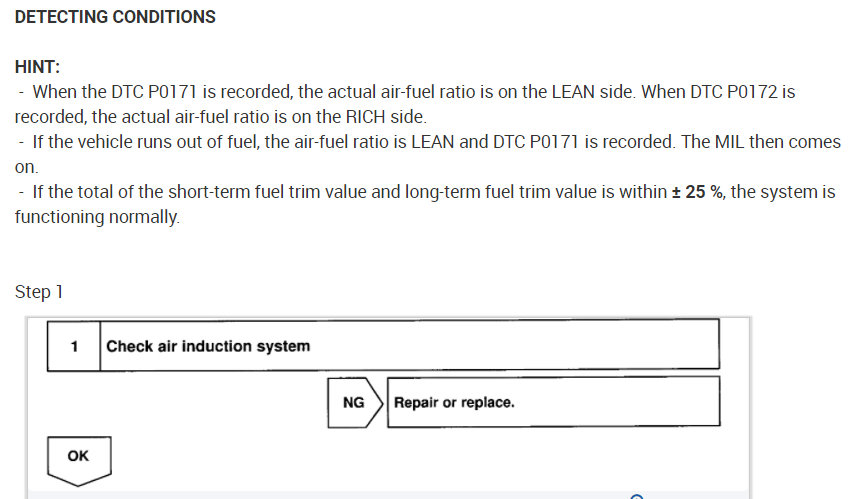

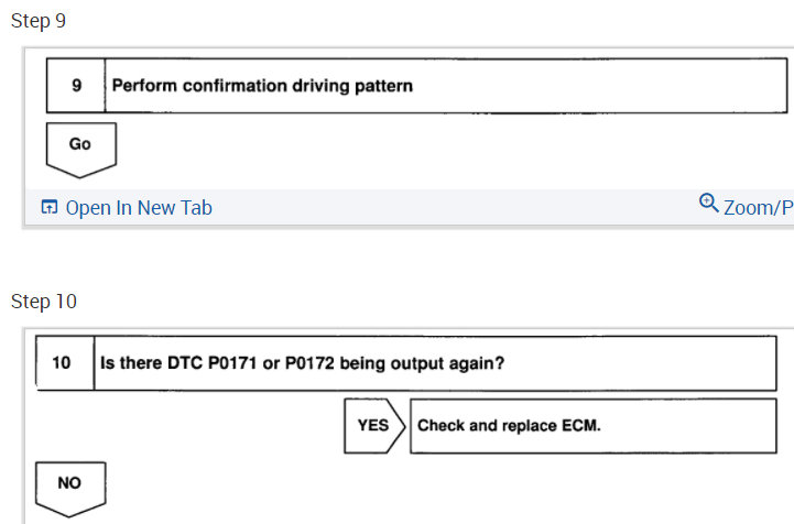

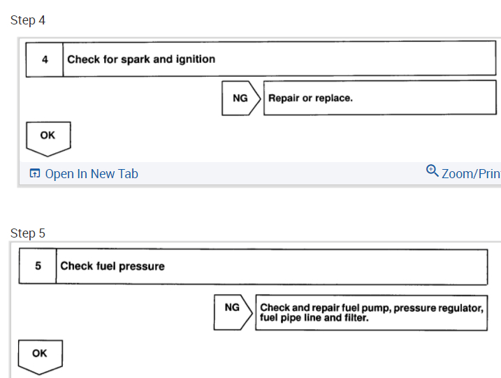

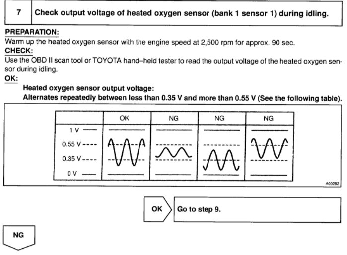

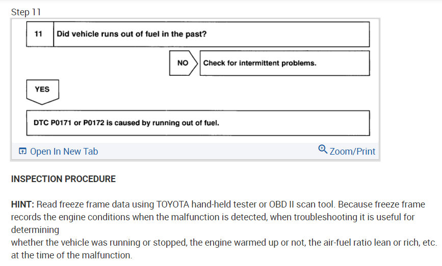

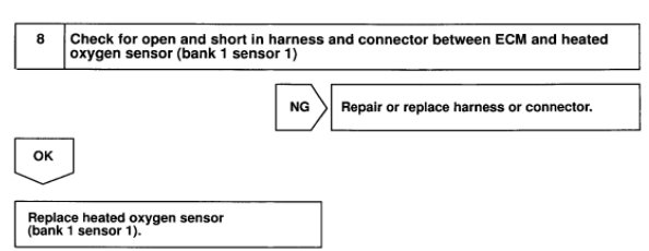

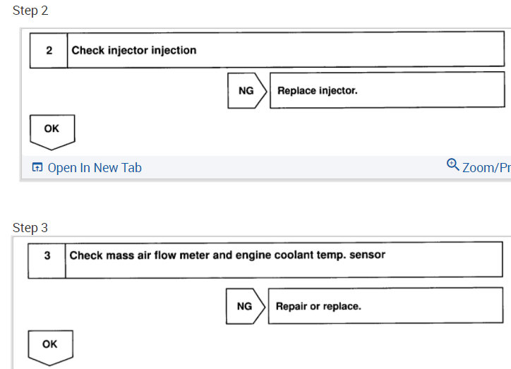

P0171? System too lean? How to fix?
Wednesday, September 30th, 2020 AT 2:14 PM
DANNY L
MECHANIC
5,648 POSTS
Hello, I'm Danny.
Here is the information you requested for the code P0171. I've attached below the specific diagnostic steps for your truck below. Keep us updated and let us know what you find. Hope this helps and thanks for using 2CarPros.
