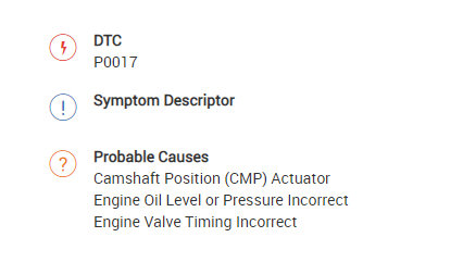

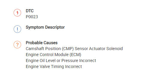

My engine was fixed. I believe they played with the timing chain and now I have those two codes.
Aug 18, 2021 at 1:32 AM
Experienced Mechanic
52,796 POSTS
Good afternoon,
What was repaired on the engine? Please give me the details.
Both codes are related to the timing chain.

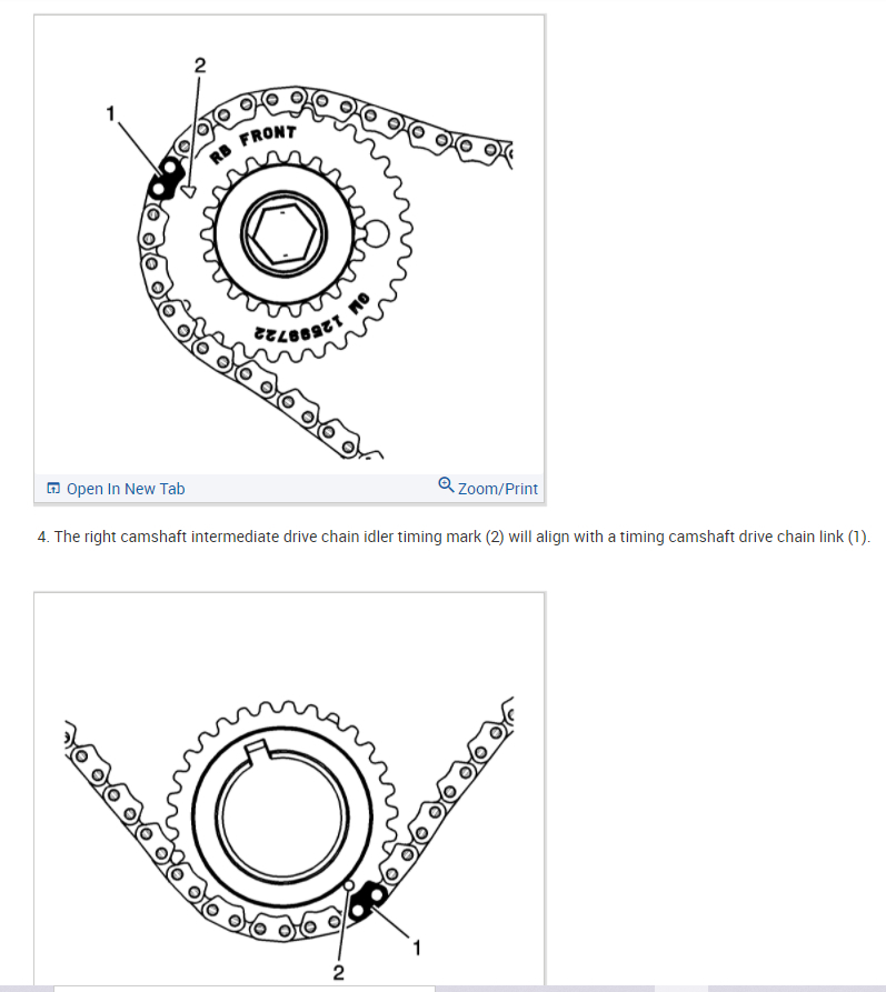

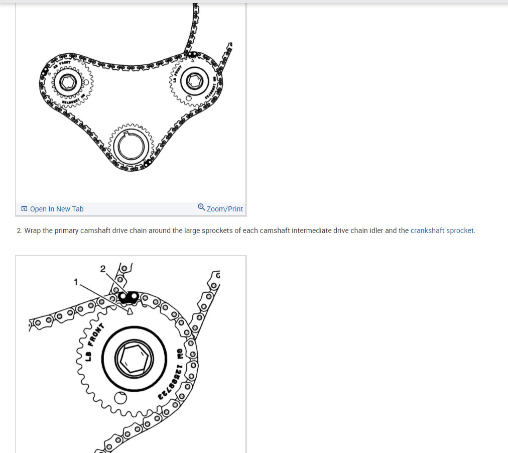

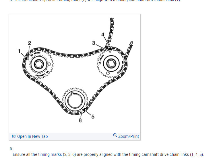

They replaced the valves.
Aug 18, 2021 at 5:51 AM
52,796 POSTS
Okay, thank you.
They have the timing chain on wrong.
Return the car to the repair shop and have them set the timing correctly.
I attached a diagram of the lower chain that is most likely the issue.
I attached a YouTube video of the procedure for you.

Because it lost compression.

Replacing the camshaft position sensor and crankshaft position sensor could be a solution?
Aug 18, 2021 at 6:30 AM
52,796 POSTS
No, not at all. The timing is incorrect. The sensors just send a signal to the ECM. They have nothing to do with adjusting the timing.
