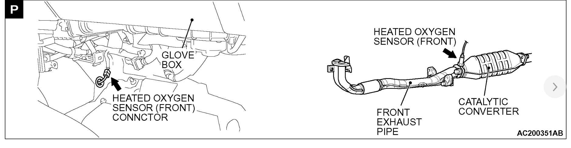

Technicians can anyone there tell me what metric size is the hex nut too the oxygen sensors.at the moment,the largest I have is 17 mm and it's way too small!I'm thinking 19 or 20 mm box wench size unless it's a 11/16ths or something.would it be a 9 or 7/16ths.im not sure.may I get some diagrams from the source.

The size is 34 mm or 7/8 here is a guide to help walk you through the repair with diagrams below to show you on your car.
https://www.2carpros.com/articles/how-to-replace-an-oxygen-sensor
