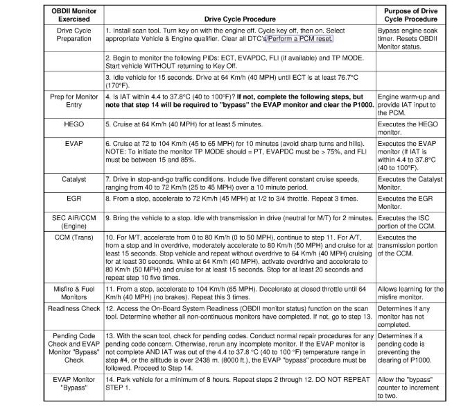

I attached or posted the possible reasons for the code. Since these codes did not set prior to the replacement of the sensors, I think it is an issue with the sensors.
They should read around .5 volts constantly. They will not vary like the front sensors. There only purpose is to monitor the cat converters. If the sensor vary like the front, the cat converters are bad. It would set a 420 code if that was the case.
Get a good quality sensor. Do not go cheap. Quality matters with O2 sensors.
I also attached the drive cycle for you to follow when you are finished. Make sure you clear the codes before performing the drive cycle.

Yes I would return those sensors because if the monitors for the heaters and sensors completed without setting a dtc then the pcm did not see an issue there. These sensors should stay at a steady .4-.6 volts at idle after the vehicle has warmed up. Now they will in fact show 0 on cold starts because they are post catalyst and do not see the amount of fuel that the pre cat converters do. If there were an issue with the heater circuit it would have set a code for all four sensors, and if there were an issue with the circuit between the pcm and the sensor, 99% of the time it would only give you a code for one not both. So get those sensors changed out with good quality ones and let's go from there.
