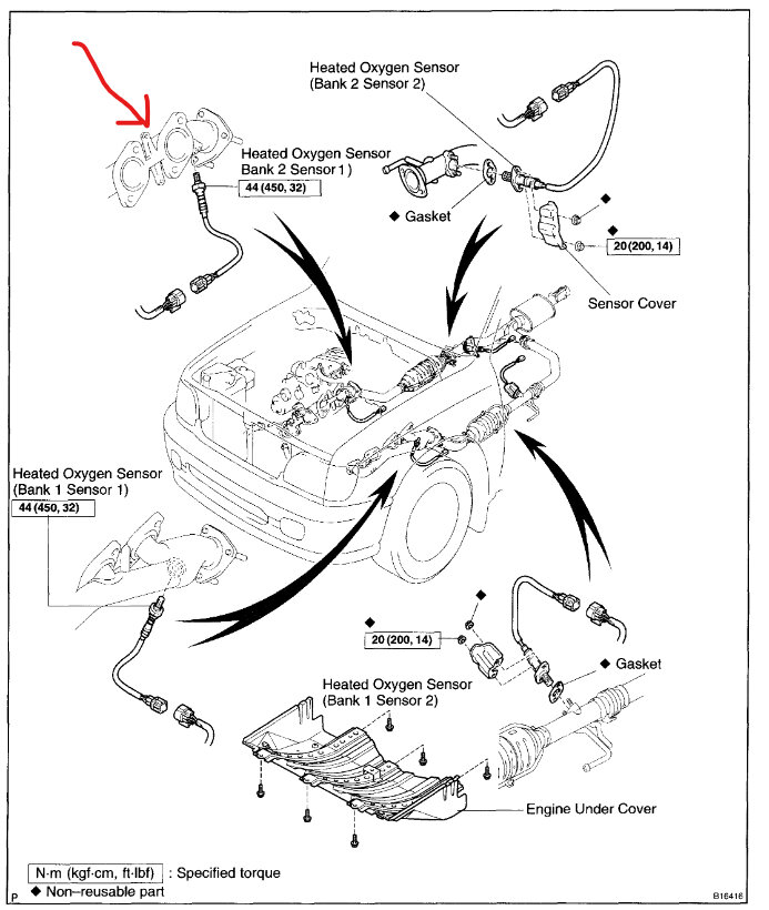

Drive cycle won't complete. I have replaced the battery and driven 150 miles. I drove the car like Toyota drive cycle says but o2 sensors say incomplete. All other monitors say complete. Scanner says bank 2 sensor 1 no data retrieved. The other 3 sensors have data on the scanner.

It sounds like the bank 2 sensor one needs to be replaced. Here is a generic guide to help you step by step with instructions in the diagrams below to show you how on your car:
https://www.2carpros.com/articles/how-to-replace-an-oxygen-sensor
Check out the images (below). Please let us know if you need anything else to get the problem fixed.
