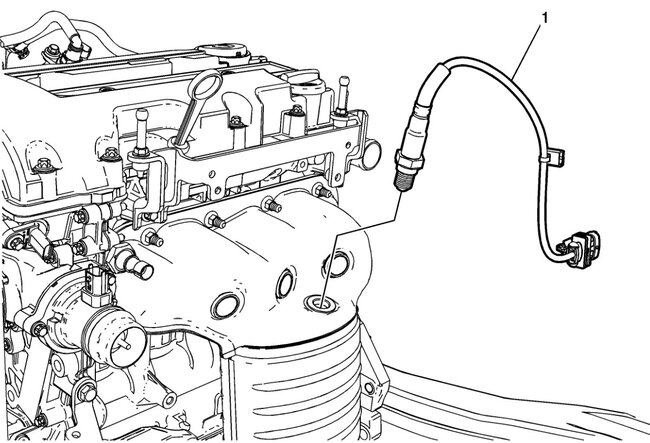

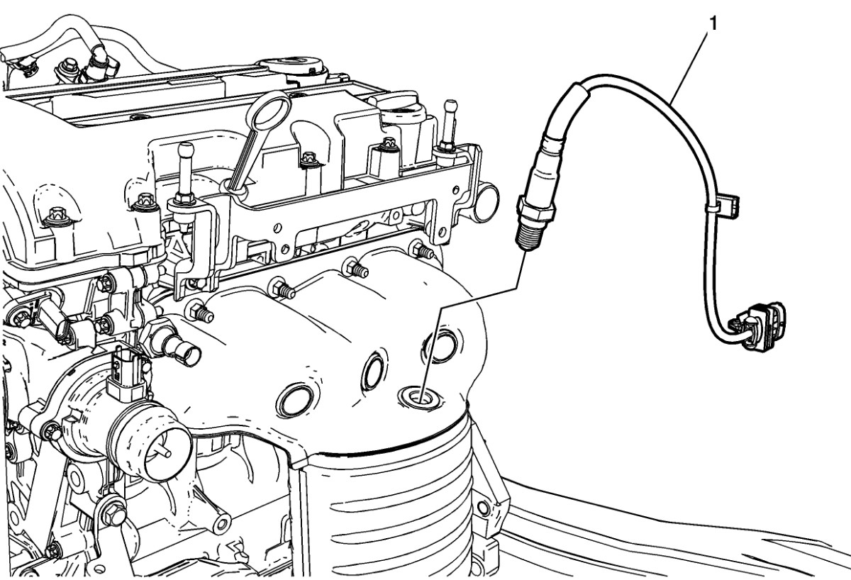

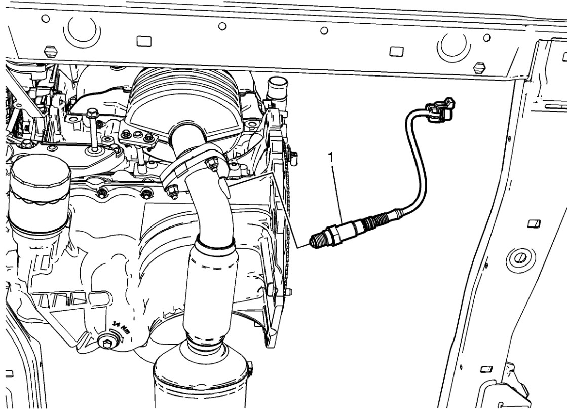

How many Oxygen Sensor or sensors does this vehicle have?
2014 CHEVROLET VOLT
136,000 MILES
PJAMZ1
Locations would be very helpful. Thank you.
Jul 6, 2024 at 2:10 AM
STEVE W.
  • 15,345 POSTS
That car has 2 sensors on it. The upper sensor (part # 55569903) is visible in the top of the exhaust converter- manifold and the lower sensor (part # 12612430) is in a bung welded to the exhaust pipe that bolts to the bottom of the converter. Both are torqued to 31 ft lb if replaced. Are you having an issue where you think one might be faulty? If so what are the actual codes?
