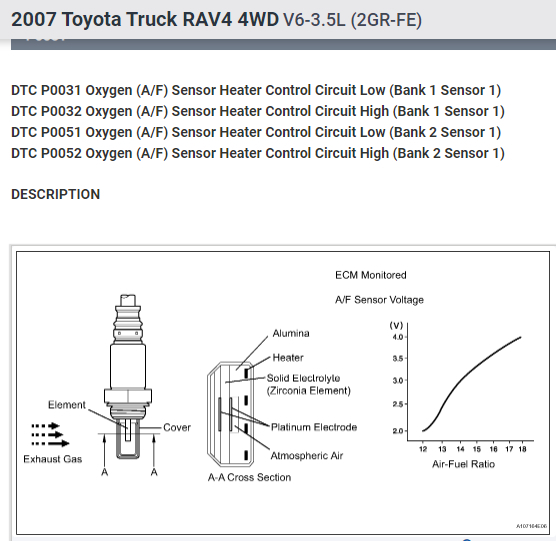

oxygen sensor heater control circuit low, code p0031
143,000 MILES • V6 • 4WD • AUTOMATIC
HANS DUHAYLUNGSOD

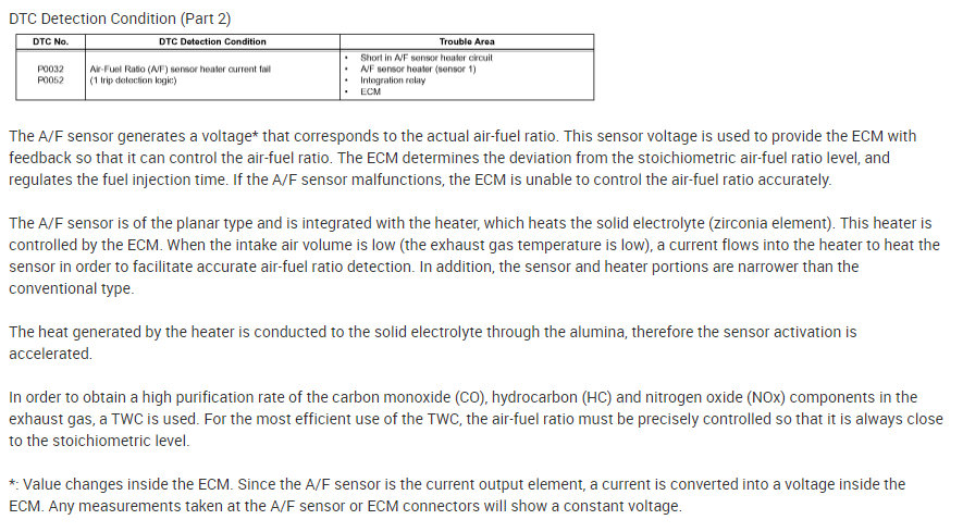

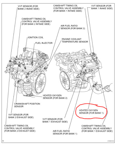

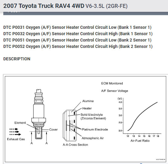

engine, VSC, 4 wheel lights on. I checked it OBD scanner it says p0031 oxygen sensor heater control circuit low (bank 1 sensor 1).
I had replaced both sensor bank 1 and bank 2 between catalytic converter but lights still on. I tried to erase it using OBD scanner it wont work. I need someone who have same issues or professional advice.

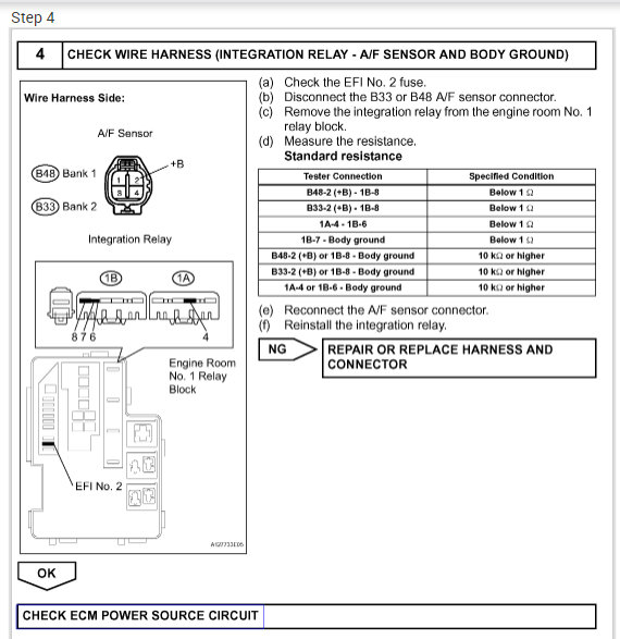

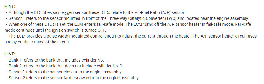

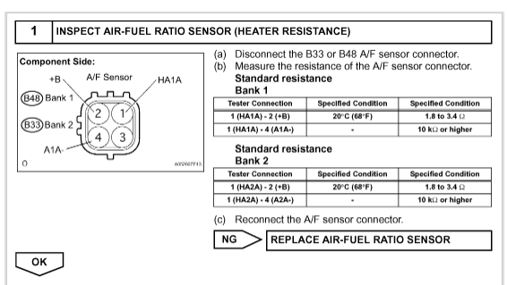

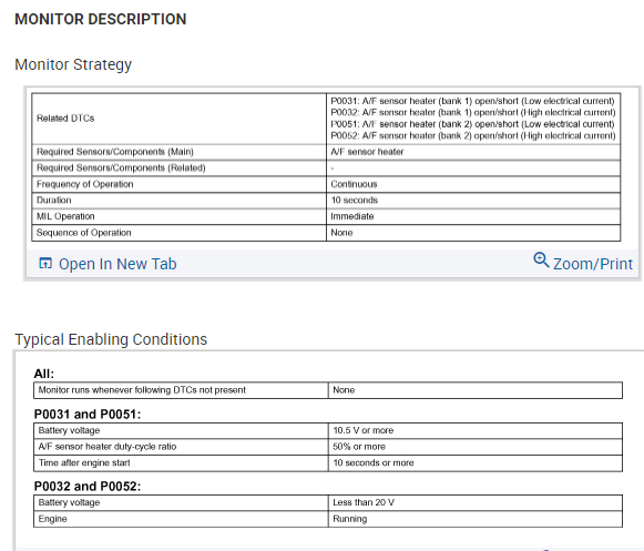

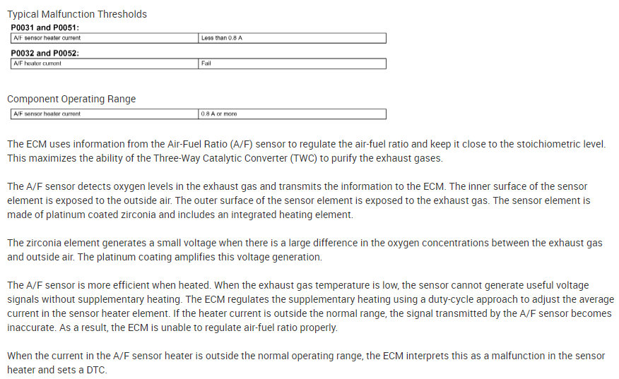

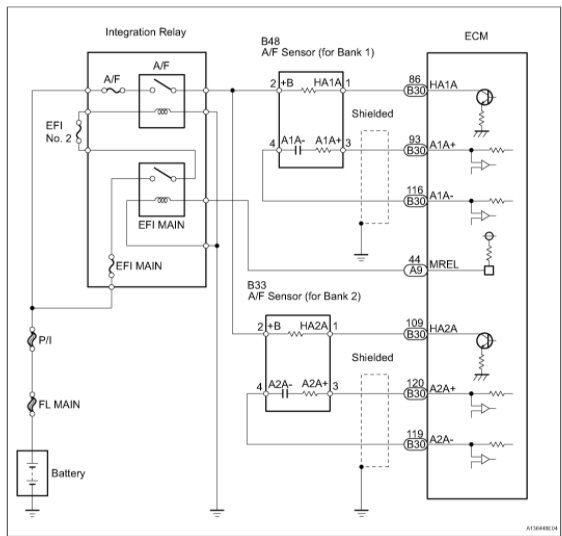

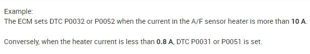

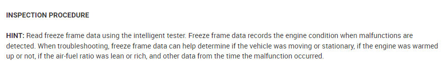

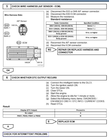

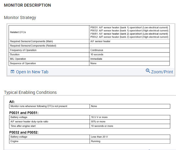

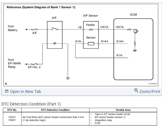

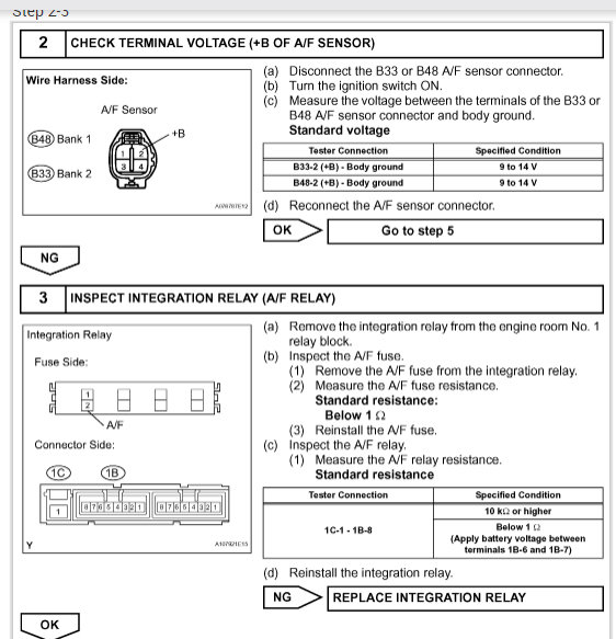

I've attached picture diagnostic steps below for the code P0031 for the oxygen sensor on your Toyota in case just replacing the sensor didn't fix the problem. Here is a wire testing tutorial you might need to view:
