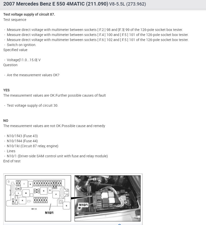

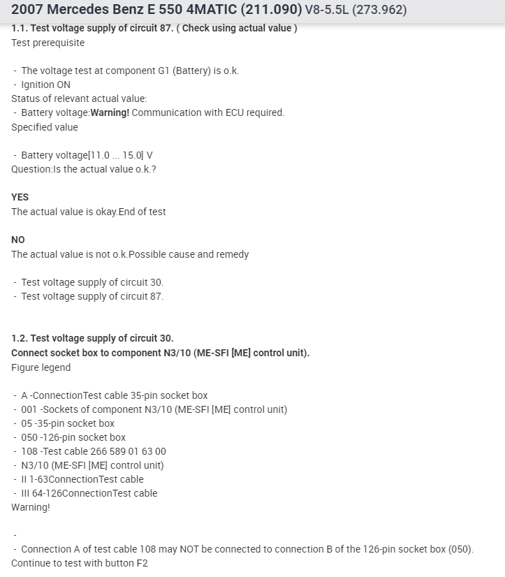

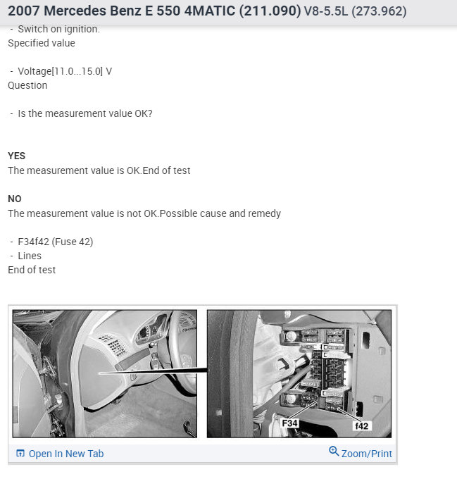

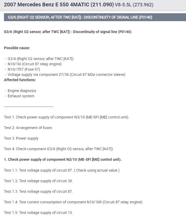

Which one of the oxygen sensors should I look at? I need to check the harness connector and maybe replace the sensor, so location would be appreciated. This is for the 2007 e550 not e500.
Mar 8, 2022 at 12:28 AM
SQM
  • 6,383 POSTS

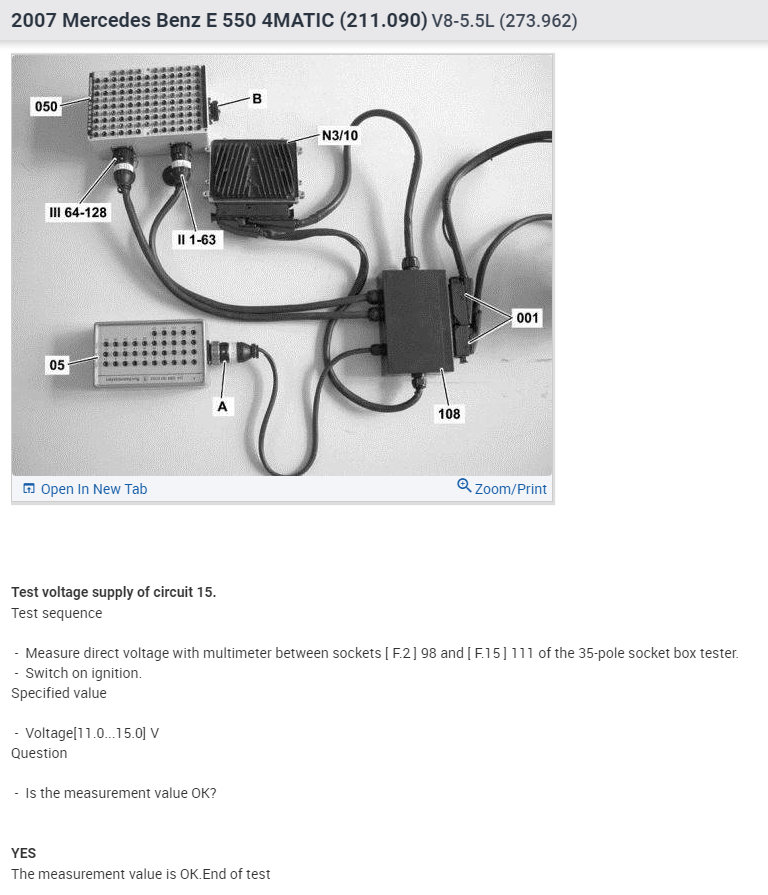

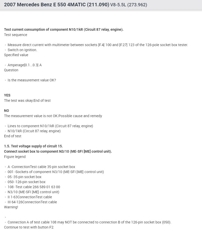

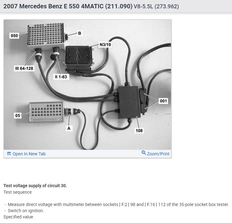

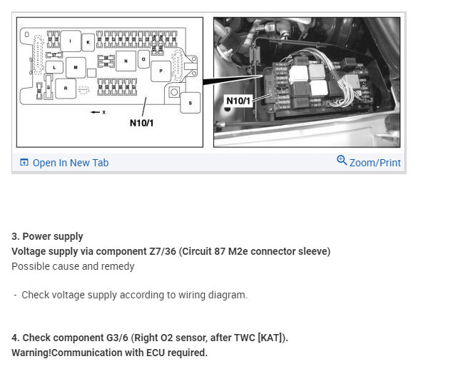

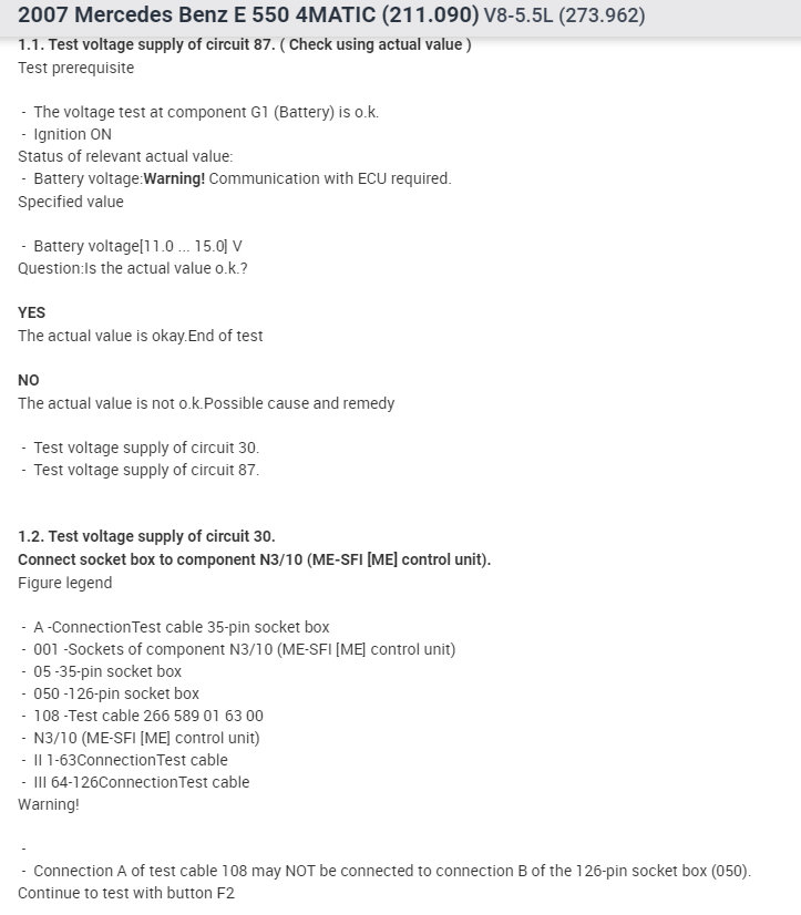

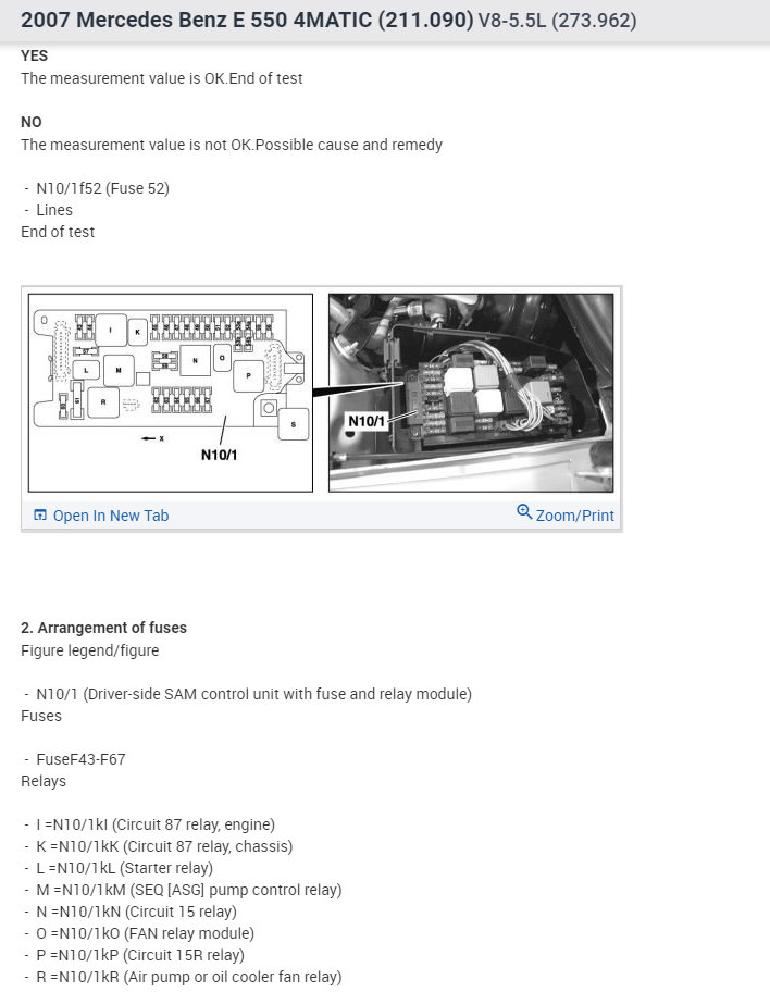

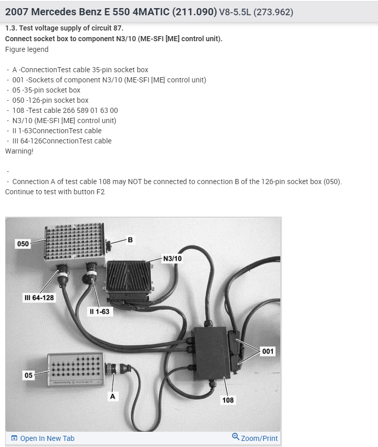

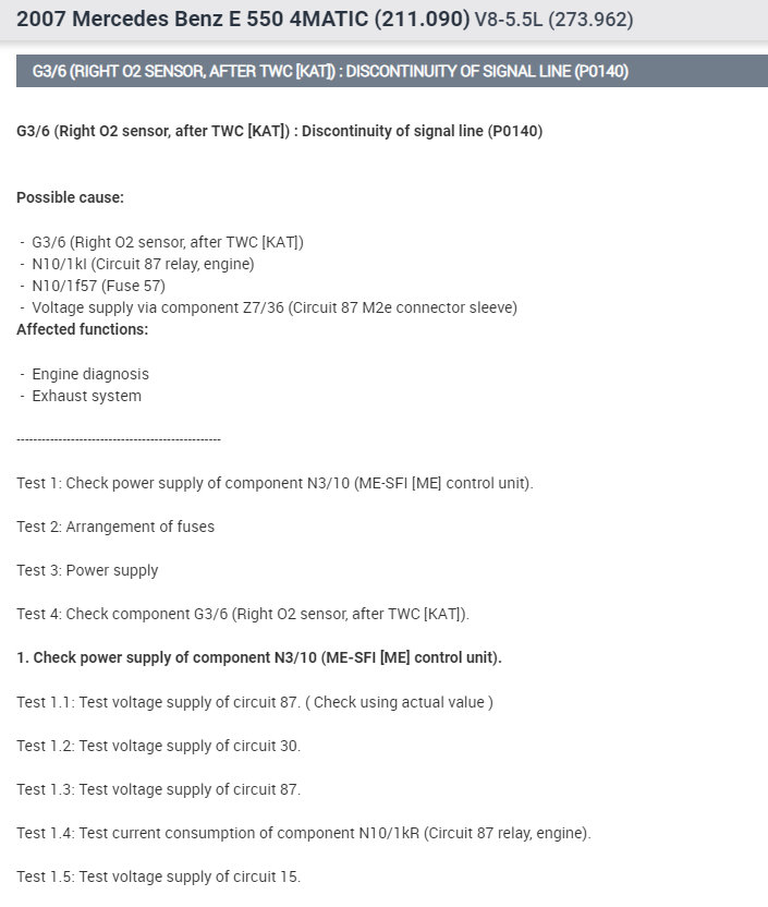

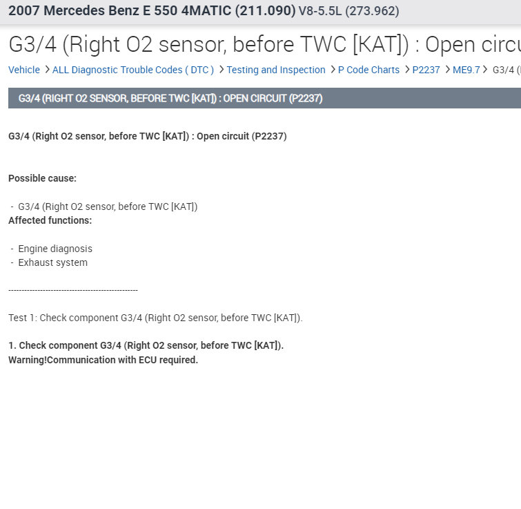

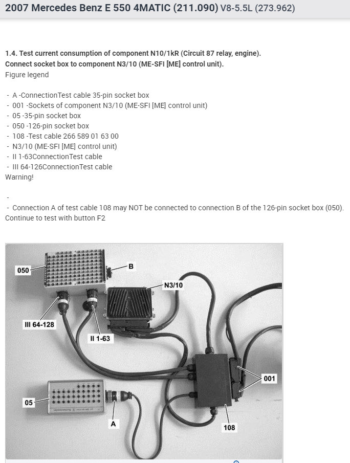

These codes are for the right-side oxygen sensor after the converter.
This code is typically generated due to wiring issues.
I have attached the diagnostics steps for code P0140 below. It shows the exact steps you will need to take to find the issue.
