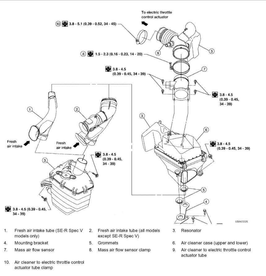

Check engine light on within two days after bank 1 sensor is replaced with off the market or dealer sensor. Bank 2 sensor also was changed. Fuel pump and sensor, also air were replaced. what is the problem?

This code means you have a lean condition which probably has nothing to do with the oxygen sensors. It sounds more like a vacuum leak or you have a misfire.
Please run down this guide and do some checking.
https://www.2carpros.com/articles/repair-lean-mixture-codes-p0171-or-p0174-on-some-manufacturers

I am not experiencing any misfiring. There are no exhaust leaks. Engine running smoothly. What would cause a lean condition?

This code can be caused by a dirty MAF sensor. I suggest you clean it free and then clear the codes here is a guide to help you see what to do.
https://www.2carpros.com/articles/mass-air-flow-service
It might be too far gone and you will need to replace it.
https://www.2carpros.com/articles/how-to-replace-a-mass-air-flow-sensor-maf
Please let us know what happens. No vacuum leak?

Mass air flow sensor has been replaced. i will clean as suggested. Thanks
