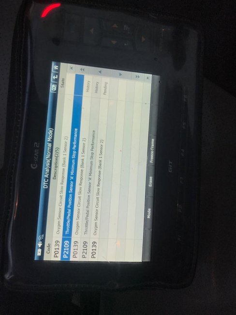

I have oxygen sensor engine light; I'm asking if i need to replace the same oxygen sensor. Or i can use any other oxygen sensor with any other number on it? Can someone guide me please?

Recently i changed an O2 sensor, the readings were also the same, but after driving it for a few miles, the engine light is back on. I’m really tense, what else can i do to fix this?
Feb 22, 2022 at 1:51 PM
Can I have the code that is set? That will help me narrow the area of failure.
Feb 22, 2022 at 1:53 PM
IFAM9877
This is the code:
Feb 23, 2022 at 5:24 AM
Okay, can I have the long-term trim for the sensor?
