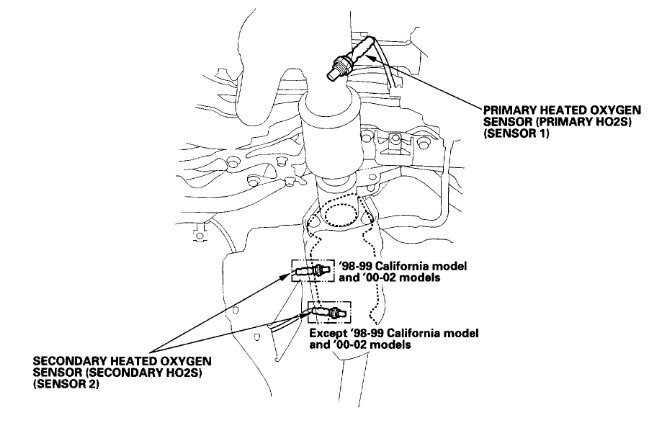

where is the bank 2, sensor 1 located?

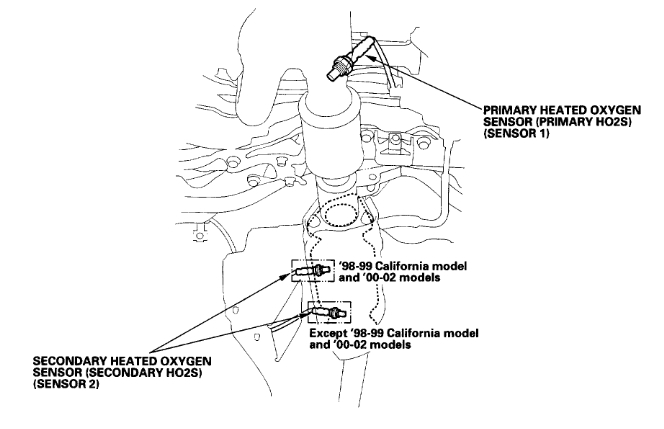

Bank 2 of the engine is closest to the radiator. It will be the first oxygen sensor in the exhaust system. Here is a guide to walk you through the step of changing it out correctly:
https://www.2carpros.com/articles/how-to-replace-an-oxygen-sensor
Check out the images (below). Let us know if you need anything else.
