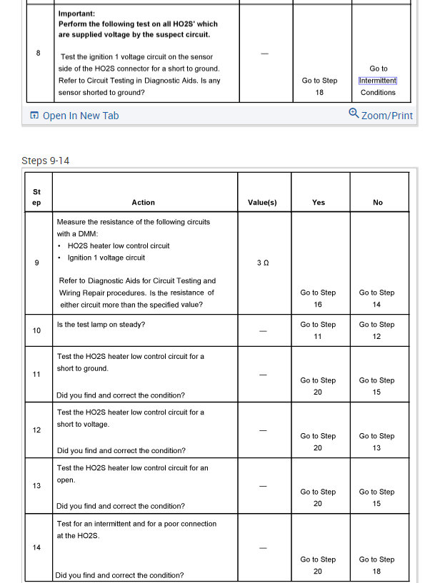

Scanner read out PO155 02 heater circuit (bank 2, sensor 1). can you let me know where that is located and is there only 1? 1 bad rest good?
Jul 2, 2021 at 5:31 AM
Hello again.
The sensor is on the passenger side of the motor just down from the exhaust manifold. It is before the cat converter.
https://www.2carpros.com/articles/how-an-oxygen-sensor-works
https://www.2carpros.com/articles/how-to-replace-an-oxygen-sensor

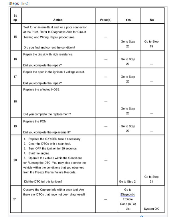

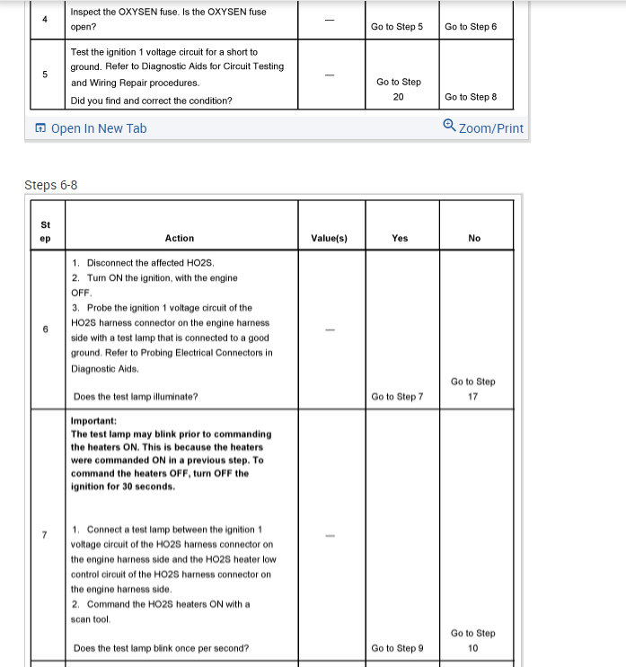

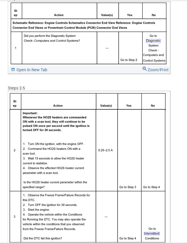

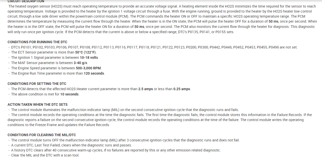

I attached the flow chart for the code. Most of the time, it is the sensor that is bad but you need to verify it by following the flow chart.
