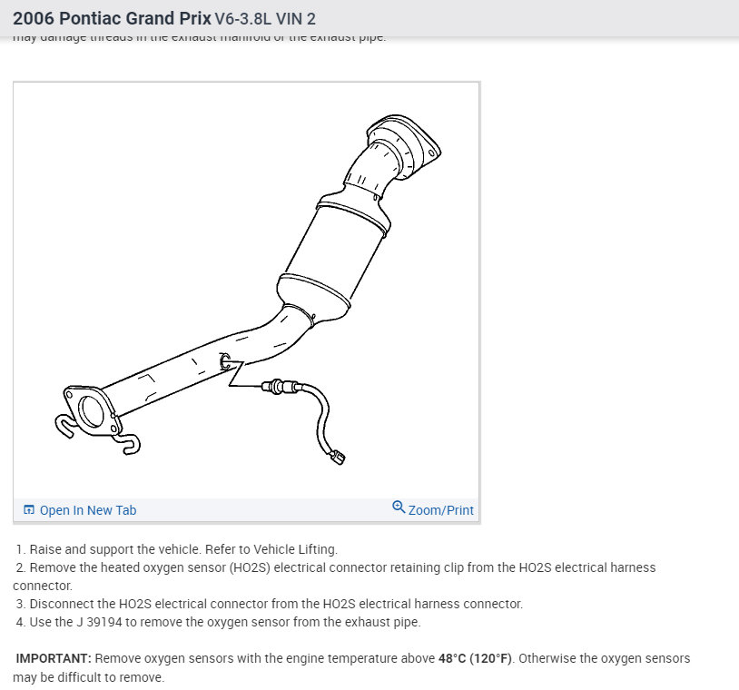

Where is bank 1 sensor 2 oxygen sensor location?
2006 PONTIAC GRAND PRIX
171,000 MILES • 3.8L • V6 • 2WD • AUTOMATIC
PINEAPPLEAK90
  • 6 POSTS
And what's the torque specification?

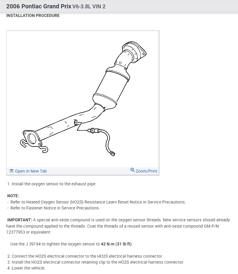

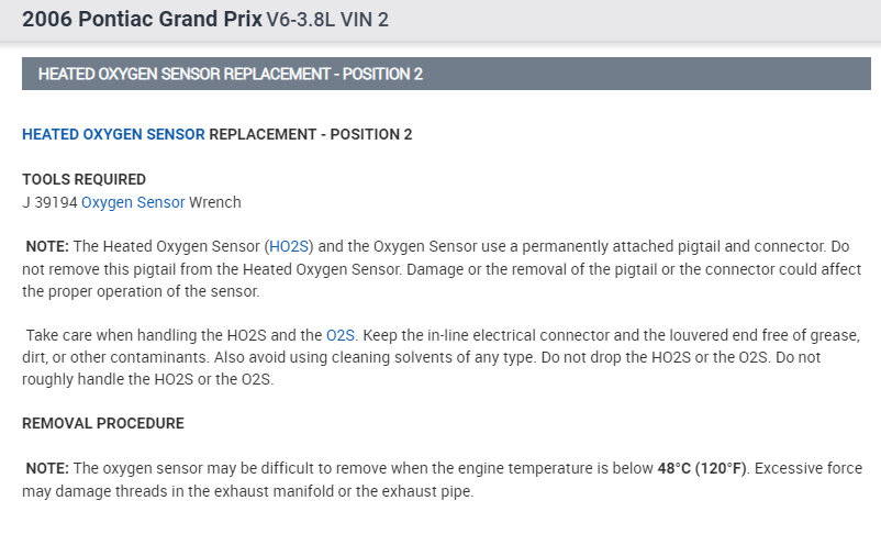

The sensor 2 is located after the catalytic converter on the exhaust pipe.
It should be torqued at 31 lb. ft.
Here is a helpful guide on oxygen sensor replacement:
https://www.2carpros.com/articles/how-to-replace-an-oxygen-sensor
I have attached diagrams below for your reference.
Let me know of any questions.
