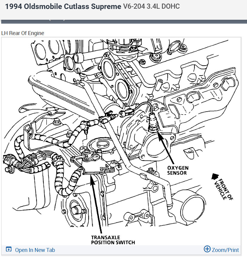

Can't find oxygen sensors?
Apr 30, 2025 at 6:05 AM
  • 55,423 POSTS
The oxygen sensor is at the rear of the engine on the right-side exhaust manifold closest to the firewall. This guide will help walk you through the replacement steps. Check the image below to see the sensor location.
