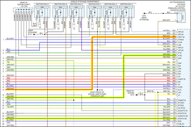

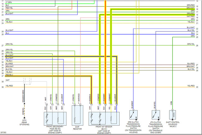

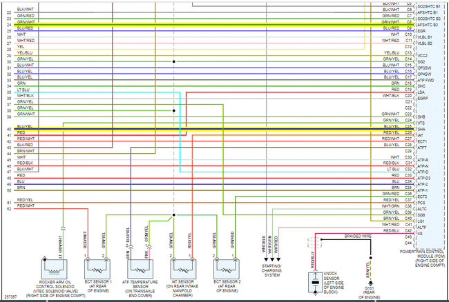

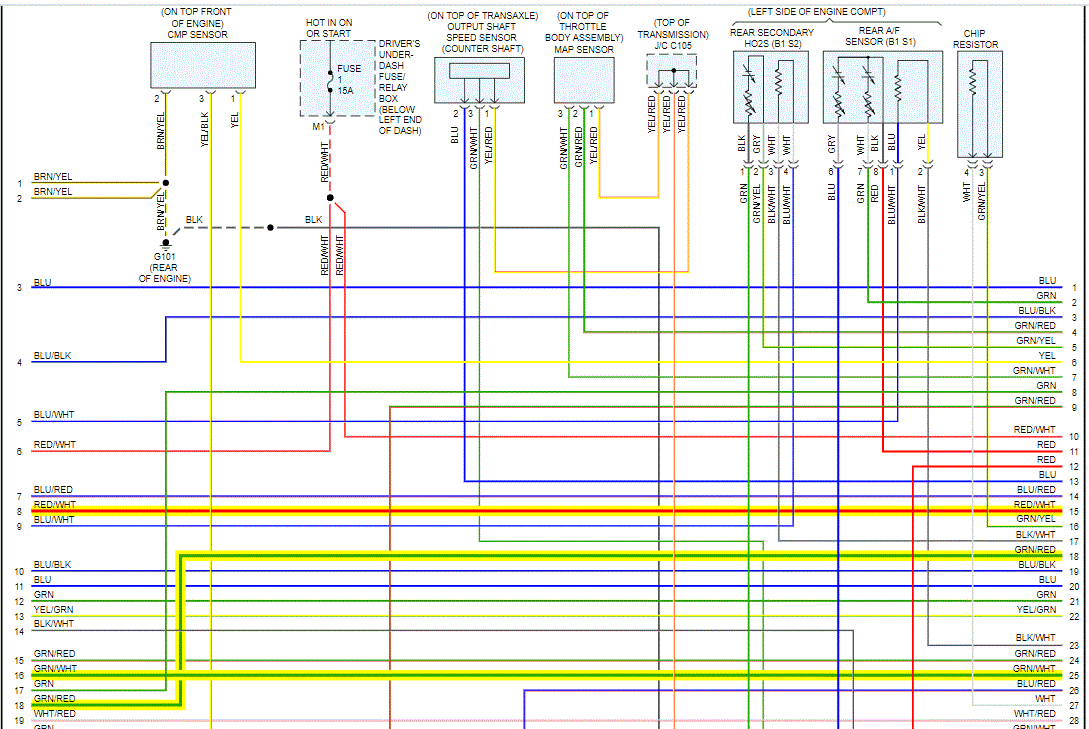

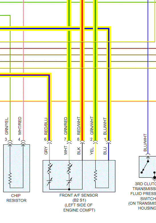

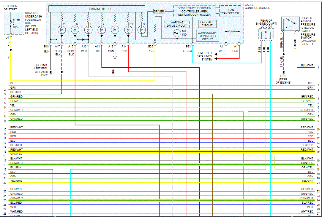

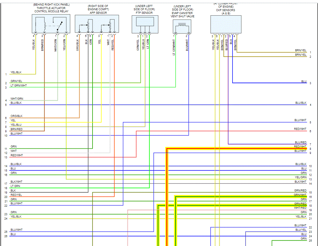

I have a 5 wire oxygen sensor, and just wanted to know what the colors represented. black, white, gray, yellow, and finally blue.
Mar 23, 2021 at 9:03 AM
  • 110,251 POSTS

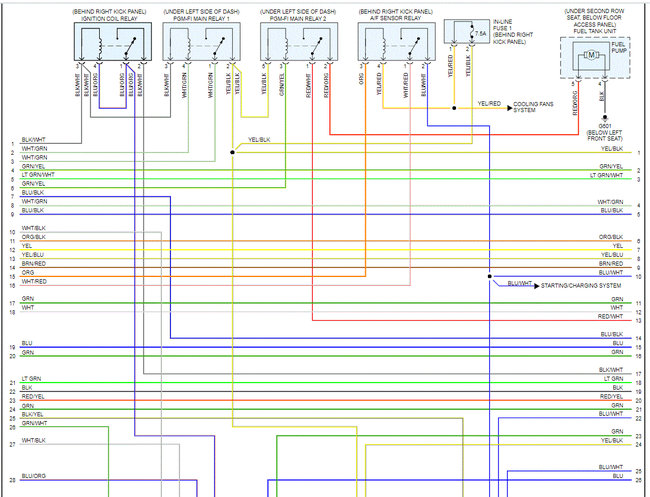

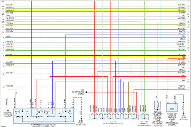

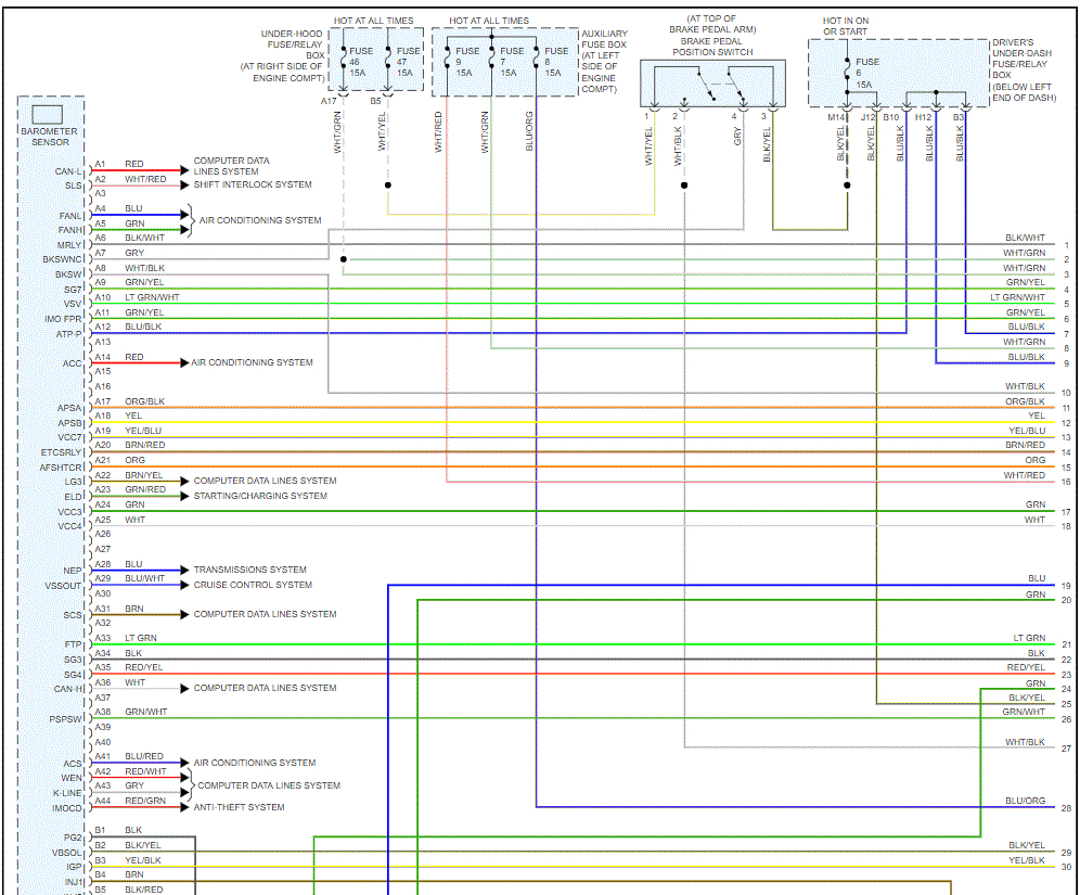

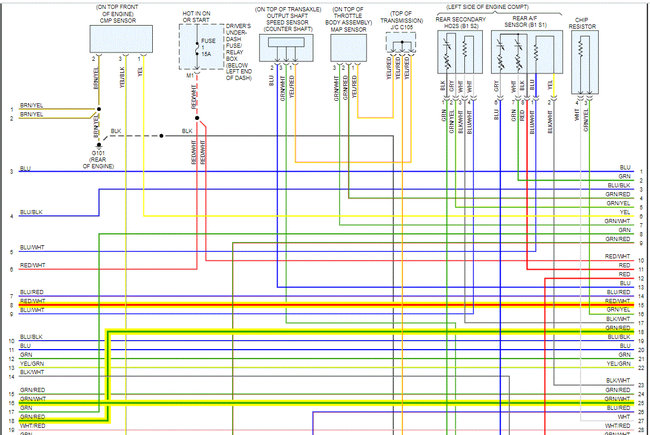

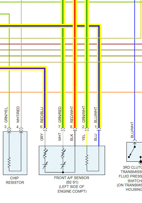

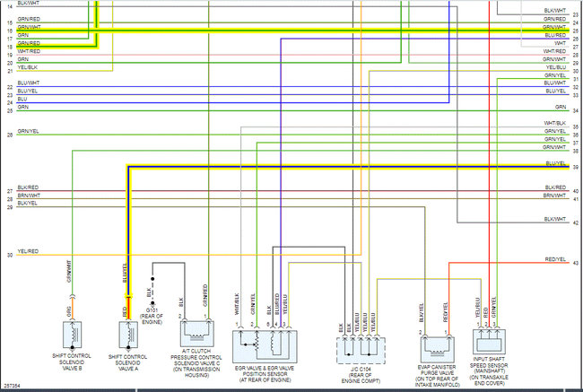

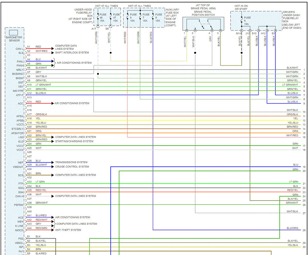

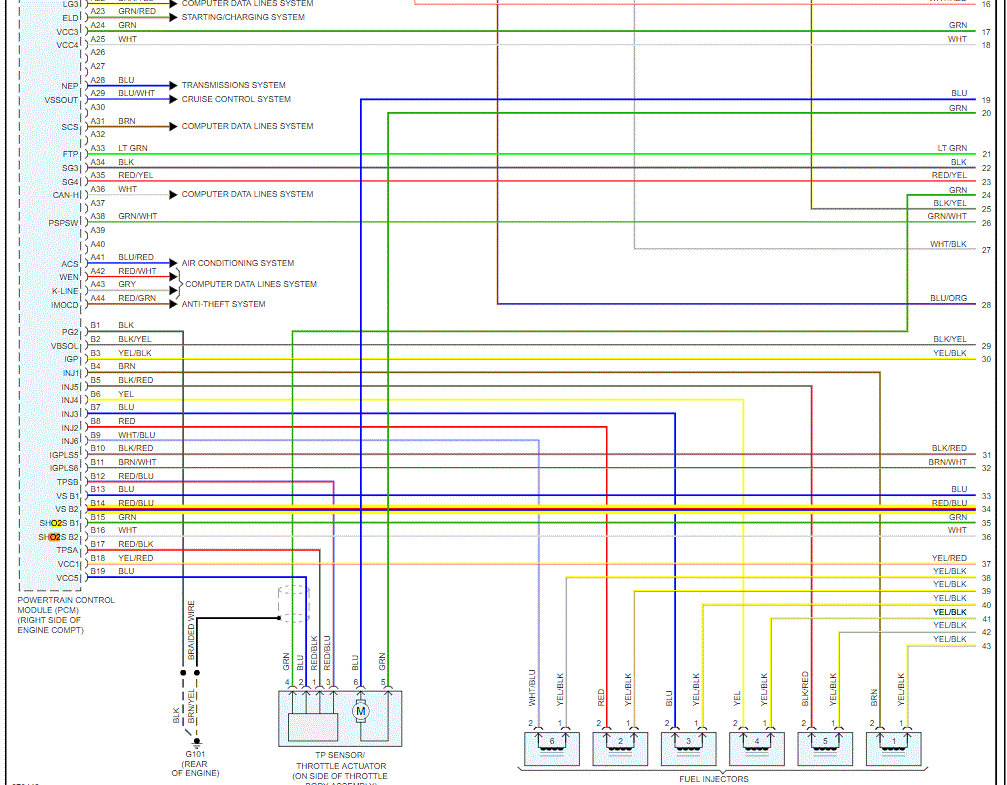

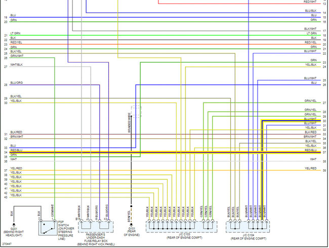

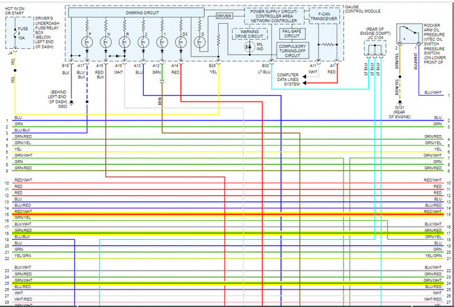

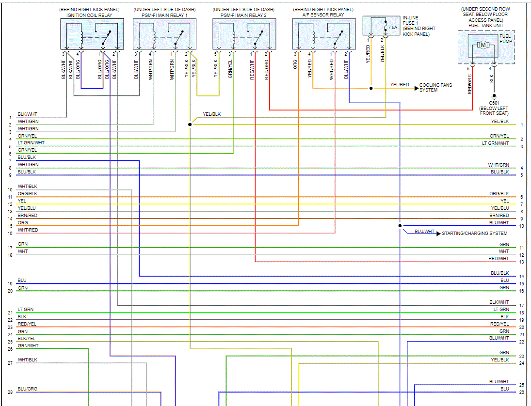

Each of the colors goes to a different place. First, if you look at pic 1 below, I highlighted the sensor matching the colors you indicated. Now, for me to show you where they go, I highlighted each wire and need to include the entire powertrain management wiring schematic. It is six pages long and I have to cut each pic in half to make them readable. If you follow each of the wires I highlighted, you will see the purpose of each one. Start at pic 2.
