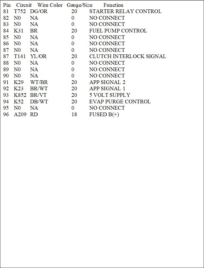

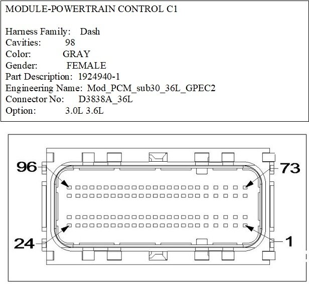

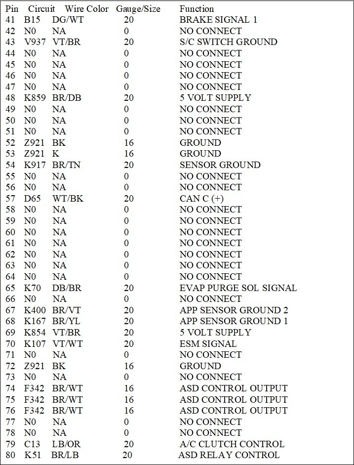

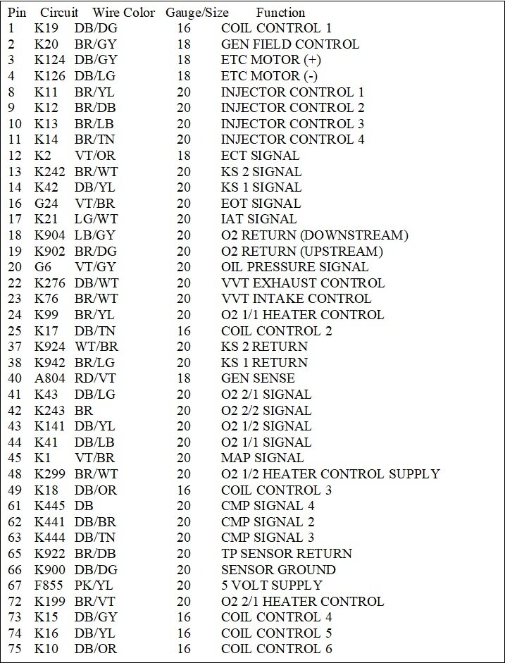

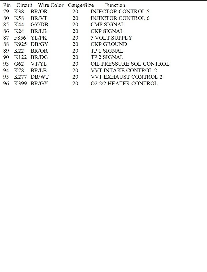

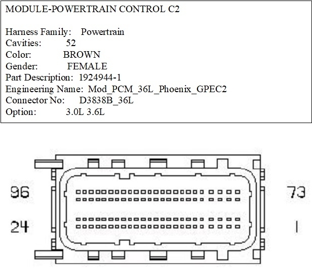

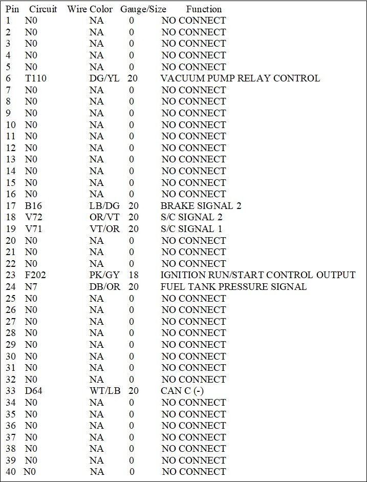

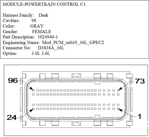

Measuring 14.5 to 15.3 at battery at idle. checked every ground and connector i can find. need pinout for PCM to test if PCM is the problem.

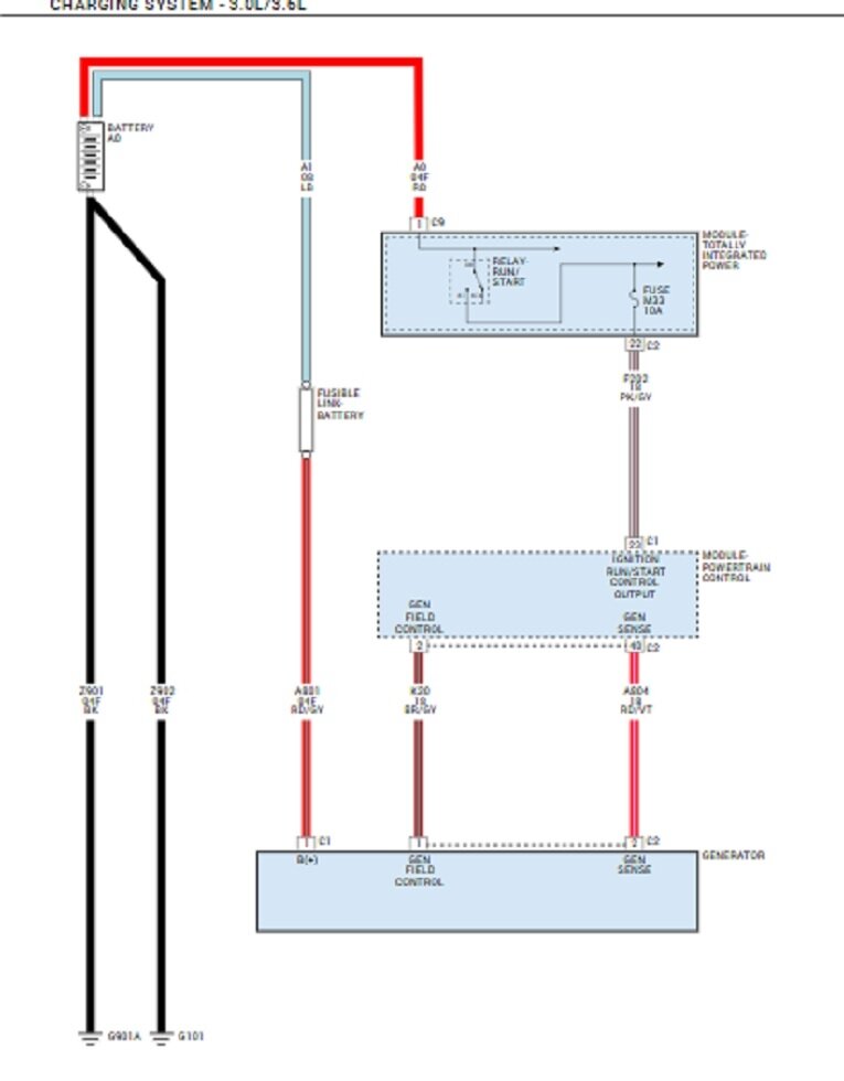

What kind of problem are you having? The charging voltage you listed is a little high, but not excessive. Normally we'd like to see between 13.75 to 14.75 volts. The voltage regulator lives in the Engine Computer, so besides temperature compensation that has been around forever, charging voltage can be modified for a number of other factors.
Here's the diagram for the charging system.

This is very helpful information, but there is a possibility that the charging circuit is working correctly but the PCM is not seeing the battery voltage as too low and therefore increasing the field pwm signal in an attempt to bring up the battery voltage. From what I've read this could be the result of a bad ground somewhere or a bad cable or wire causing an erroneous voltage reading by the PCM. So, to track that down, I need the power and ground pinouts for the PCM connectors also.

You're over-thinking this. The grounds are shared by multiple circuits, so there would be additional symptoms if one had high resistance. In the past, all Chrysler Engine Computers had four ground wires. One was called the "power" ground, meaning it was used for high power circuits like for injectors, ignition coils, and even relay and solenoid coils. The pulses of current being switched on and off would cause tiny pulses of "voltage drop" as would be the case in all such circuits. Those little voltages are meaningless to things like injectors and ignition coils.
The same is not true for sensor circuits. For them, especially the MAP sensor, a hundredth of a volt has a significant meaning to the computer. As such, those sensor circuits need their own ground circuit where they don't see those little voltage pulses. They go through the computer on their way to ground, so the computer can monitor them, but they can't share a power ground because the little voltage pulses would introduce error into the readings. The ground circuit for sensors is called the "signal" ground. You should find 0.00 volts on that one, but on the sensor side of the computer, expect to find 0.2 volts. That 0.2 volts is being dropped across the monitoring circuit inside the computer.
The power ground and the signal ground also always had a second, or back-up circuit in case something did happen. That's why there were four ground wires.

To address your question about how the computer knows there's a problem, all electronic voltage regulators run the alternator's field circuit through "pulse-width modulation", (PWM). They do the same thing in VCR power supplies. A very large current can be controlled with a very tiny switching transistor. If you understand Ohm's Law, this will make sense. That's a set of 12 electrical formulas. One of them is "Power equals volts times amps. Power is also what generates heat, the deadly enemy of transistors. In a switching power supply, (PWM), current is switched totally on for a set period of time. For alternator field coils, that's roughly three amps. Next, current is switched completely off. That cycle occurs 400 times per second. When current is switched off, there's 0 amps through the switching transistor, and roughly 14 volts across it. 0 times anything is 0 watts, and no heat.
When current through the field coil is switched on, there's about three amps of current flowing through the switching transistor, but very close to 0 volts across it. 0 volts times any current equals 0 watts, and again, no heat. The point of this sad story is that "on-time" to "off-time" ratio is very easy to vary as demands on the electrical system change. That's called the "duty cycle". As a point of interest, injectors work the same way to vary how long they spray fuel. The computer watches that duty cycle and it watches how much average current is flowing out that circuit to the field coil. More current means a stronger electromagnetic field is generated in the field coil.
I might as well stop for a second and explain that to generate a current mechanically, you need three things. You need a piece of wire, a magnet, and most importantly, movement between them. The wire is more efficient as a bunch of stationary coils around the outside of the alternator. We use an electromagnet for the magnetic field because it is very easy to adjust its strength, and the movement is why we spin them with a belt and pulley.
Alternators by their nature are self-regulating and will not develop more current than they're designed for. The only time they develop full output is during the brief test we can do on them. At all other times, they develop only exactly as much as the electrical system needs, and no more. If too much current is developed, system voltage will start to rise. The regulator decreases the duty cycle to bring system voltage back down. It's that duty cycle the computer monitors to know when there's a charging system problem. When the circuit is switched on, but no current flows out of the regulator, the computer will detect that and set the fault code, "alternator field not switching properly". It can also detect when the regulator has lost control and system voltage goes too high. I've never seen that happen except when forcing the situation for students to diagnose.
What this boils down to is the computer will let you know when it's not happy with system voltage. To verify that, you can see it on the live data screen on a scanner. It's listed as "target voltage", and 15.3 volts is well within normal limits. It will also show the percent duty cycle for the field circuit. I don't pay much attention to that, but typically you can expect to see from 25 to maybe 50 percent. The computer does most of the testing for us, so if there's no fault code, I don't think you have a problem.
