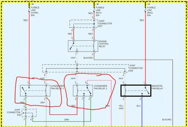

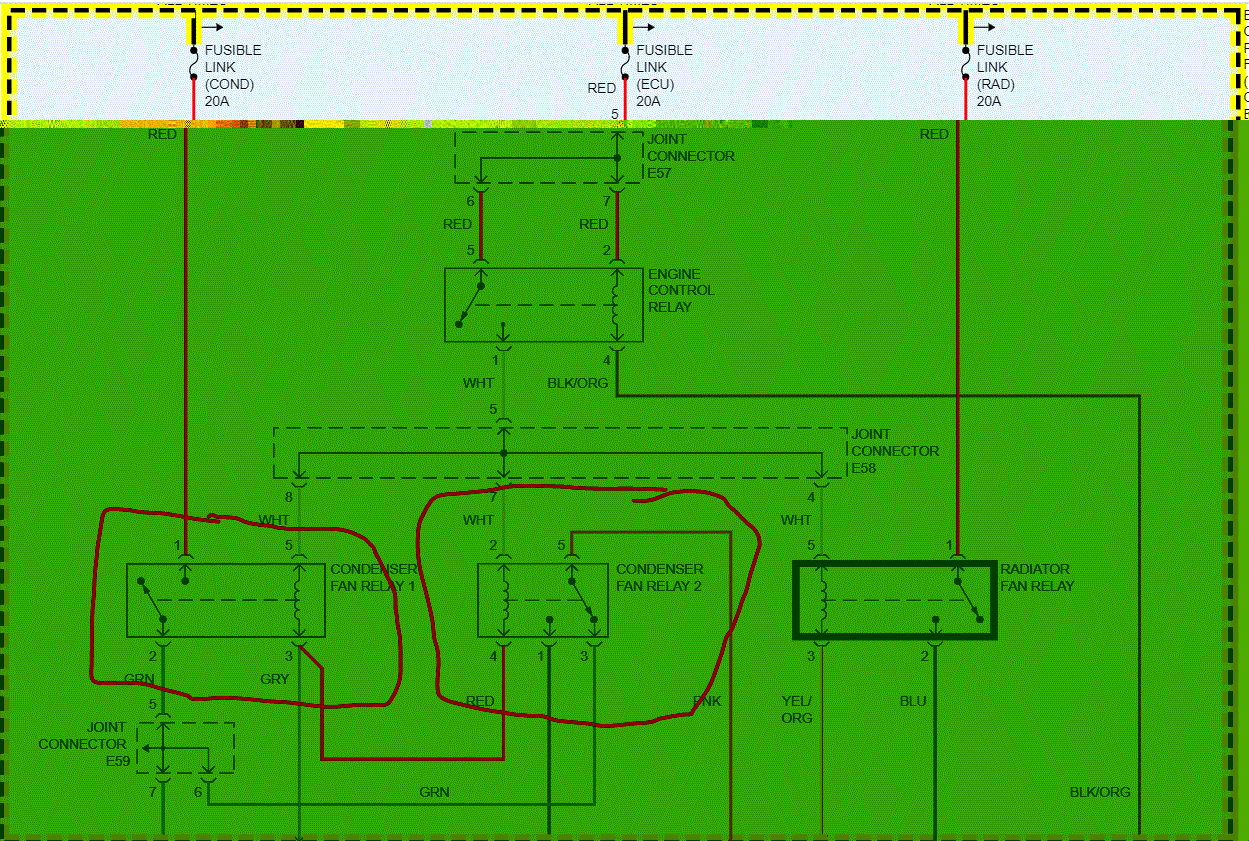

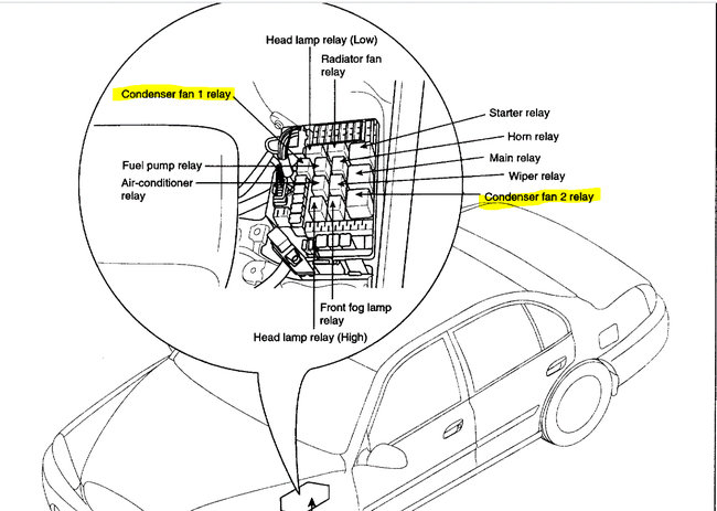

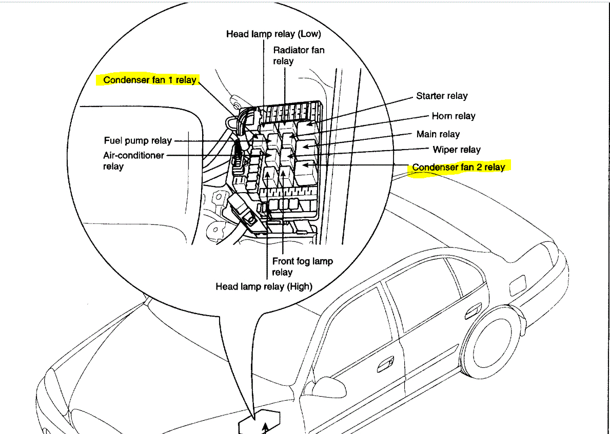

Do you hear the radiator cooling fan turn on when you turn on the A/C? When the engine gets hot, do you hear the fans? Does it only overheat if you are in stop and go traffic or does it happen at highway speeds as well? Has it ever overheated in the past with the A/C turned off?
If the fans are not turning on with the A/C, it could be a couple issues, a fan motor, a condenser fan relay, or a power issue.
IF that is the case (no fan at all), check the condenser fan relays in the under hood fuse box. You can simply switch them with a different relay having the same part number or here is a link which explains how to test one.
I attached two pics below. The first simply is a portion of the wiring schematic for the fans, relays, and fusible links. A fusible link functions like a fuse, but looks like a regular wire. We ill cross that road if they need checked.
The second pic is of the under hood fuse box. I highlighted the two relays that need checked. Do this and let me know if the fan starts working.

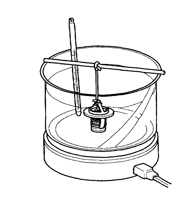

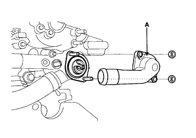

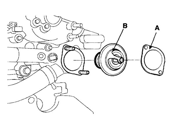

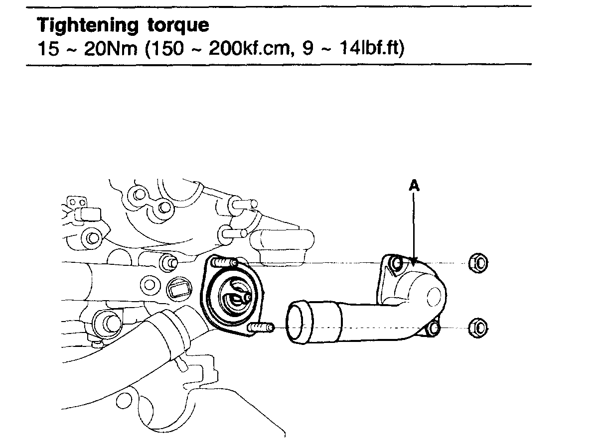

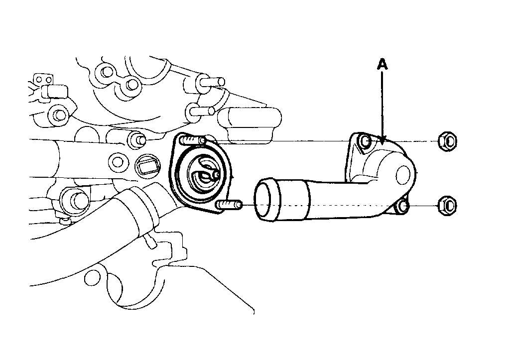

Here are the directions specific to your vehicle for thermostat replacement. The attached pics correlate with the directions.
____________________________________
2004 Hyundai Elantra L4-2.0L
Procedures
Vehicle Engine, Cooling and Exhaust Cooling System Thermostat Service and Repair Procedures
PROCEDURES
THERMOSTAT
REMOVAL
NOTE: Removal of the thermostat would have an adverse effect, causing a lowering of cooling efficiency. Do not remove the thermostat, even if the engine tends to overheat.
1. Drain engine coolant so its level is below thermostat.
pic 1
2. Remove water inlet (A), gasket and thermostat.

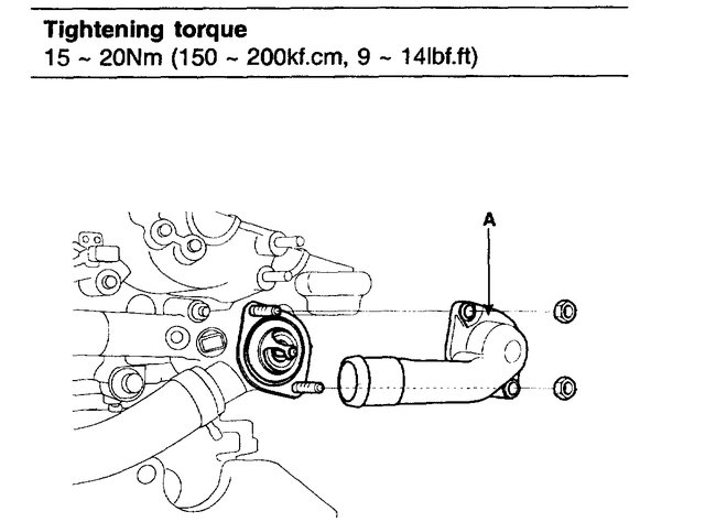

INSPECTION
pic 2
1. Immerse the thermostat in water and gradually heat the water.
2. Check the valve opening temperature.
Valve opening temperature: 82°C (177°F)
Full opening temperature: 95°C (205°F)
If the valve opening temperature is not as specified, replace the thermostat.
3. Check the valve lift.
Valve lift: 8 mm (0.3 inch) or more at 95°C (205°F)
If the valve lift is not as specified, replace the thermostat.

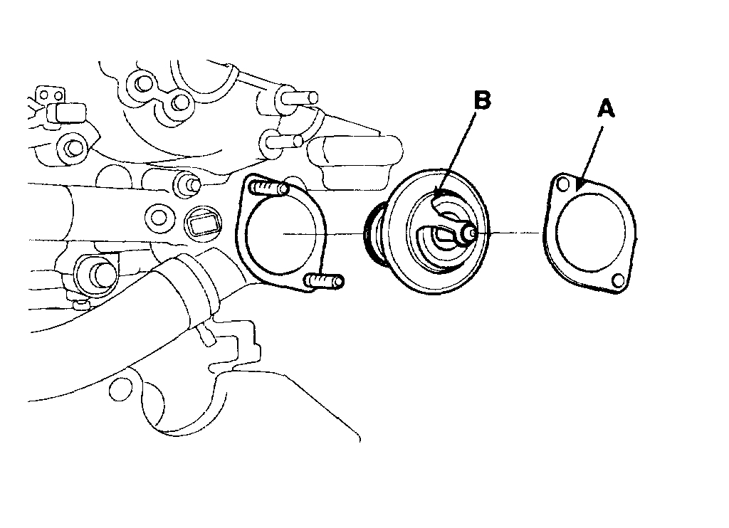

INSTALLATION
1. Place thermostat in thermostat housing.
1. Install the thermostat with the jiggle valve up ward.
pic 3
2. Install a new gasket (A) to the thermostat (B).
pic 4
2. Install water inlet (A).
3. Fill with engine coolant.
4. Start engine and check for leaks.
