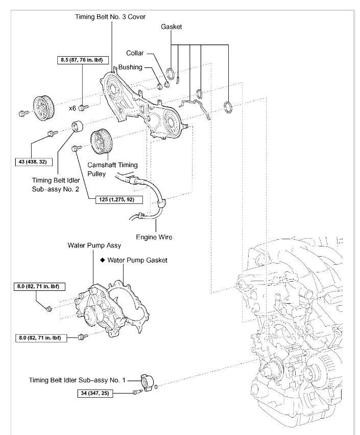

Overheats only when idling
190,000 MILES • 3.3L • 6 CYL • 4WD • AUTOMATIC
RUBEN541X13
  • 24 POSTS
If I rev it up or drive it around it won't overheat. I checked both radiator hoses and they're both cold enough to hold and fans do come on.

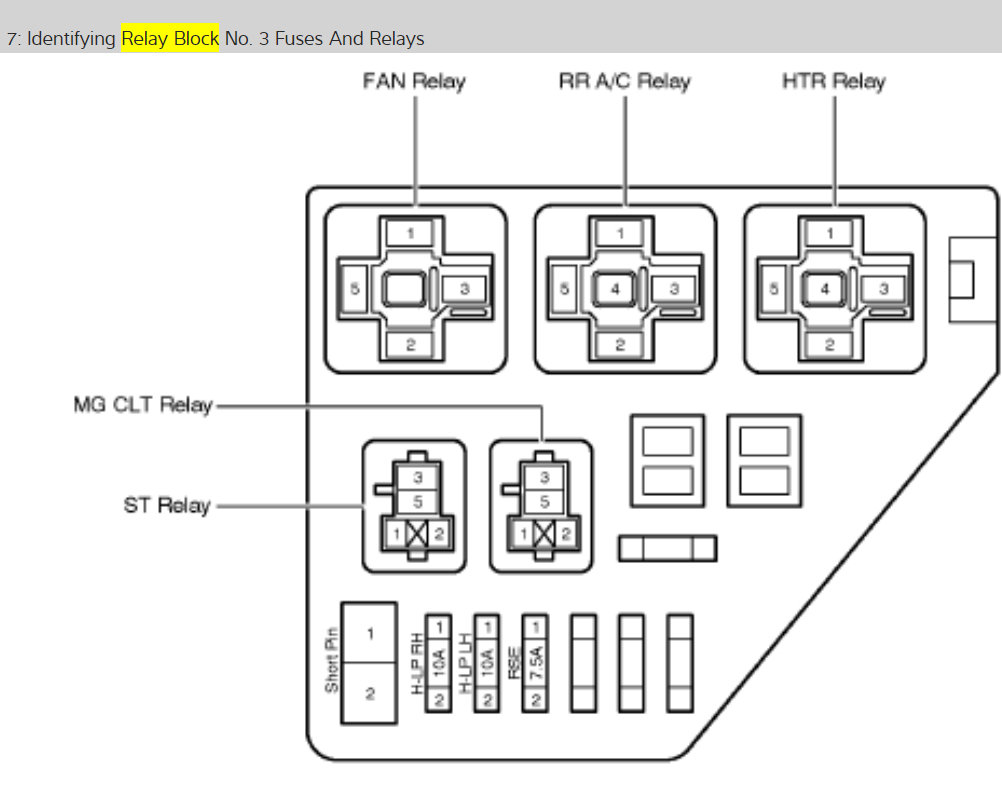

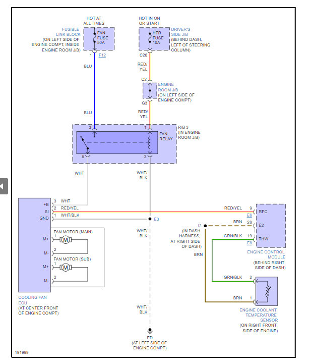

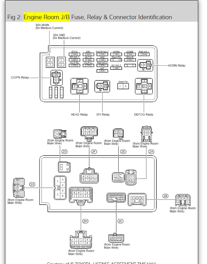

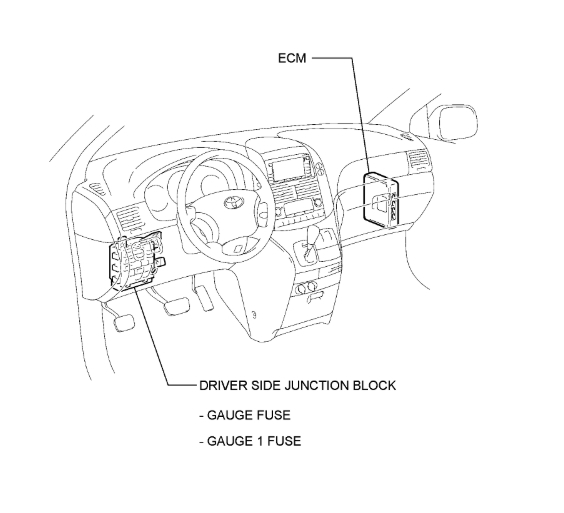

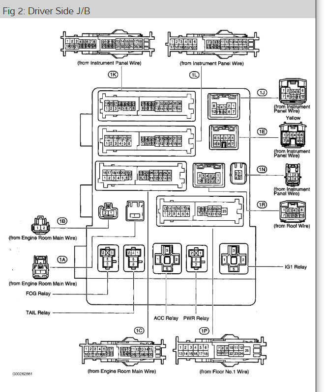

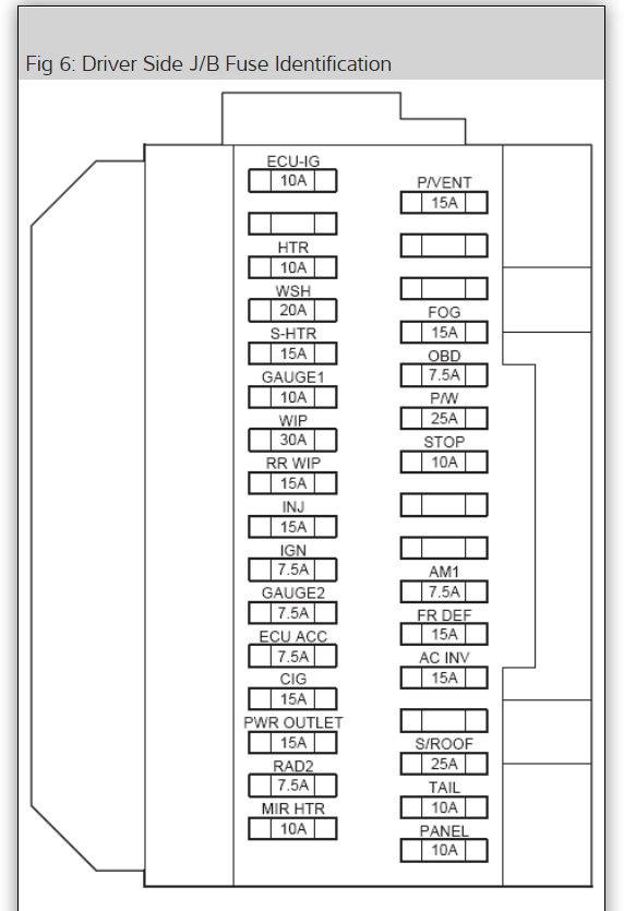

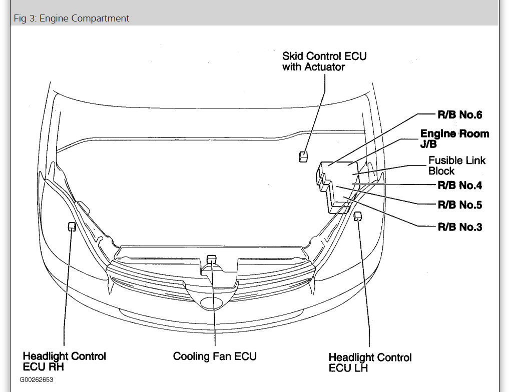

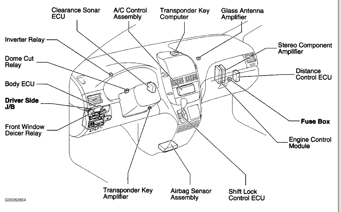

I would check the fuses for the cooling fans, here is a guide to help and the fuse locations in the diagrams below:
I have also included the wiring diagrams for the cooling fans so you can see how the system works and which fuses to test. Check out the diagrams (below). Let us know what happens and please upload pictures or videos of the problem.
Jun 20, 2022 at 5:04 AM

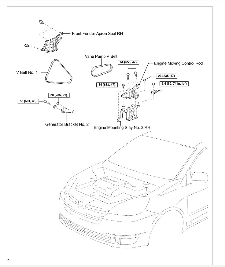

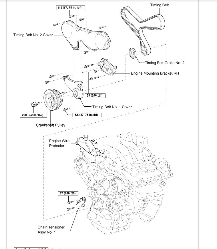

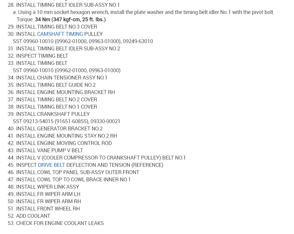

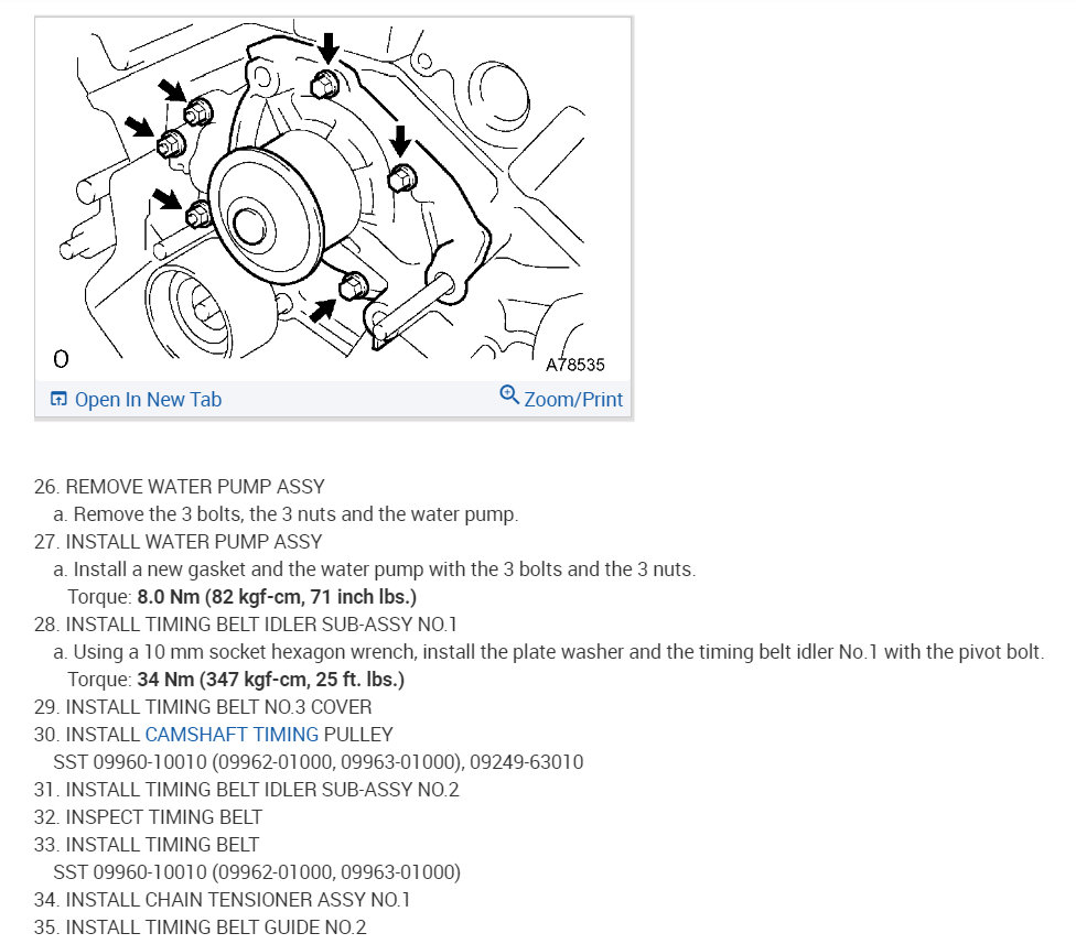

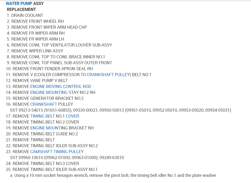

Does the engine boil over at idle? I have seen where the water pump impeller becomes loose or is broken which doesn't allow the coolant to flow when idling. To be sure the water pump needs to be removed here are the instructions to do so in the diagrams below. Check out the diagrams (below). Please let us know what happens.
Jun 21, 2022 at 2:10 AM
