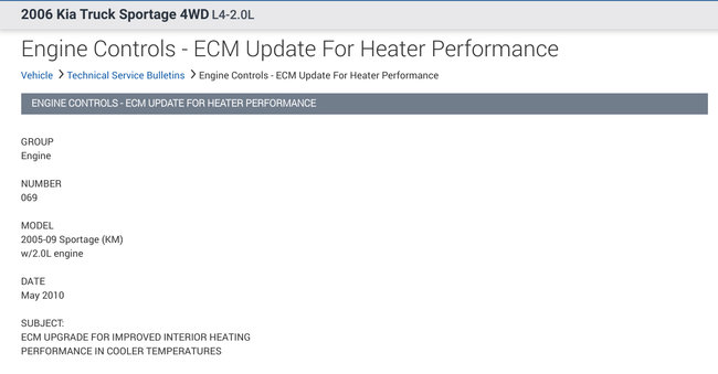

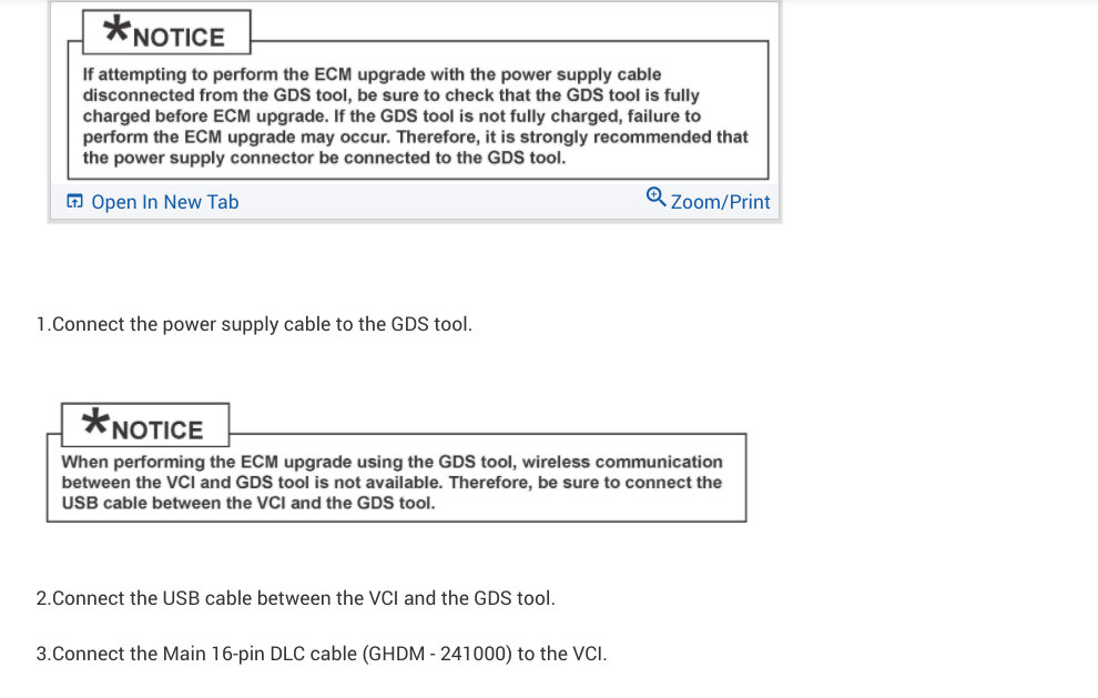

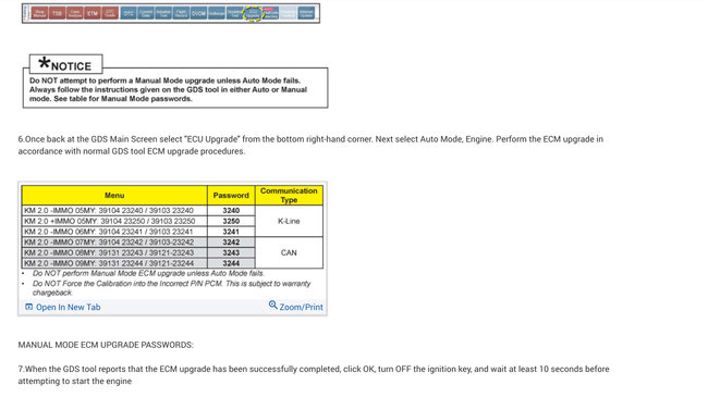

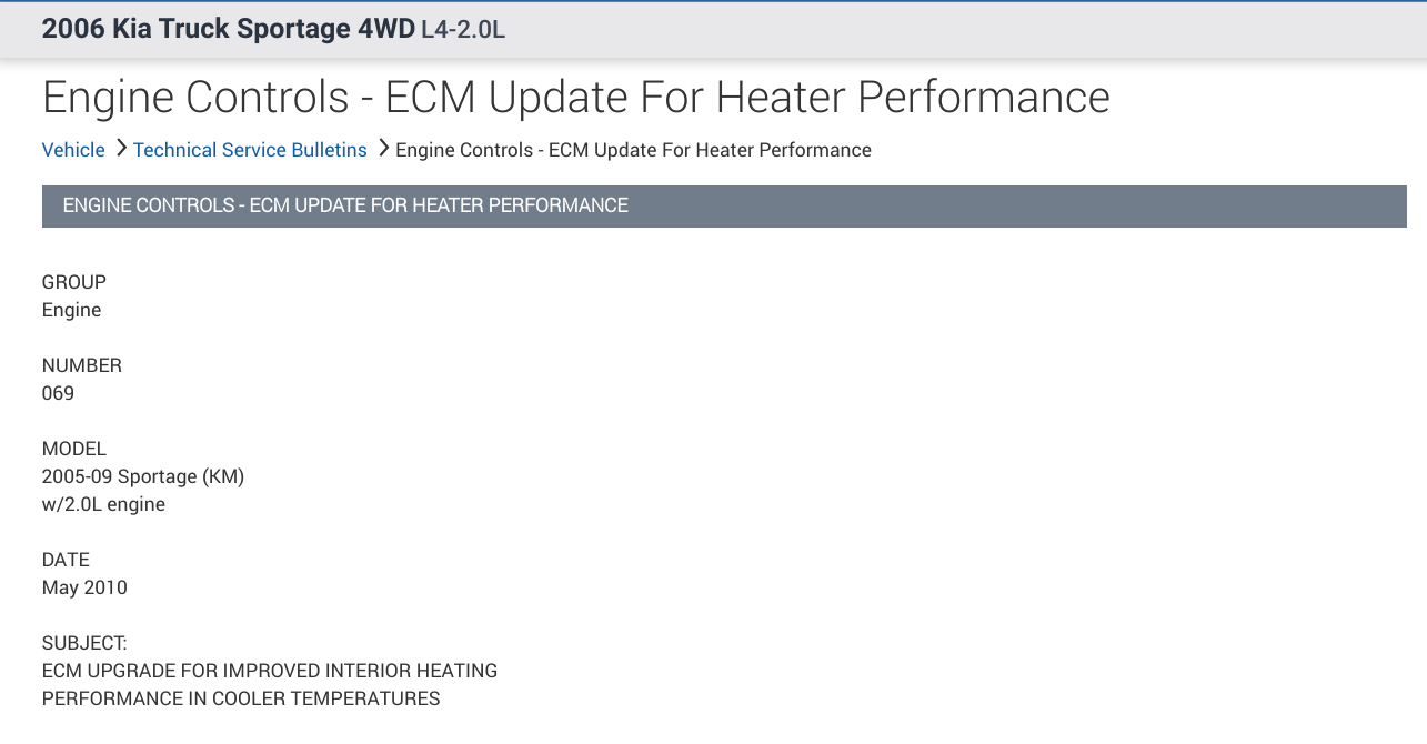

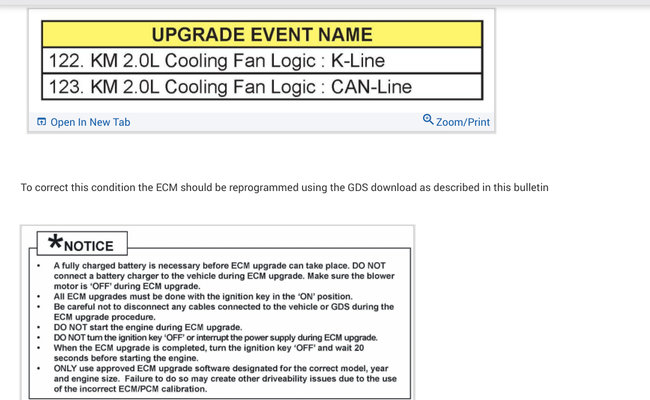

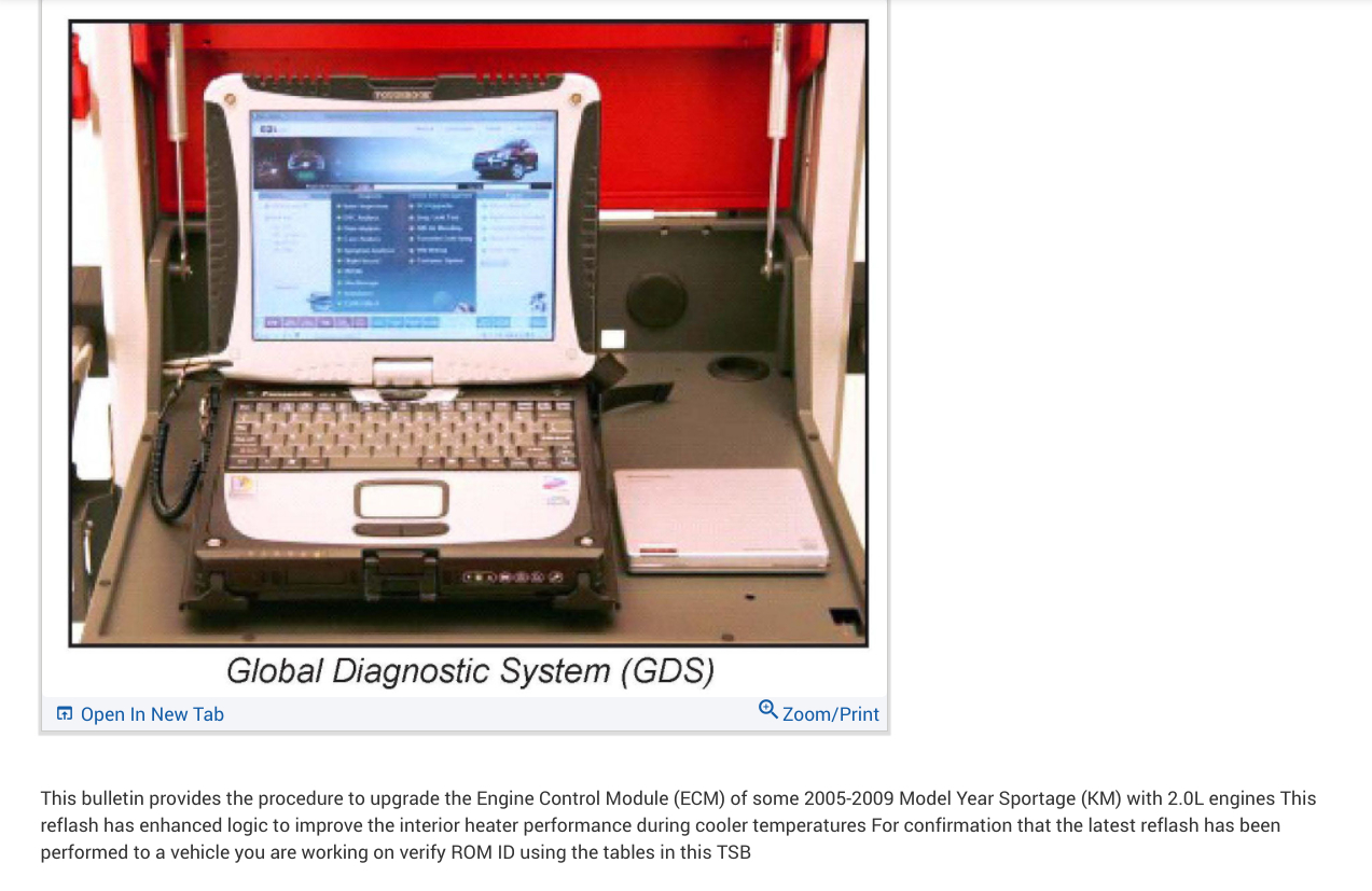

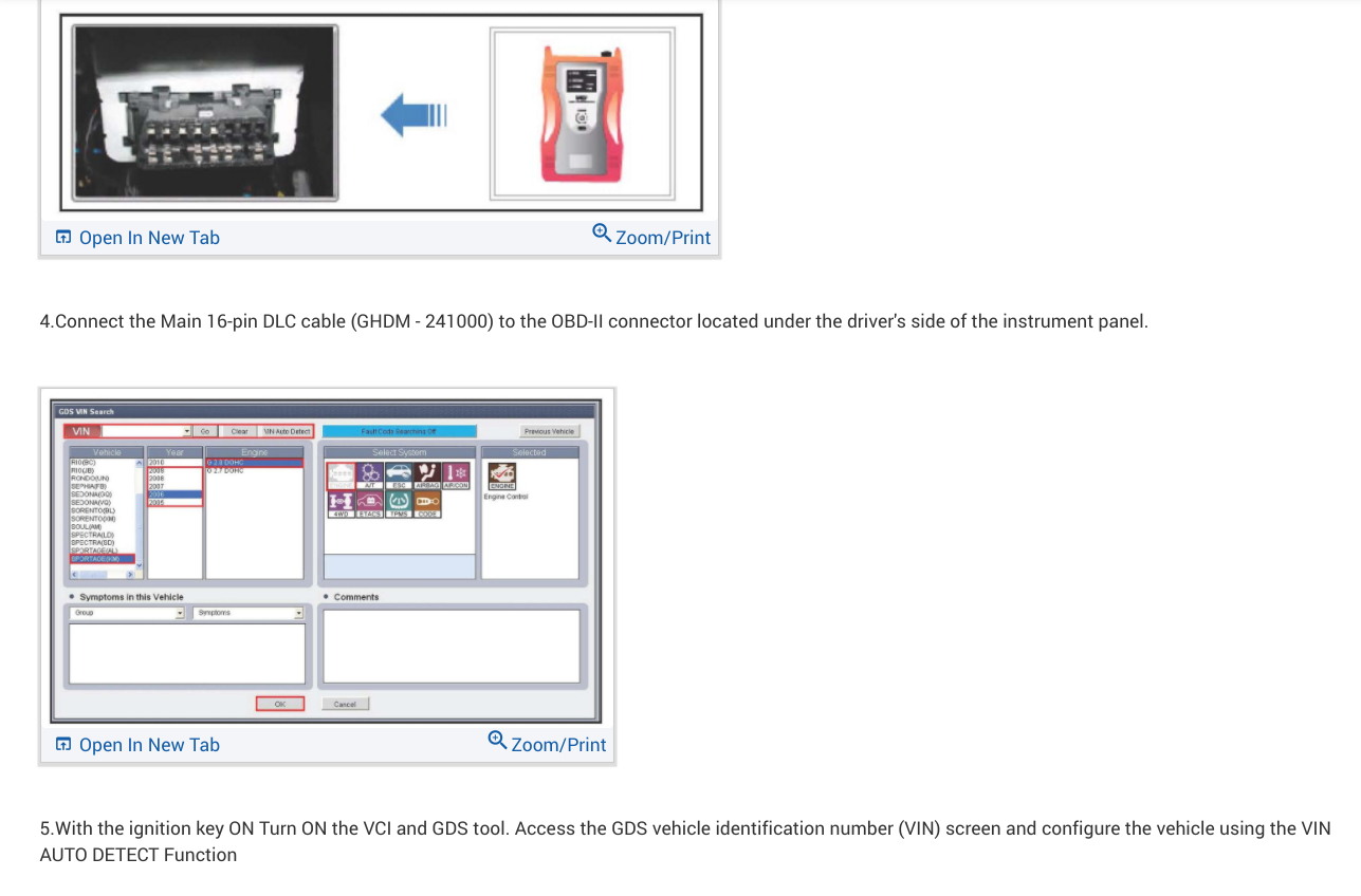

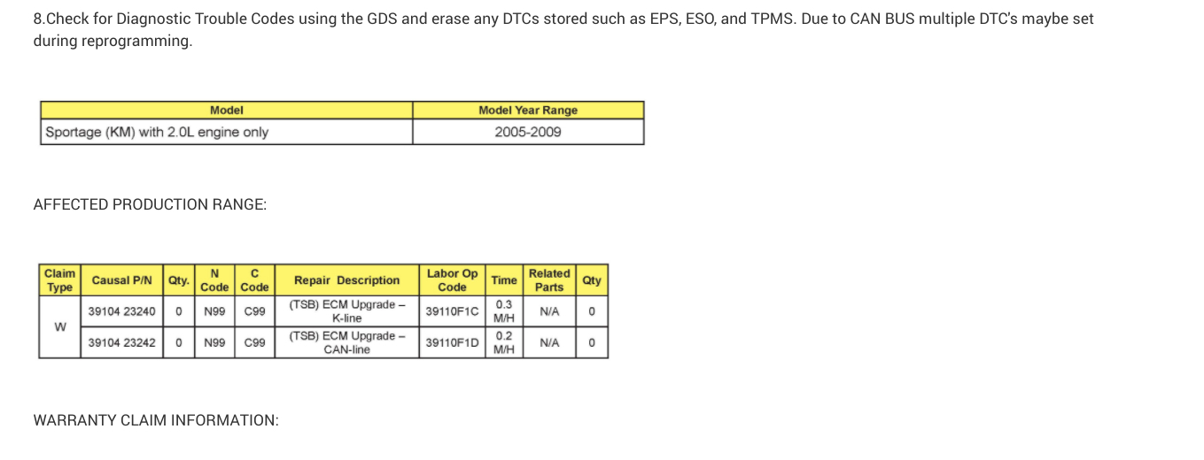

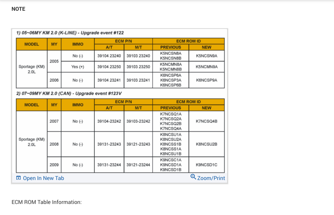

As I was researching your vehicle's problem a came across this. It is a Technical Service Bulliten [TSB] for your vehicle for a re-flash of your vehicle's Engine Control Unit [ECU] for heater performance in cold weather. I have included for you in the diagrams down below. I would recommend calling your local dealership and talking to the service manager. You should be able to get this fixed under warranty. I hope this helps, and let us know how everything is progressing, please.

SCGRANTURISMO
  • 4,897 POSTS
Yes. If it is covered under this Technical Service Bulletin, they should cover this at no charge. You will need to contact your local dealership's service manager and discuss it with him. Please keep us informed.
