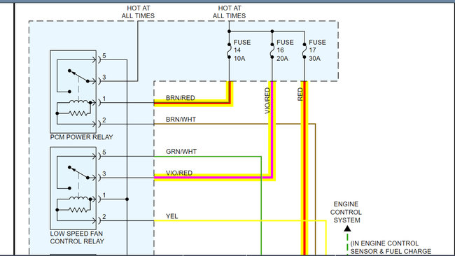

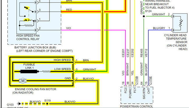

Good afternoon,
I attached a diagram for you for the fans. I would check the fuses listed for power on both sides.

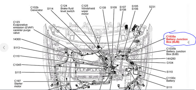

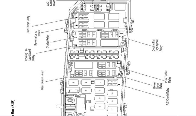

I also attached the location of the relays for you. They are in the underhood fuse block.
You will need to do some voltage checks to determine the failure.
Let me know the results so we can continue with the testing.

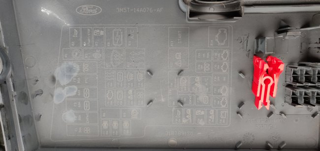

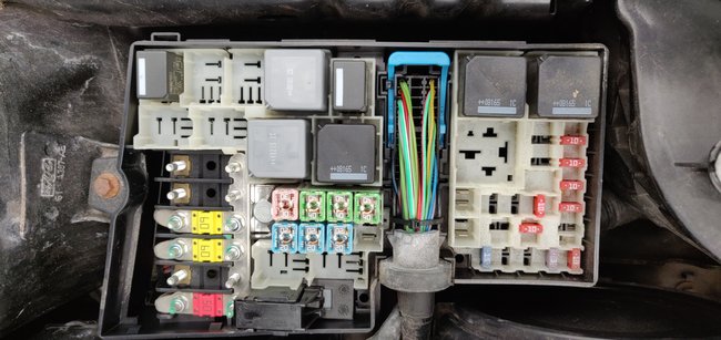

Before we go any further I've attached pictures of my junction box which looks quite different to the ones linked above.
Thanks for your help. :)
