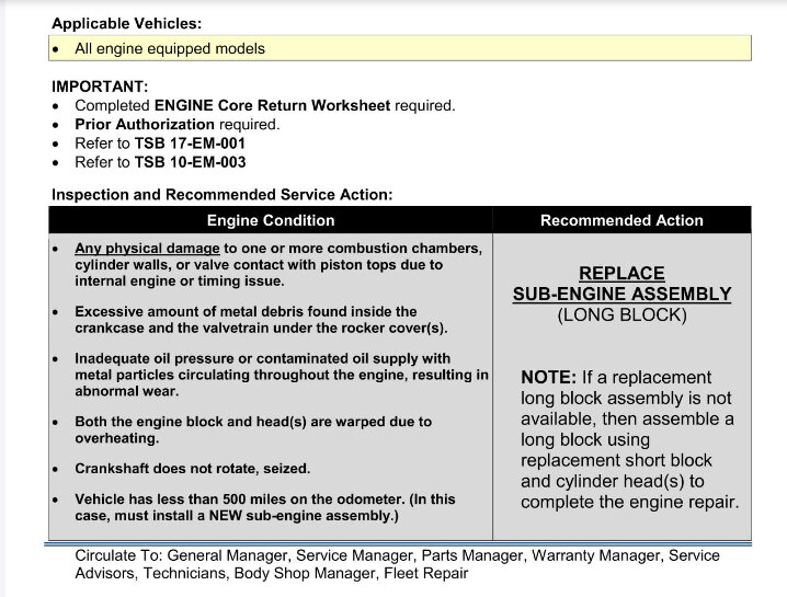

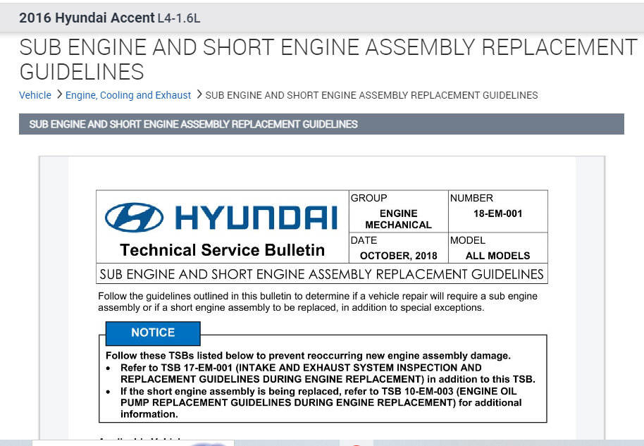

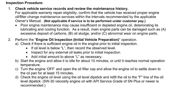

Will it overheat if you continue driving it at highway speeds for an extended period of time? Also, just FYI, there have been engine issues related to the cylinder heads and the engine block. To the best of my knowledge, Kia is replacing the engine for a few different reasons. For example, does the engine use excessive oil? Are there any odd sounds from the engine that may indicate a cylinder head leak or an engine bearing issue?
Do me a favor. Take a look at the technical service bulletin below and let me know your thoughts. If there are some of these issues, overheating can be a symptom.

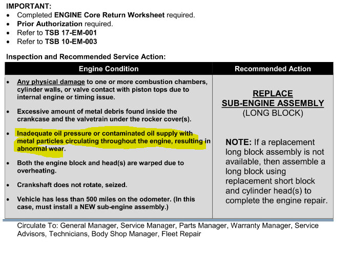

I appreciate the information. We changed her oil just over 2 months ago, the oil level is low, we changed it the last week of July. I am not sure what an acceptable amount of oil loss is, but it is definitely low. Oil pressure light hasn't come on, but could the low oil level be what is causing it to overheat when idling after driving for a bit? It is right at the low mark on the dip stick.

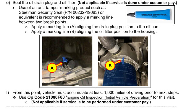

4

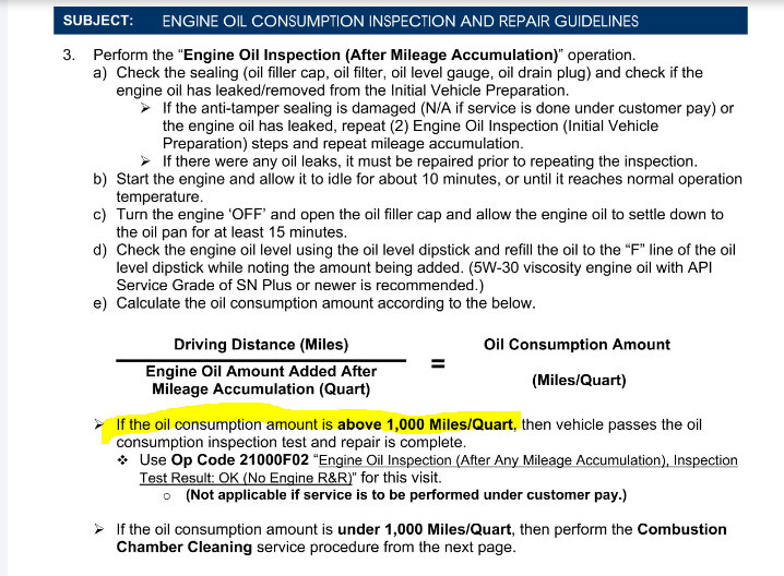

If the oil level is at the add mark, that indicates it is a quart low. How many miles have been put on it since the oil change? If it is less than 1000 miles, then we have an issue.
Let me know. Also, I attached information below relevant to the test.

A little over 2,200 miles since the oil change.
Thank you for the info, I will follow those instructions and get the oil topped off, then check levels after 1,000 miles.
If her car overheats before the 1,000 miles, do you suspect it's the cylinder heads or the engine block causing the issue?

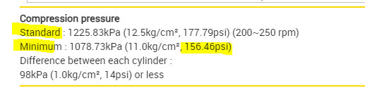

Compression test complete:
Cylinder 1 - 150 psi
Cylinder 2 - was between 155-160 psi
Cylinder 3 - 150 psi
Cylinder 4 - was closer to 160 psi

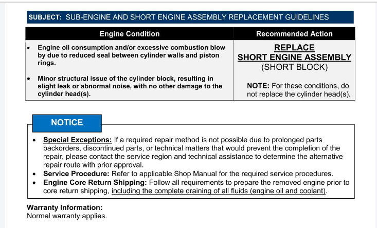

You have two cylinders under the manufacturer's minimum specifications of 156.46 psi. (see pic 1 below) I suspect that could be the issue. At this point, I would recommend contacting a Hyundai dealership and explain what is happening. Hopefully, they will do something to help.
I feel that due to an oil circulation issue (known issue see pic 2), caused the rings to wear prematurely.
Let me know your thoughts.
