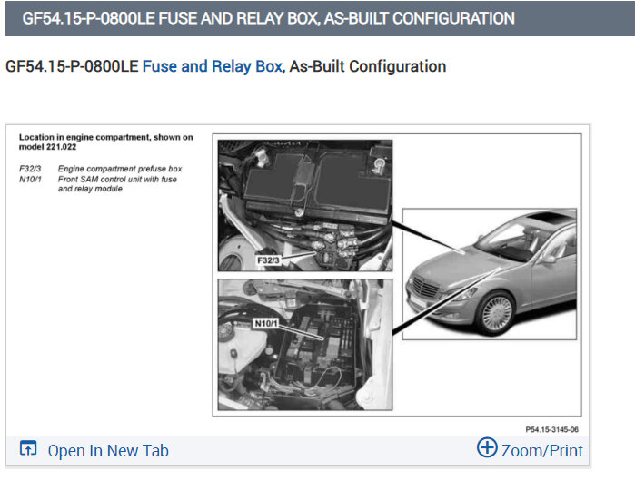

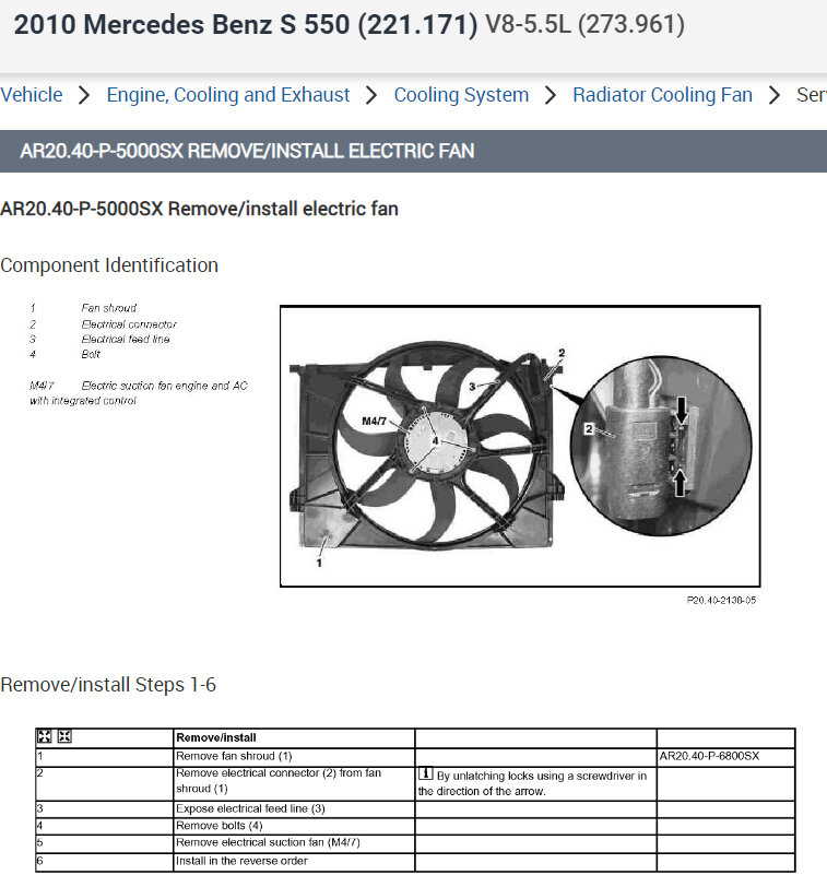

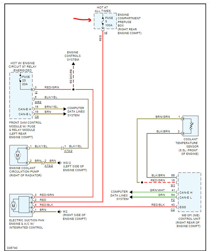

Sure, can I ask if the cooling fan is running while the A/C system is on? If not, this will be the problem. If the fan runs your problem has an internally or externally clogged radiator. Please go over this guide to see what I am talking about:
https://www.2carpros.com/articles/engine-overheating-or-running-hot
If the cooling fan is not working, I would check the #5 100-amp fuse in the fuse panel under the hood. If the fuse is good and the fan is not running, I would replace the fan motor, which is a common failure.
