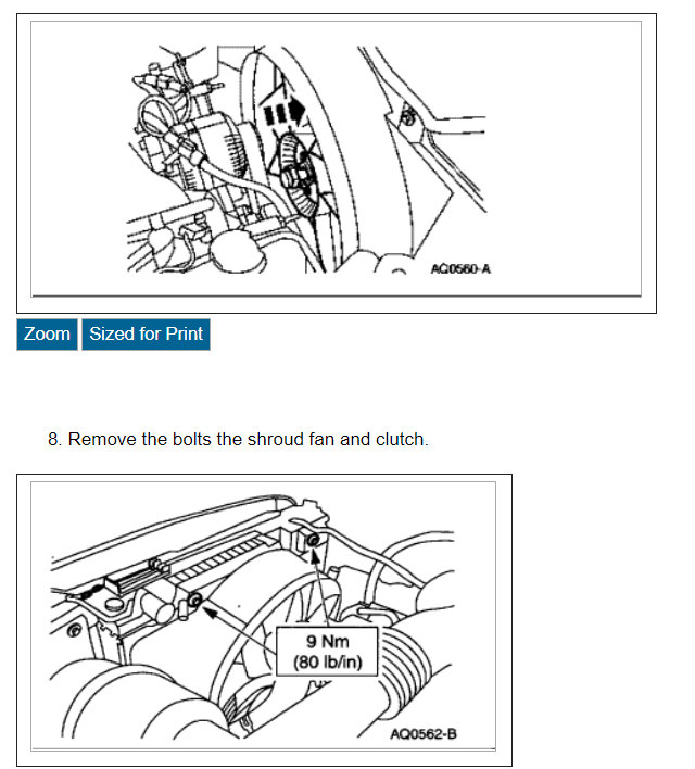

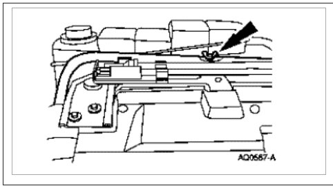

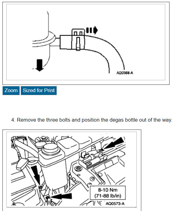

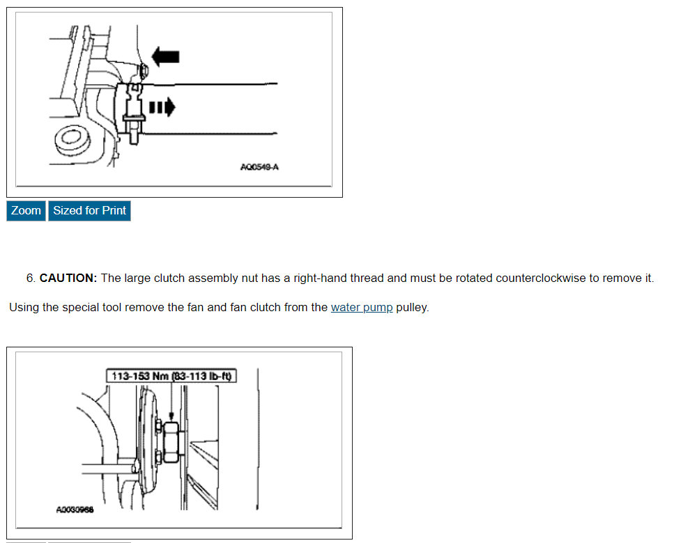

It sounds like the fan clutch is not working right. When the engine is overheating do you hear a roar from under the hood meaning the clutch fan is fully engaged? If not I would replace the clutch. Here is a video and guide and diagrams below of how to change unit out:
https://youtu.be/N_-MLVlBHk8
and
https://www.2carpros.com/articles/fan-clutch-removal
