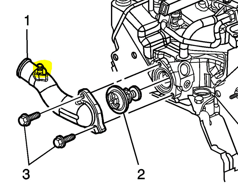

Now, you indicated there is air in the system. That is likely the cause of the problem. I am basing that on the idea that the cooling fans are running when stopped and the engine is running.

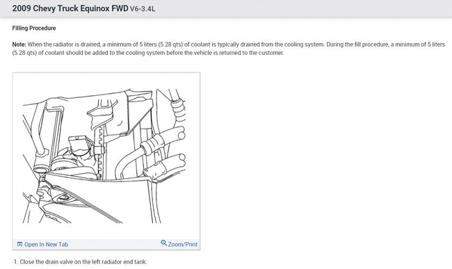

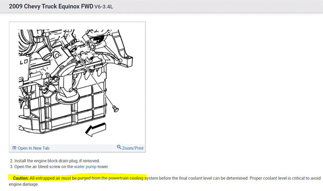

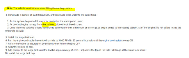

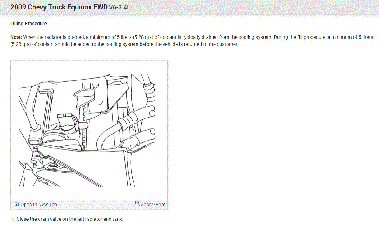

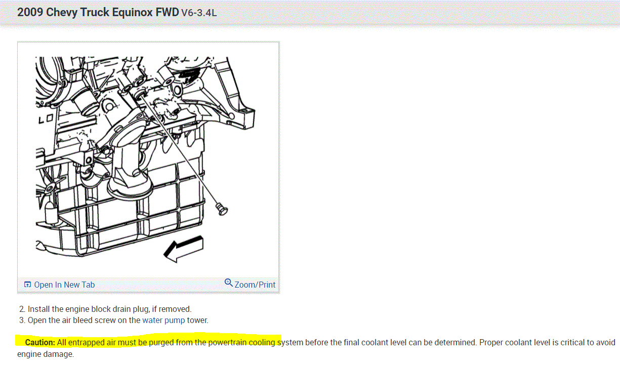

I attached the directions for bleeding air from the cooling system. You will need to open a bleeder on the thermostat housing (pic 1 below). Remember, do this when the engine is cold.
The remaining pics are the directions.
Try this to see if you can get the air out of the system. Also, have the heater turned on high heat when bleeding it as well.
Let me know if this helps.
