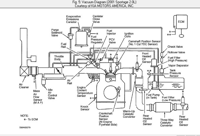

perform visual inspection if any vacuum hose jumped out that can cause engine stalling and can leak some oil outside the engine.

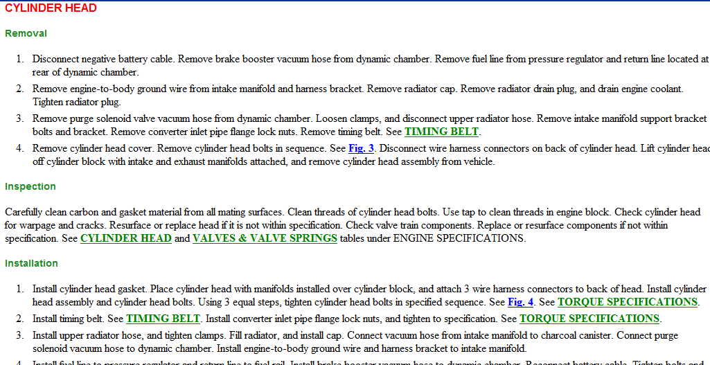

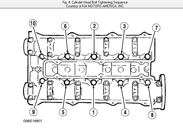

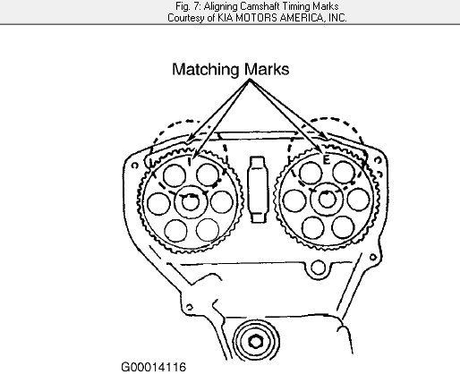

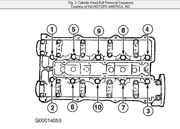

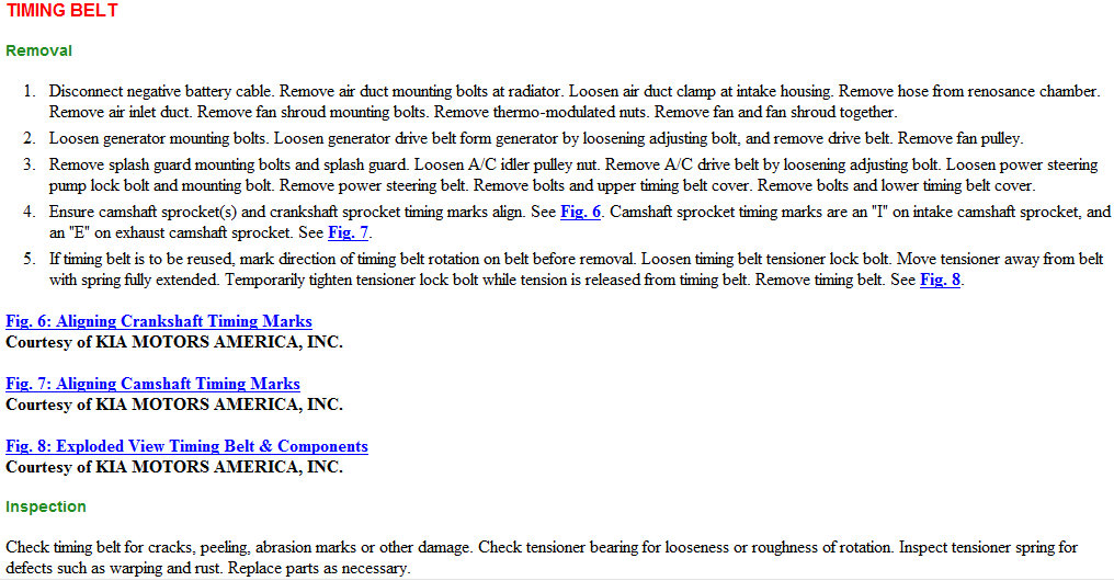

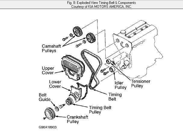

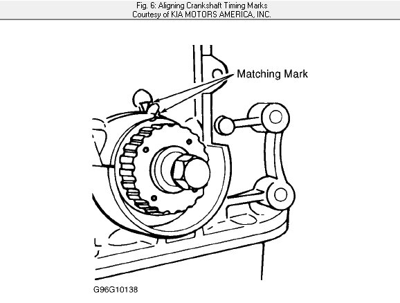

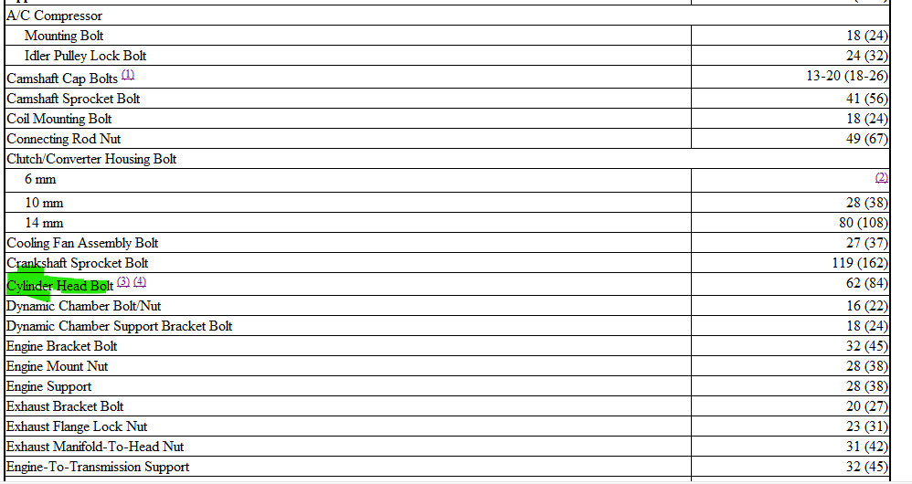

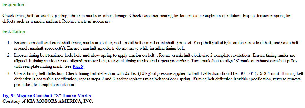

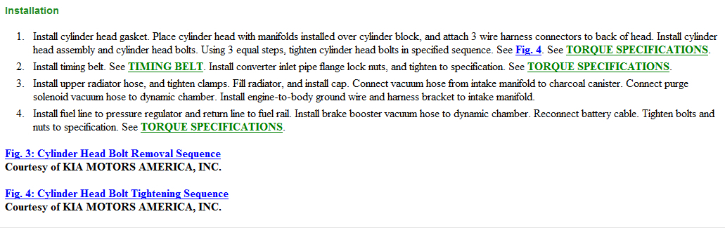

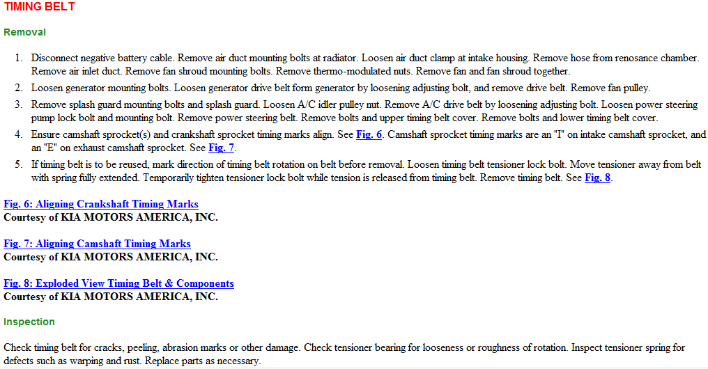

Check guides and the diagrams below the procedure how to remove and reinstall cylinder head and perform valve timing.
