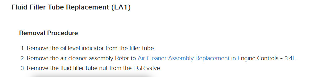

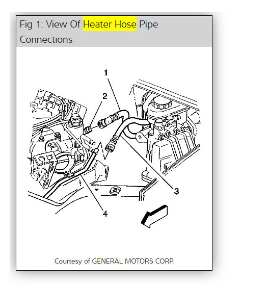

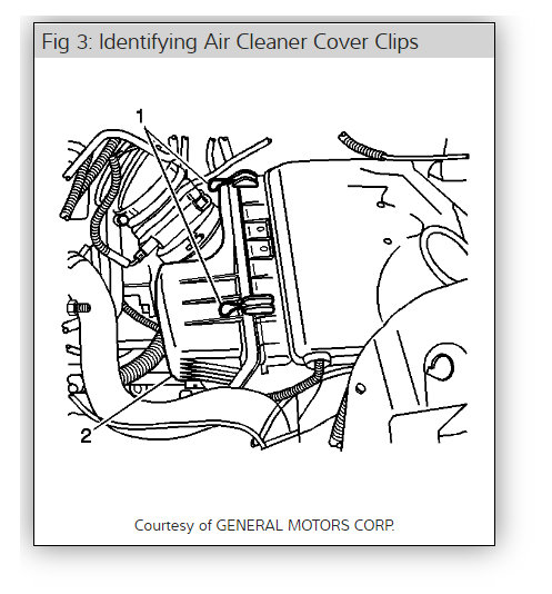

Started to overheat, pulled over water leaking from behind motor steam too. after it cooled down I was adding water to radiator with the car off I noticed it dripping out from behind motor somewhere. can't see where it's coming from. frustrated !
Sep 5, 2019 at 3:01 AM
SCGRANTURISMO
  • 4,897 POSTS

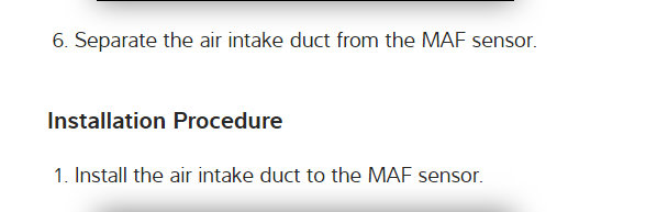

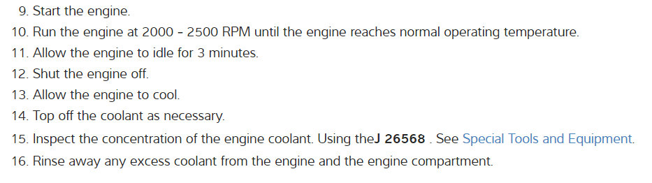

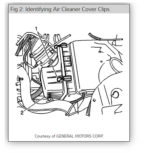

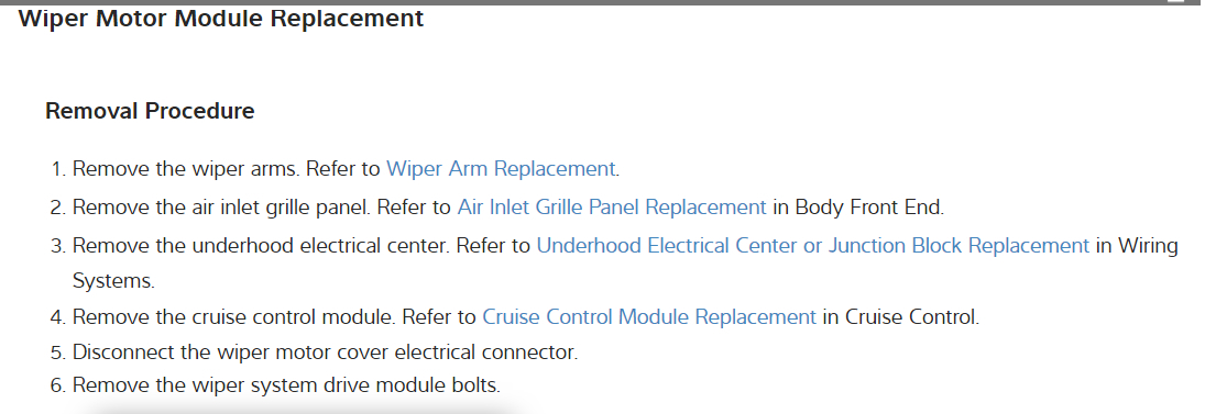

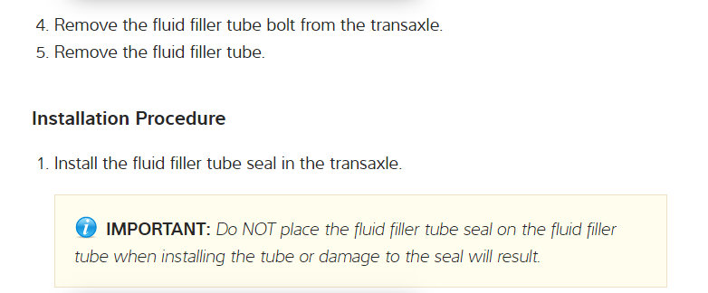

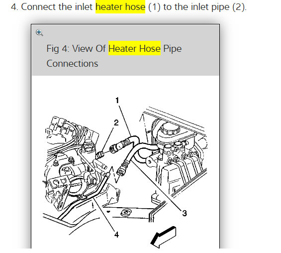

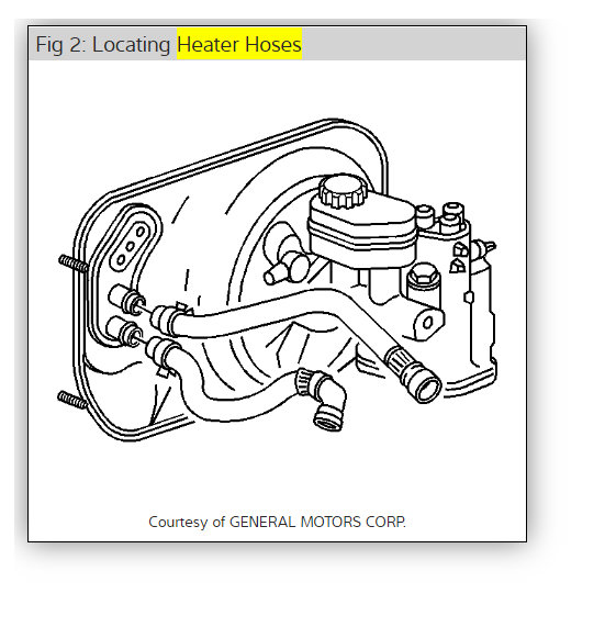

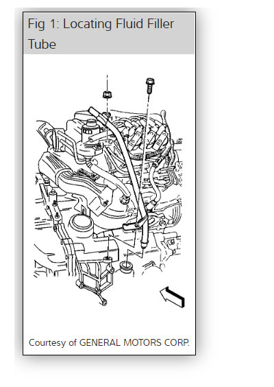

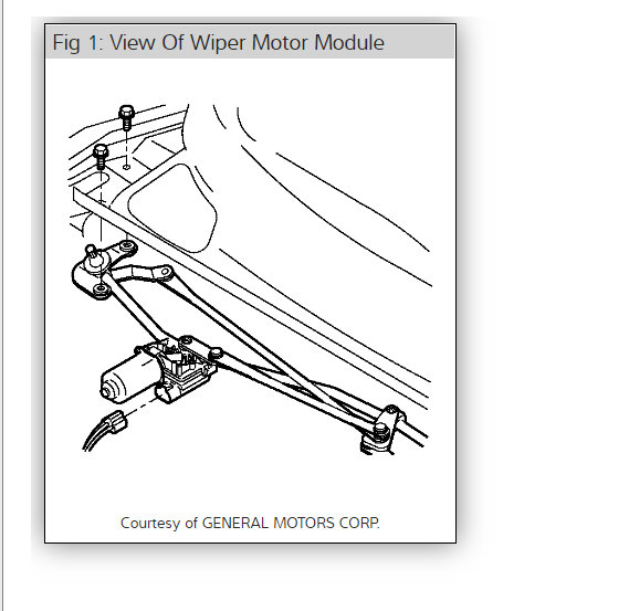

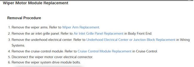

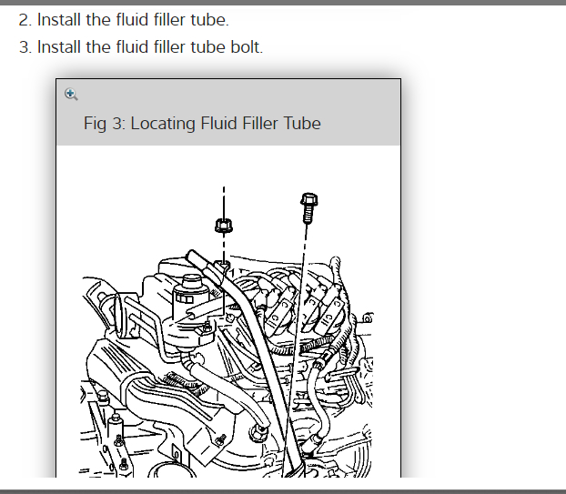

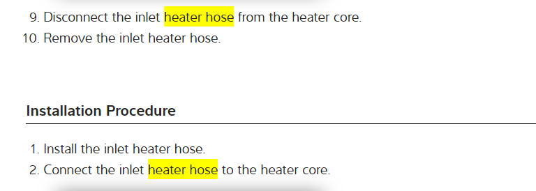

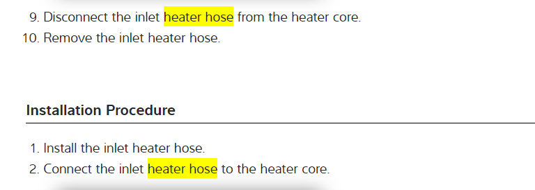

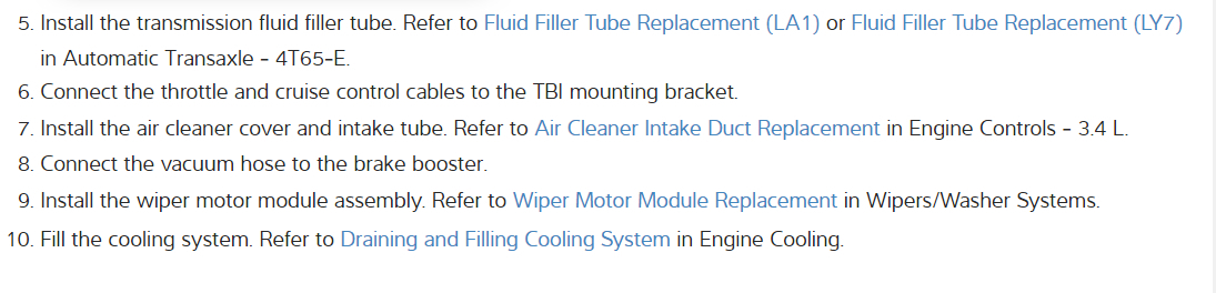

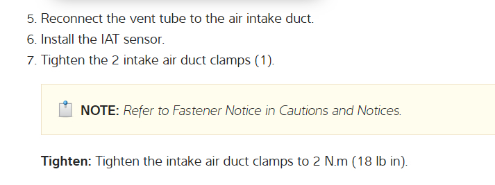

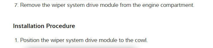

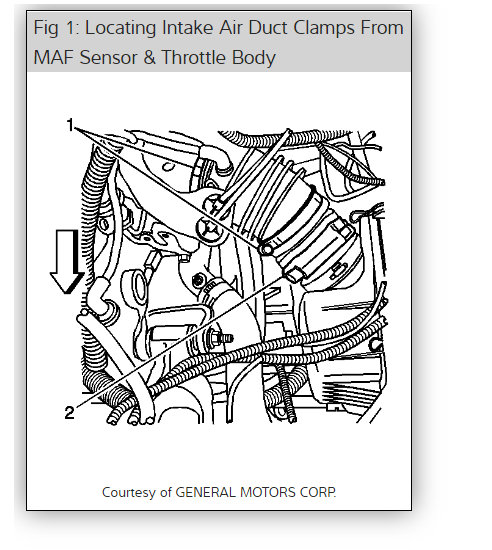

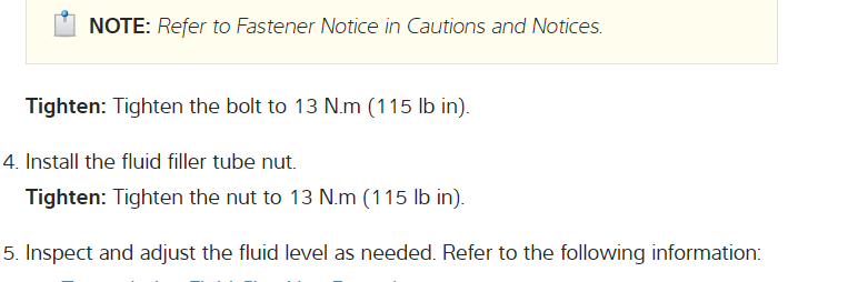

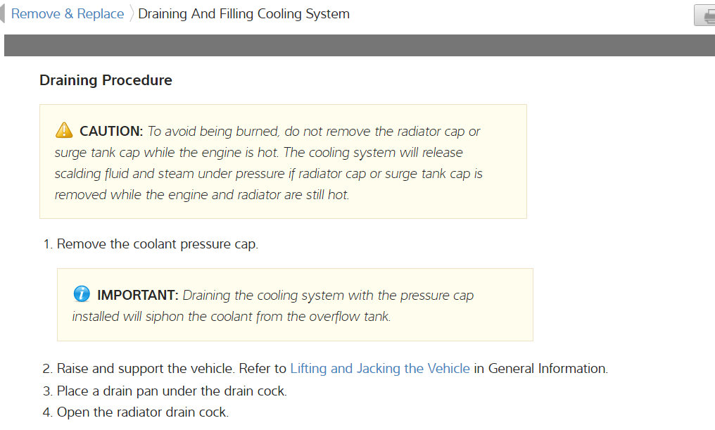

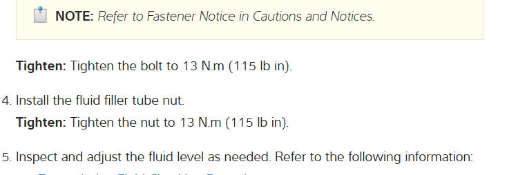

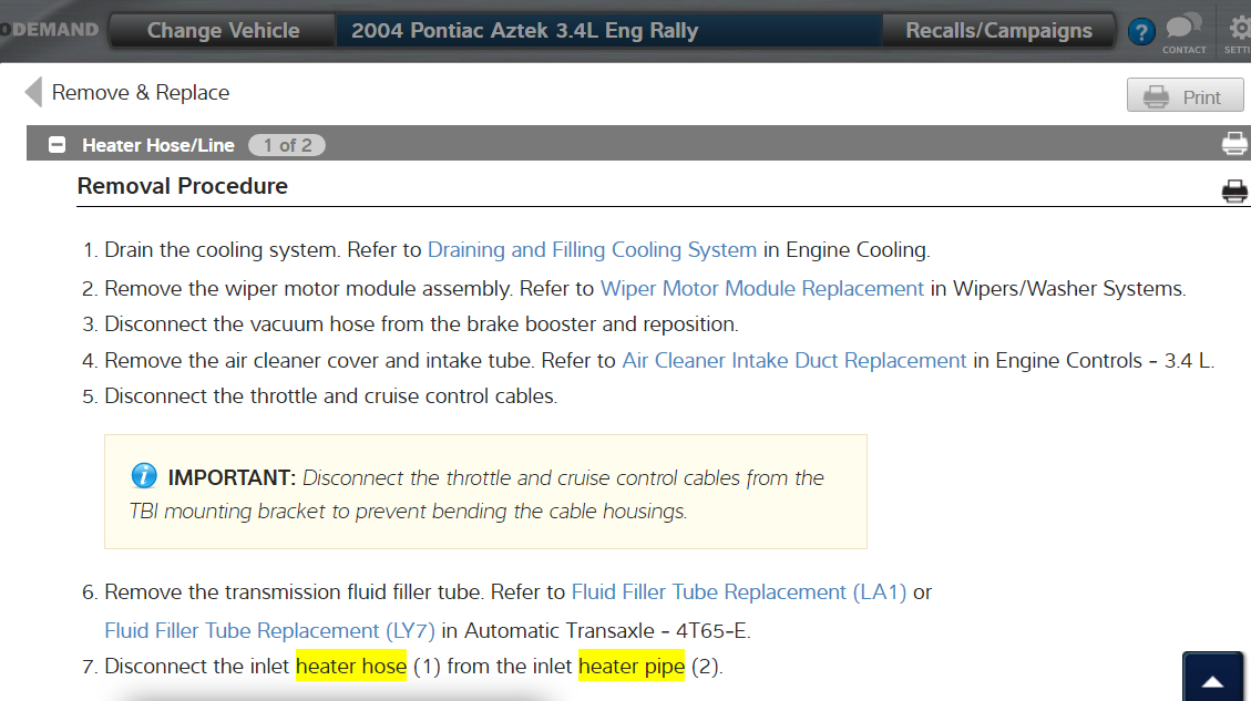

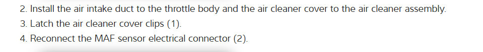

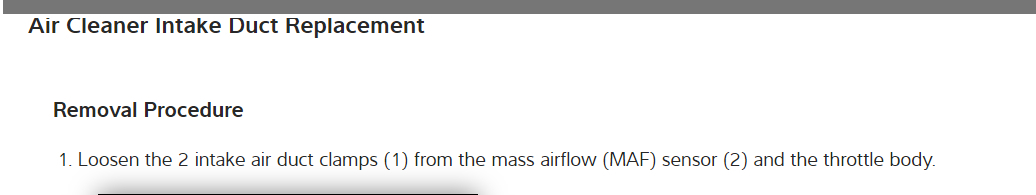

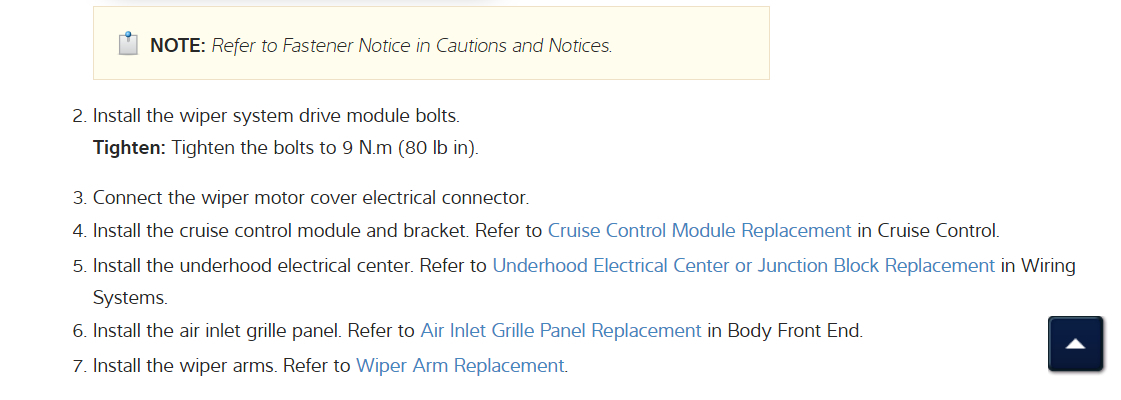

This sounds like it could be a problem with your vehicle's heater hoses leaking. Please inspect the heater hoses for cracks, splits, cuts, or a clamp that has broken or has backed off. If the heater hoses are damaged, I have included in the diagrams down below the vehicle manufacturer's guide for the removal and installation of the heater hoses. Please go through this guide, if needed, and get back to us with what you find out.
Thanks,
Alex
2CarPros
