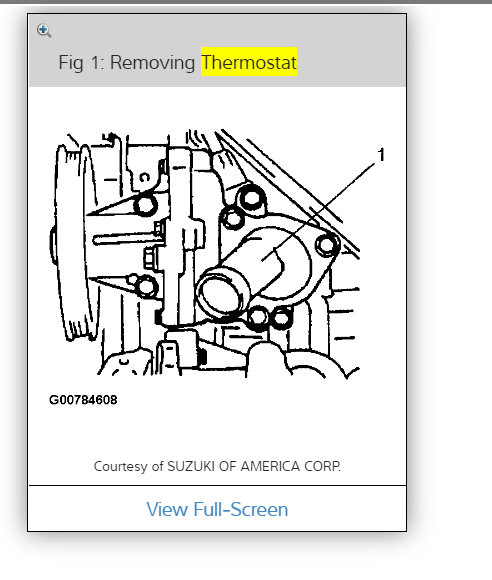

Overheating, thermostat's location, and remove and replace instructions needed
2004 SUZUKI AERIO
146,000 MILES • 2.3L • 4 CYL • 4WD • AUTOMATIC
DANN CASEY
The car overheated. No heat coming from the heater core.
Suspect thermostat requesting its location and remove and replace instructions.
Jul 5, 2022 at 8:23 AM
  • 55,224 POSTS

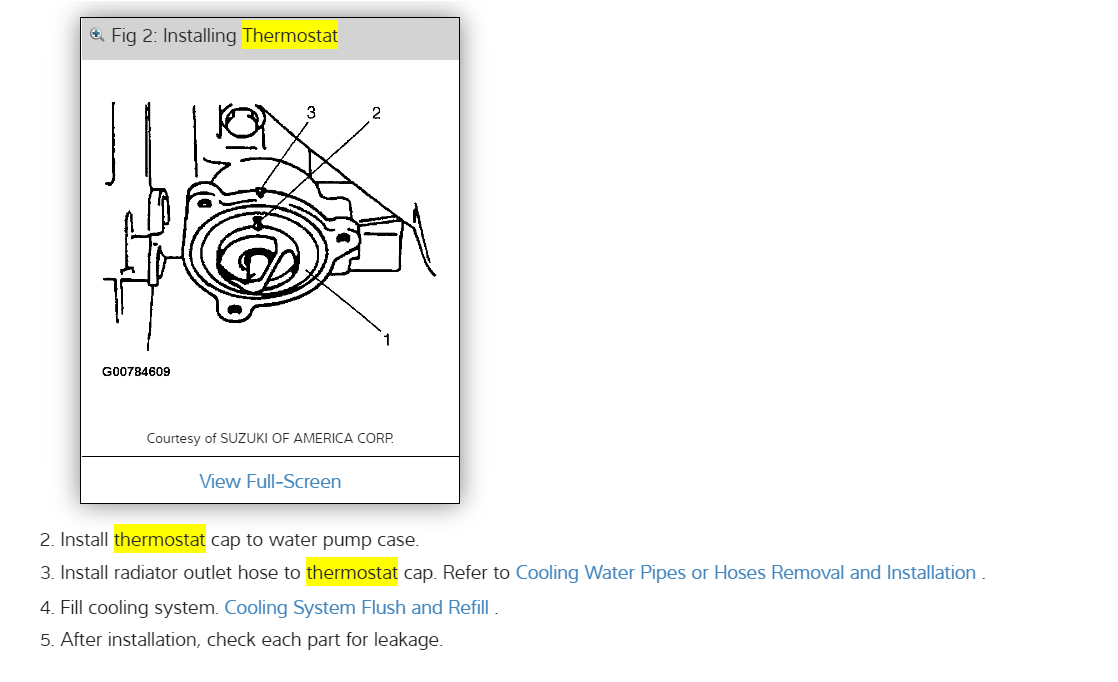

The thermostat is near the water pump. here is a generic guide to help you do the job with specific instructions in the diagrams below to help you with your car:
