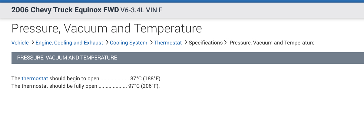

SCGRANTURISMO
  • 4,897 POSTS
Hello again,
Well it wouldn't be the first time or the last time that a thermostat was bad right out of the box. I would suggest either replacing the thermostat again or testing it to make sure that it is opening. You can place it in a pan of boiling water. As it reaches the opening temperature, you can actually watch it open up. If it doesn't then it is bad. In the diagrams down below I have included the opening temperatures for your vehicle's thermostat. Please get back to us with what you are able to find out.
Thanks,
Alex
2CarPros
Thursday, July 1st, 2021 AT 1:06 PM
