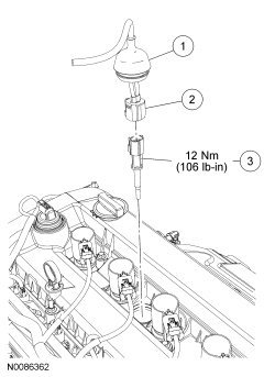

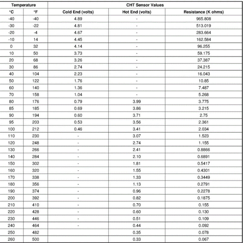

I am currently experiencing an overheating issue with temperature gauge going up high and into the red on occasion. We just finished up replacing the thermostat on it but it is still going into the red upon driving a couple blocks. I am curious if it may be either a water pump issue or CHT sensor issue or maybe something else? Just trying to narrow it down so I am not throwing money at something that is fine. Thanks!

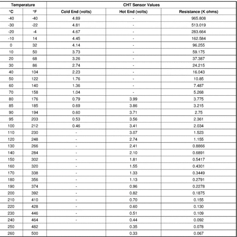

As far as testing the CHT, you will need to unplug it and check resistance. If you look at pic 1, it shows the resistance that should be found based on temp.

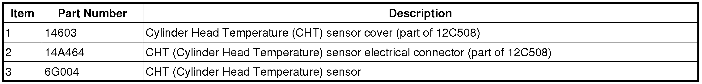

If the sensor is bad, here are the directions for replacing it. The attached pics correlate with the directions.

Removal and Installation
1. Detach the Cylinder Head Temperature (CHT) sensor cover and position aside.
2. Disconnect the CHT (Cylinder Head Temperature) sensor electrical connector.
3. Remove the CHT (Cylinder Head Temperature) sensor.
- To install, tighten to 12 Nm (106 lb-in).
4. To install, reverse the removal procedure.
