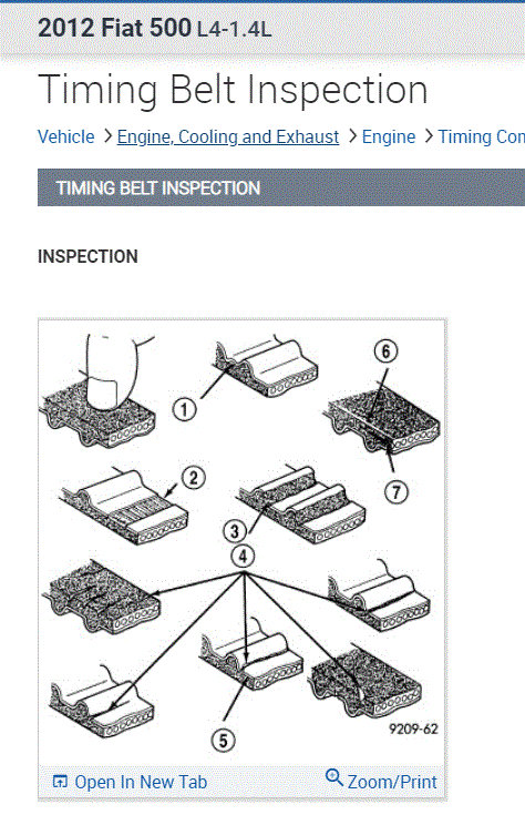

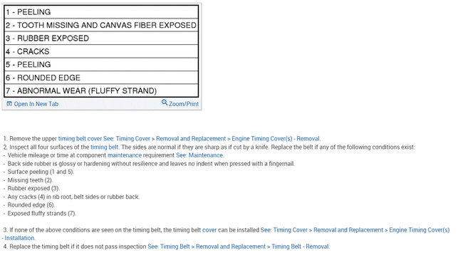

This is an interference engine. If the timing belt broke, it would likely have caused internal engine damage such as bending valves in the cylinder head. That would cause a no compression issue. With that, I recommend removing the timing belt cover and inspecting it to see if it is broken or damaged.

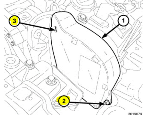

I attached three pics below. Pics 1 and 2 explain what to look for if the belt has not broken. Pic 3 shows the upper timing belt cover. There are two bolts that hold it in place (I think 10mm). Remove the bolts and then the plastic cover to access the belt.
