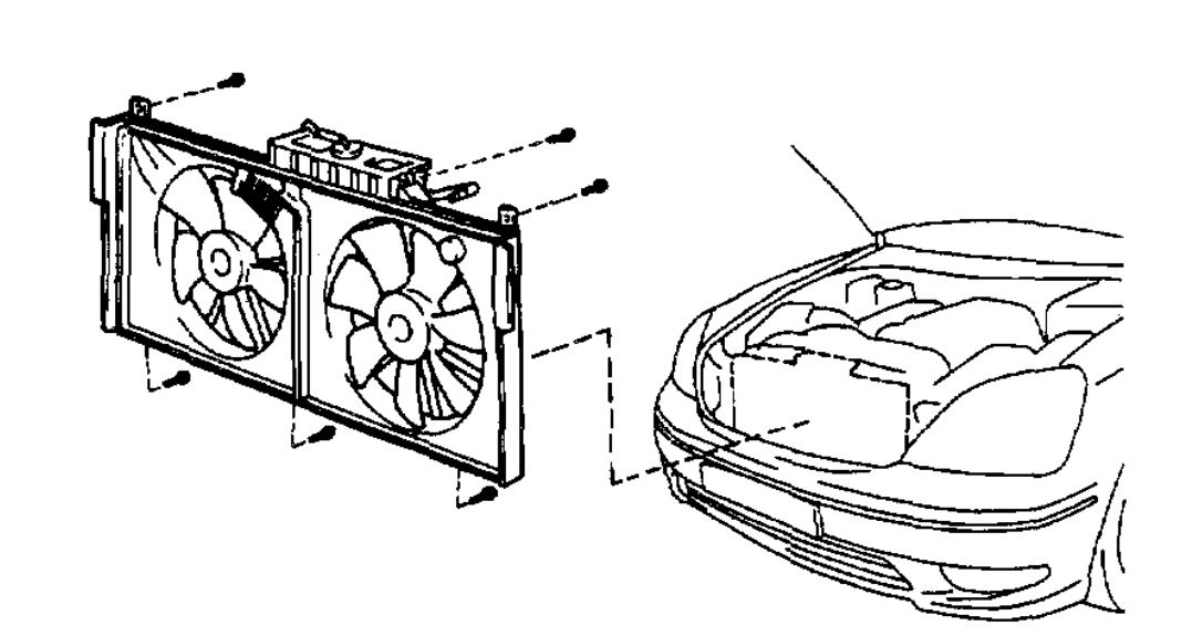

I added a little water (1/2 gallon) and turned on the A/C after starting the engine (cold state first thing in the am). Both fans appeared to be turning.

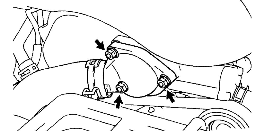

I would think or start with a thermostat. It may be opening too late.
Do the fans work without the A/C operating? This would make sense since it does it in stop and go driving.
https://www.2carpros.com/articles/how-an-electric-cooling-fan-works
If she drives with the A/C on, does it still do the same thing?

Didn't check to see if the fans operated without A/C. Here in Florida the A/C is almost always on during daylight but I can check and get back to you.

My friend and I can check the thermostat. would that be the next step?
Oct 2, 2019 at 7:15 AM
Correct. Test the temperature.
