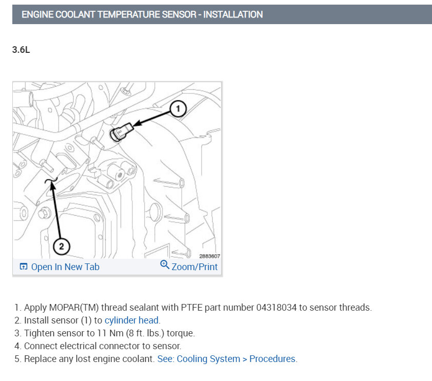

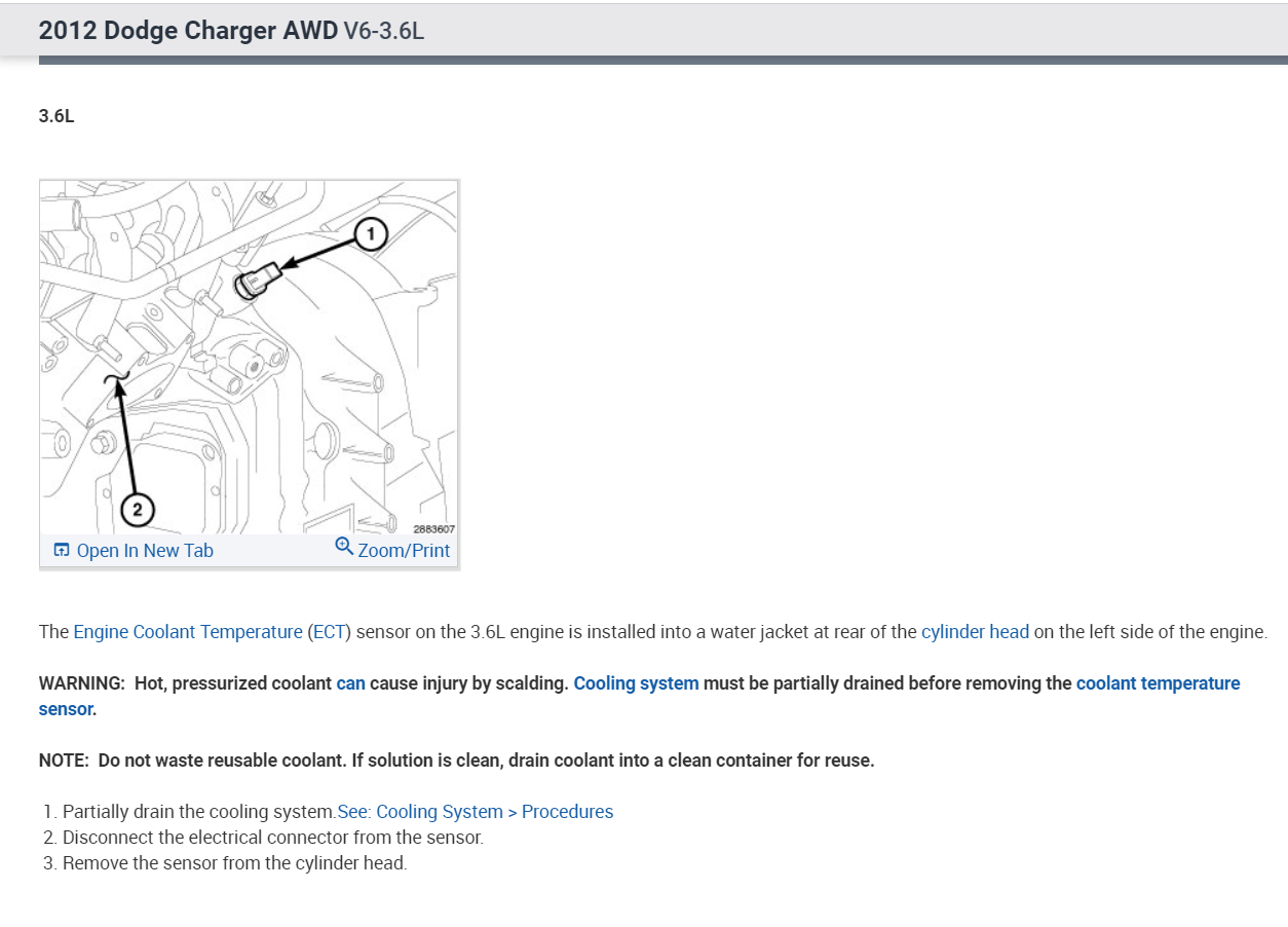

If the coolant level is okay, I would try replacing the engine coolant temperature sensor. Here is the location in the images below. If the car still has the problem, please do a blown head gasket test.
This guide can show you how:
Check out the images (below). Please let us know what you find. We are interested to see what it is.

Okay, thanks. I will try the block test and I have already replaced the sensor but was still having an overheating issue. Oh yes when I first started looking at the overheating issue the coolant would boil in the reservoir when it stopped the reservoir would be full then a couple minutes after that you would see the reservoir go all the way down.
