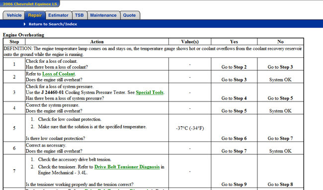

check our guide for engine overheating.:
https://www.2carpros.com/articles/symptoms-of-an-overheating-engine
https://www.2carpros.com/articles/engine-overheating-or-running-hot
Check the tables fig 1,2,3,4 trouble shooting specific to your car.

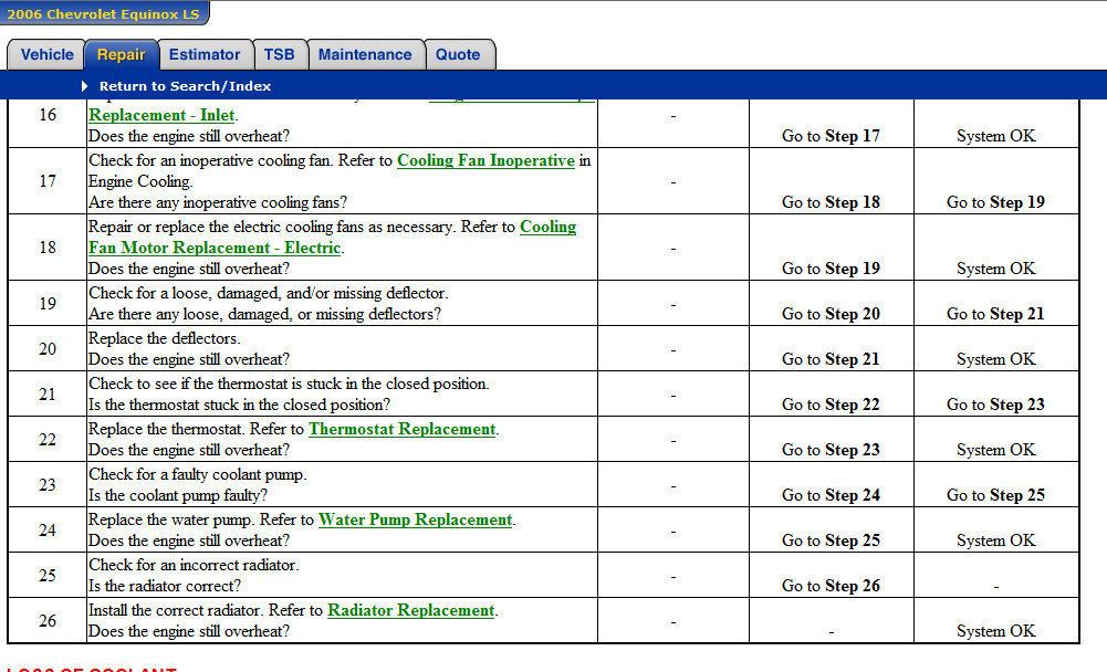

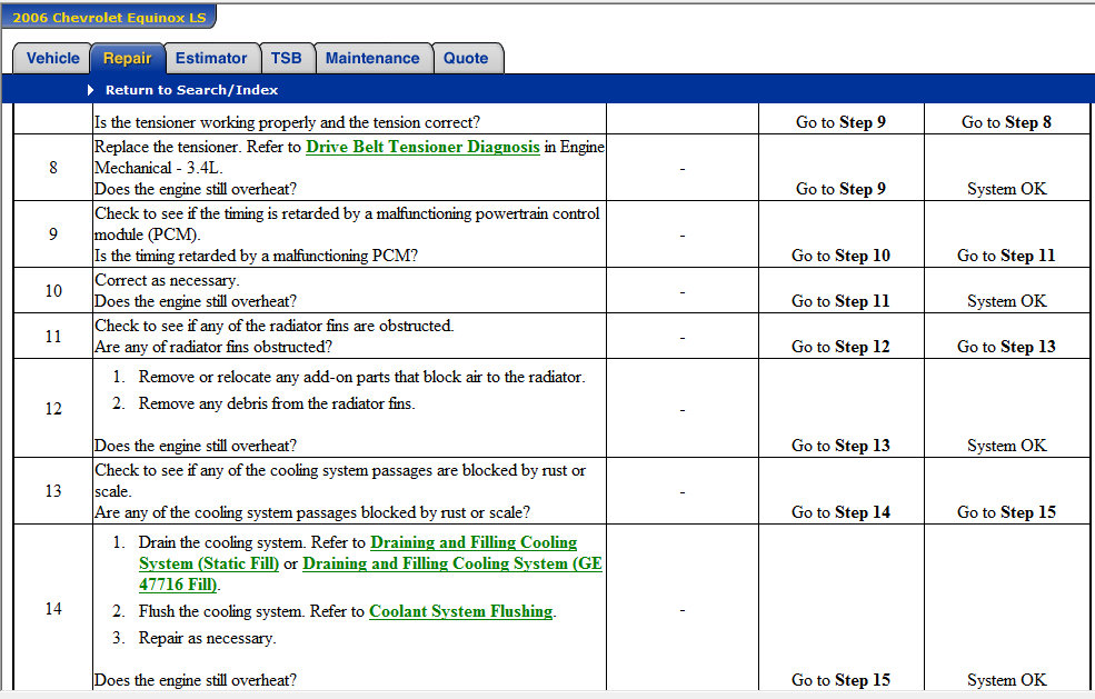

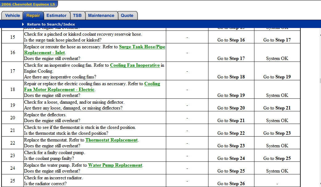

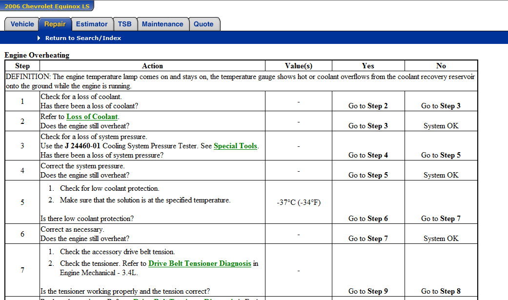

Have you performed all the diagnostics step by step as mentioned in the attached picture above? engine belt tightness, coolant reservoir cap holding pressure, antifreeze content, radiator front air duct open? radiator fans are working properly?system properly bled?

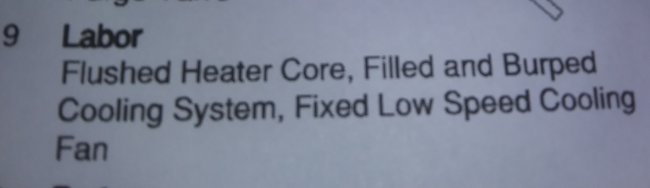

This was done to my car on 3-15 because of the issues above i was having. Just got a call from the shop since i took it back the second time. now they say it is a blown head gasket. So why would they have not known that the first time?
