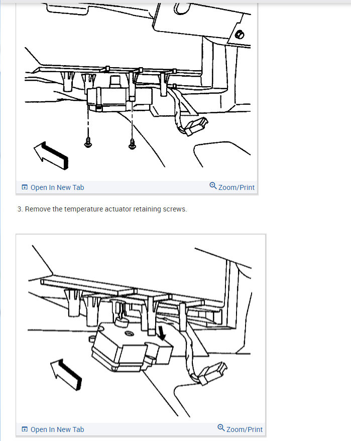

Nope, no sensor. You said you moved the door manually and no heat. That leaves only the heater core.
Heater/Vent Module Replacement
Removal Procedure
1. Drain the engine coolant. Refer to Cooling System Draining and Filling See: Cooling System > Removal and Replacement.
2. If equipped remove the auxiliary battery.
3. Reposition the inlet heater hose clamp from the heater core.
4. Remove the inlet heater hose from the heater core.
5. Reposition the outlet heater hose clamp from the heater core.
6. Remove the outlet heater hose from the heater core.
7. Remove the I/P carrier. Refer to Instrument Panel Carrier Replacement See: Dashboard / Instrument Panel > Removal and Replacement.

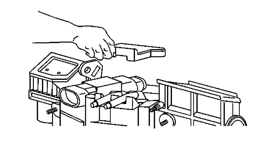

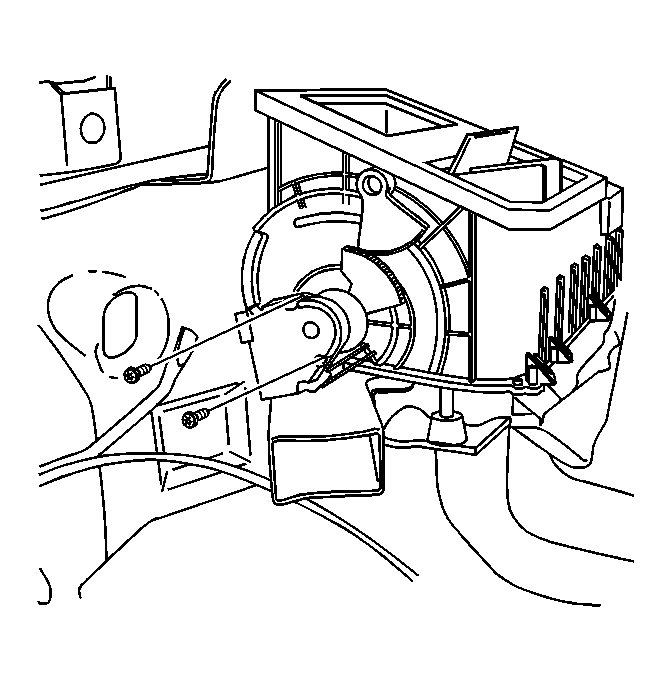

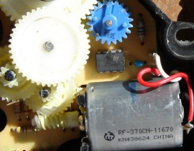

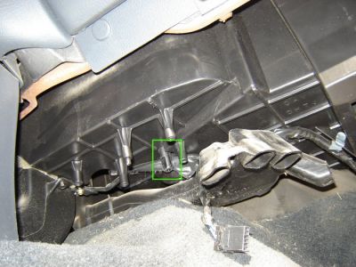

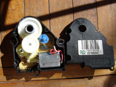

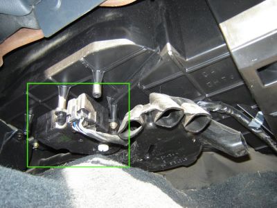

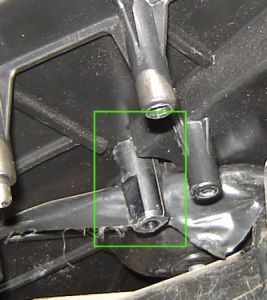

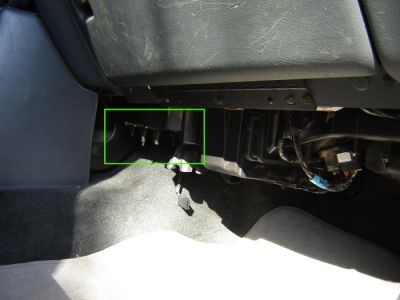

ALWCURLZ
Sounds like my issue. Found out the problem was the "air door actuator", GM P/N 52474810. This part is about $100.00 at the dealer. Save some money and get it at O'Reilley's Auto Parts for $46.00 with a lifetime warranty! Also, you can check eBay and find them there. The actuator is underneath, near the center of the underside of your dash accessed from the passenger side. You will need to remove the three screws that hold that cover on and you will see it there.
https://images.2carpros.com/forum/automotive_pictures/332933_20090316_01524_1.jpg
Here is the post that turns the flap inside. You can manually move it if you are in a pinch where it is real cold and you need heat until the new part goes in.
https://images.2carpros.com/forum/automotive_pictures/332933_20090316_01526_1_1.jpg
https://images.2carpros.com/forum/automotive_pictures/332933_20090316_01526_1.jpg
Another picture here shows part of the problem. I believe the problem is that little blue gear which is attached to some type of potentiometer that has contacts exposed which gets grease in there. Also note another indication it was going to fail: Check the motor where it has markings on it. It says: "China" bet the whole unit was made there.
https://images.2carpros.com/forum/automotive_pictures/332933_20090316_01523_2_1.jpg
https://images.2carpros.com/forum/automotive_pictures/332933_20090316_01523_1.jpg
Here is the new one installed. This one I bought from O'Reilley, using the GM part number 52474810. This part also has a lifetime warranty! :)
https://images.2carpros.com/forum/automotive_pictures/332933_20090317_01530_1.jpg
Here is the new one: https://www.amazon.com/gp/product/B0012PQX3U/ref=as_li_qf_sp_asin_il_tl?ie=UTF8&tag=2carprcom-20&camp=1789&creative=9325&linkCode=as2&creativeASIN=B0012PQX3U&linkId=484be50463f80c7d6cf715954050752d Please let us know what happens.

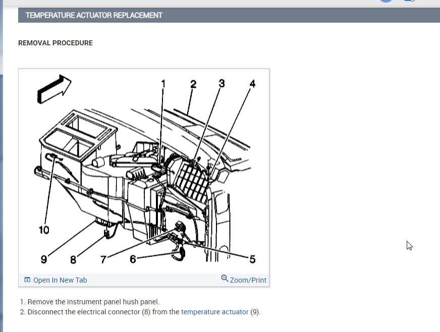

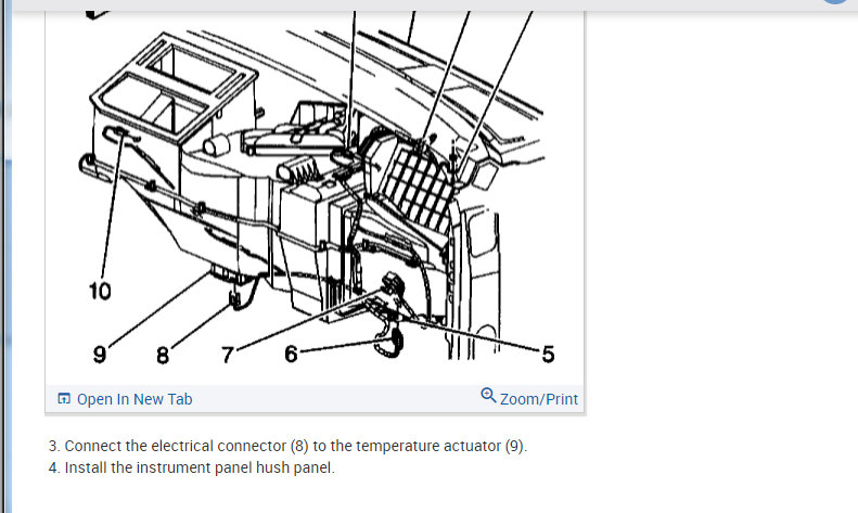

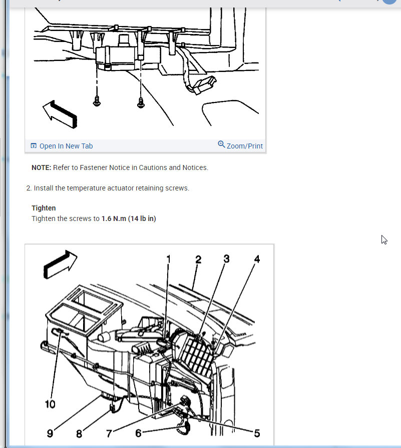

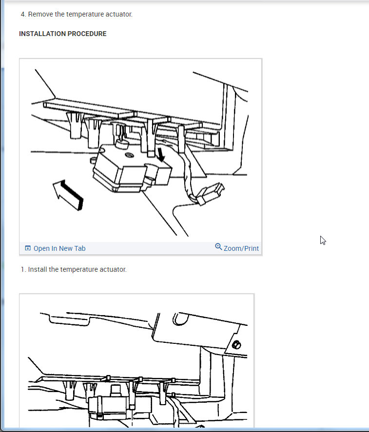

This is correct that the blend door is most likely the issue. Below is the info from the manual on how to replace this. Please run through this material and let us know if you have other questions.
Here is a guide that will help with this as well:
Below is the info from the manual. Thanks
