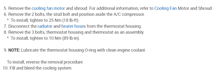

My car engine overheats on driving a short distance. The check engine light is always on when I start the engine. But I noticed a coolant leakage around the pulleys, but radiator fan is always on. On parking I find coolant splashed on the bonnet so what is the probable cause?

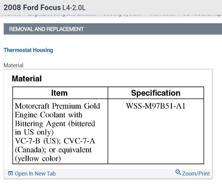

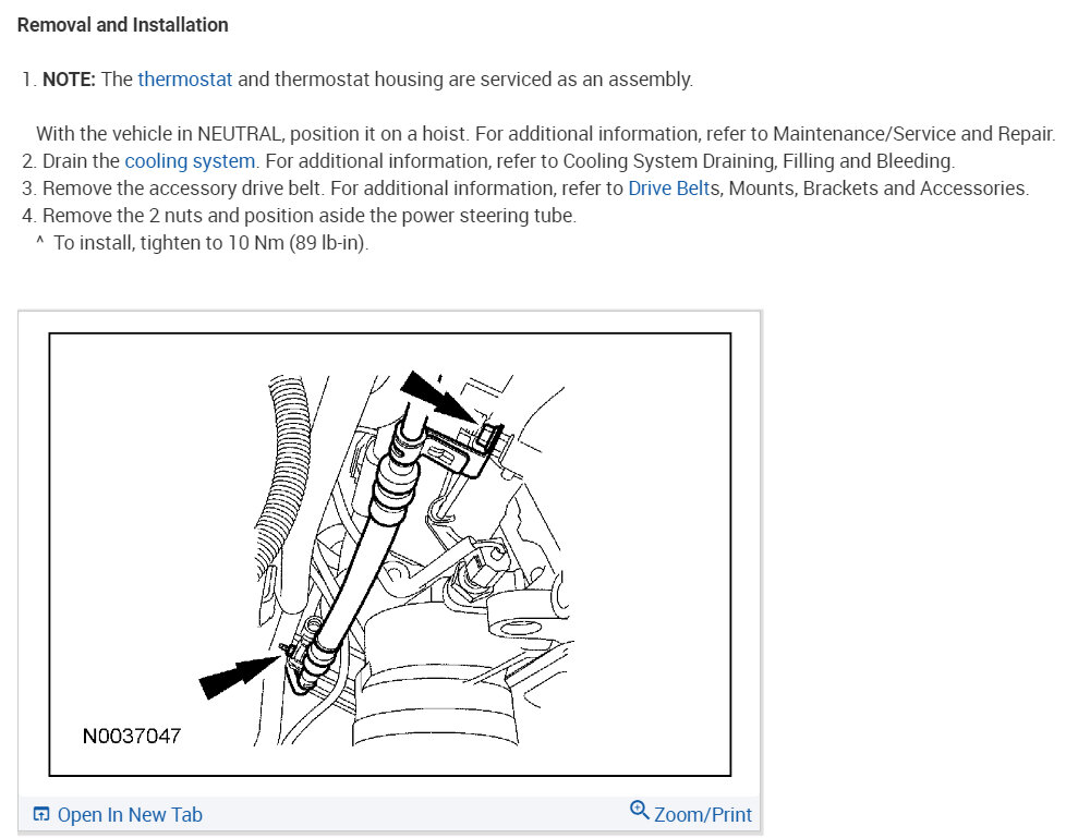

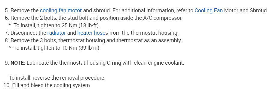

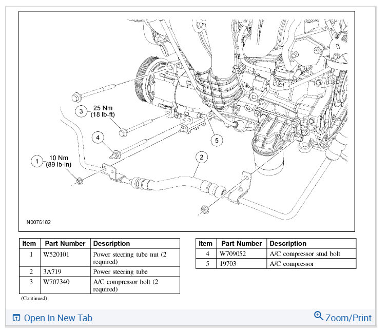

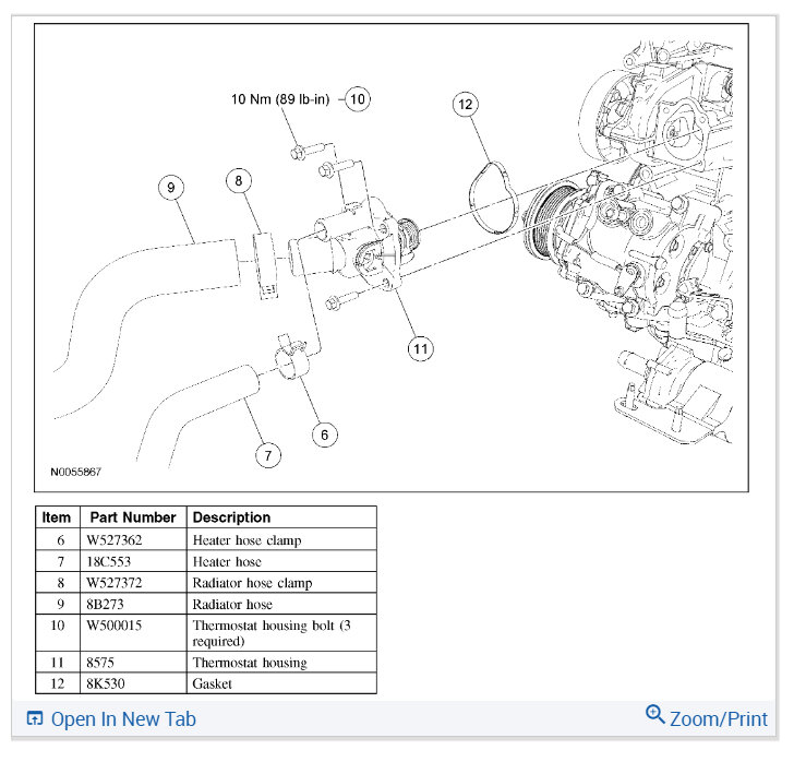

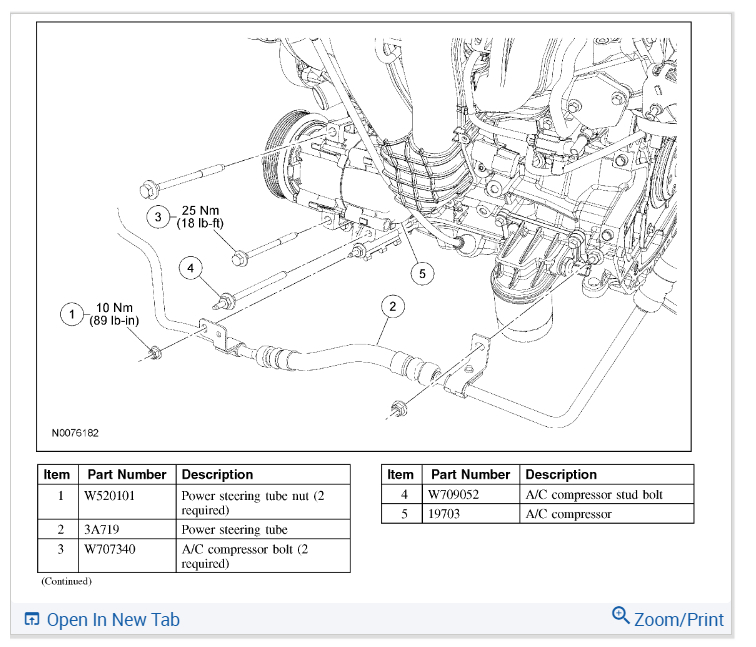

Yep, this can happen when the thermostat sticks closed which is common. This guide can help, and I have left instructions in the images below to help you change the thermostat out. To be sure you can grasp the lower radiator hose and if it is cold, I would replace the thermostat.
https://www.2carpros.com/articles/engine-overheating-or-running-hot
Check out the images (below). Please let us know how it goes.
