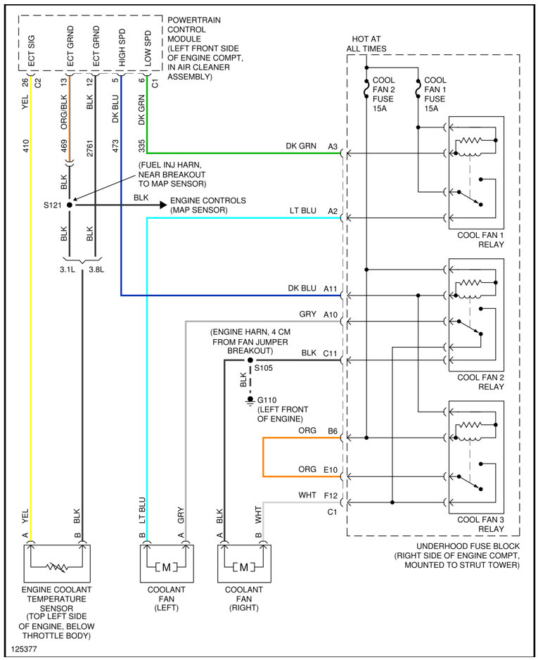

okay, let's start off with what i have done. i have replaced the following on my car listed above:
Radiator, radiator cap, cooling fans, water pump, heater core, engine temperature sensor, and relays.
After replacing/checking the above my cooling fans will now come on. but only when the A/C is running. They however still will not turn on when overheating. It will redline and the fans still will not turn on unless i run the A/C.

I would suggest to load test the wiring from the PCM to the 3 fan control relays.
See wiring diagram attached below,
If wiring is found to be in order would suggest to test/replace the 3 control relays next,
How to test wiring,
How to check relays,
Hope this helps,
