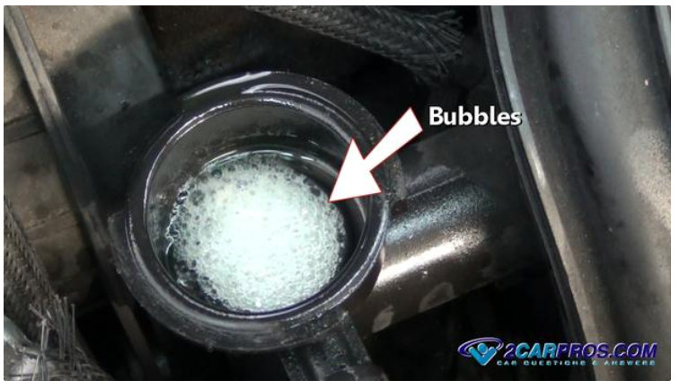

I want you to try something. When the engine is cold, remove the radiator cap and start the engine. Let me know if coolant comes out when it is running and still cool.
If it doesn't, allow it to run for a bit. Check to see if there are air bubbles in the coolant.

If that happened cold and it shot out, we likely have a head gasket issue. If the coolant stops coming out, allow it to run and see if there are any bubbles in the coolant before it gets too hot. See pic below

Okay, but does it matter if it looks like the picture? Because my just spilled out as if was overfilling, not necessarily bubbles.
Sep 2, 2022 at 2:50 AM
  • 110,248 POSTS
If there is a leak, usually it will look like the pic. When you started it, how quickly and aggressively did it come out? I have actually seen the shoot out like a fountain. LOL
Let me know. Also, you may need to perform a test to determine if there are exhaust gases in the coolant. This is really easy to do, and the product can be found in nearly any parts store. If you look at the link, I attached above related to a faulty head gasket, drop down to test 4, chemical test.

it started coming up around the 7-minute mark. And it wasn’t some big explosion, just overflowing but I’ll look into the test,
