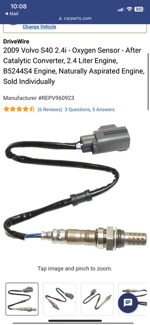

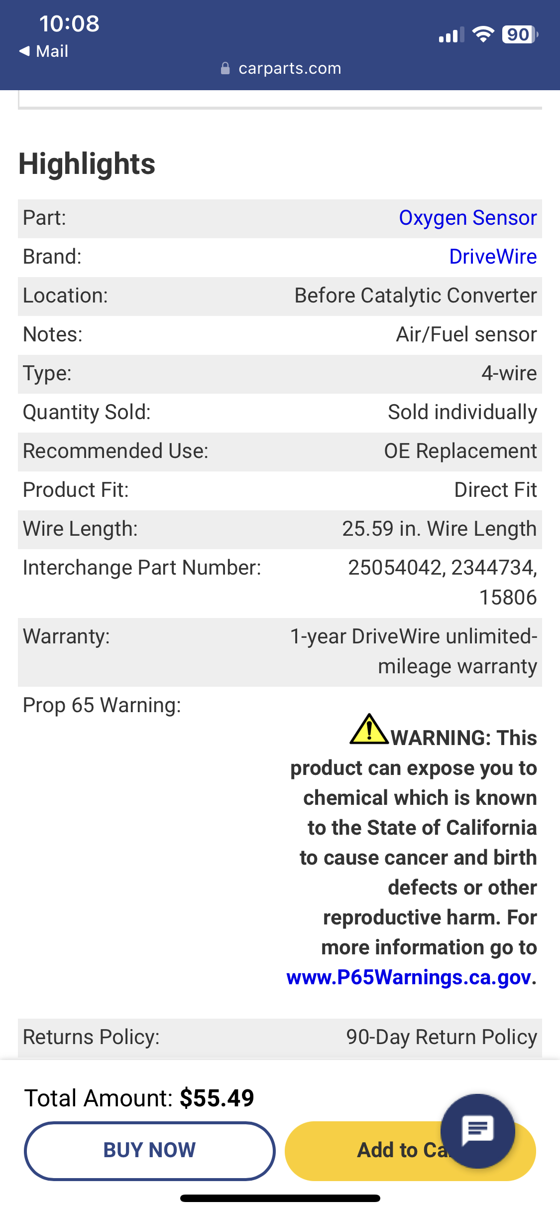

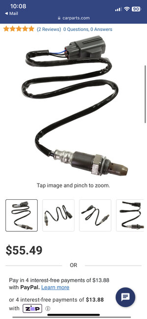

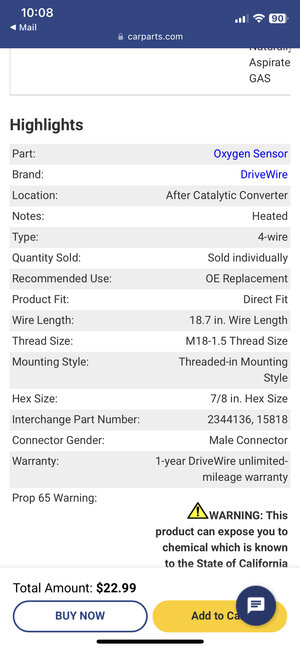

Okay so, I looked at the parts and the 02 (that was too short to reach) is the one that produces heat (after Catalytic converter 02 is what is says in the description and the note says “heat)
The one I actually needed was the “before catalytic converter 02”
Could that have been the issue?

Yes, there are two 02 sensors, usually one before the converter and one after. Did you get the O2 sensors yet? and have you put them on? After you do will probably have to rescan the car and reset the computer.
