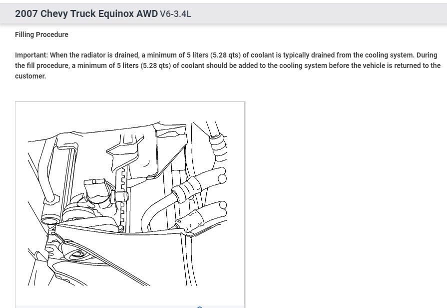

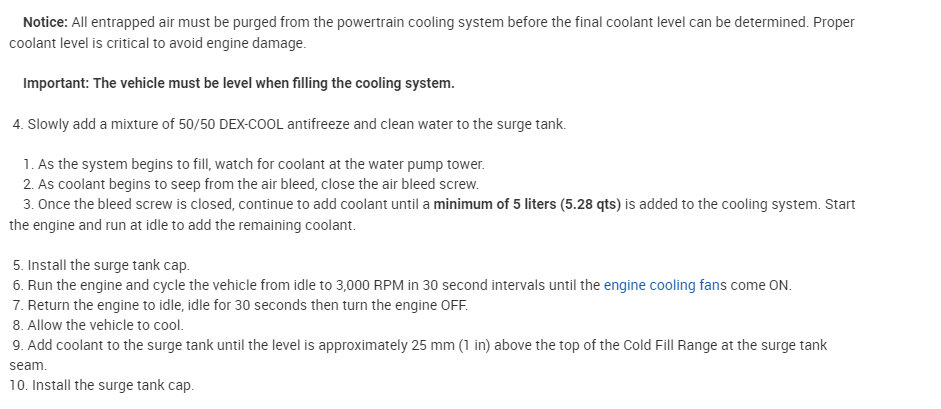

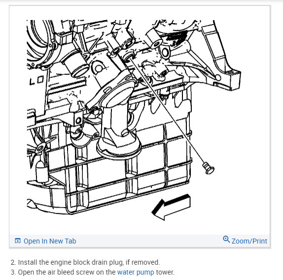

If the heater is working as well as the cooling fans, it does sound like trapped air in the system.
When you bleed the system, are you opening the bleeder on the water pump tower?
Do me a favor. I attached the directions below for bleeding the system. Take a look through the directions and let me know if you may have missed something.
One other thought, remember not to mix the traditional coolant with Dexcool, and let me know if it ever overheats at highway speed.
