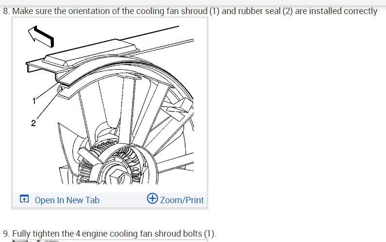

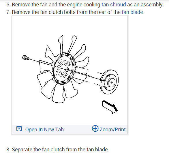

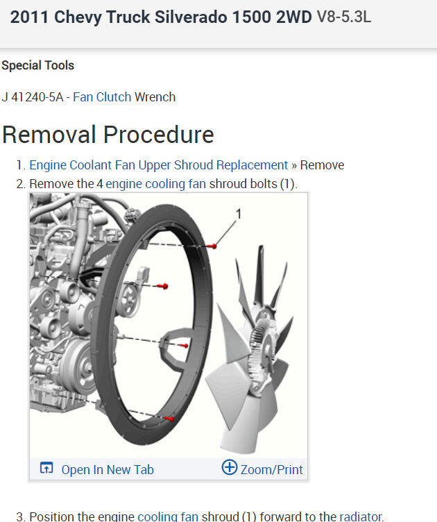

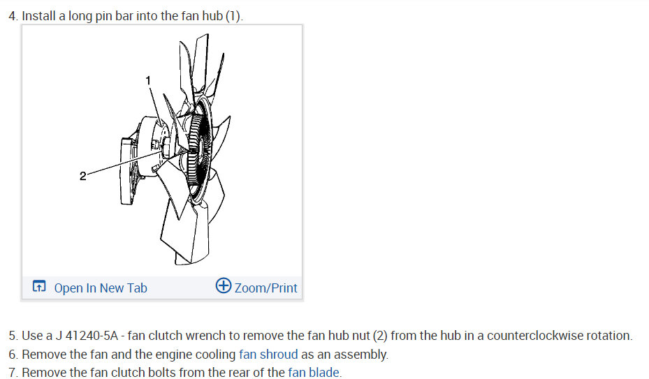

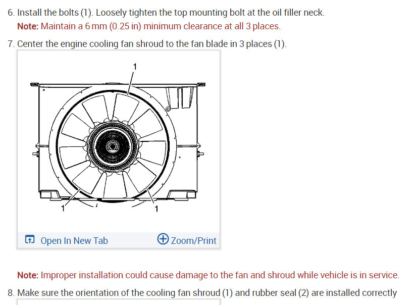

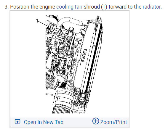

My truck is a 2011 Chevy silveradol1500 5.3 LT is overheating. I changed the radiator, the engine coolant sensor, the thermostat, and the ambient sensor, the cap and its idleing pretty high It overheats more when not driving.
Oct 2, 2024 at 3:24 AM
  • 55,743 POSTS
When the engine is running hot can you hear the clutch fan kick on? If not, then this is the problem. Here is a guide to help you as well, please go over it:
https://www.2carpros.com/articles/engine-overheating-or-running-hot
Here is a video to help you remove the fan clutch and I have included instructions in the images below for your car.
https://youtu.be/PoVQpbkCvtc?si=iHXlH_hbFN2Qsd5g
Check out the images (below). Please upload pictures or videos in your response of any problems so we can see what to help you with.
