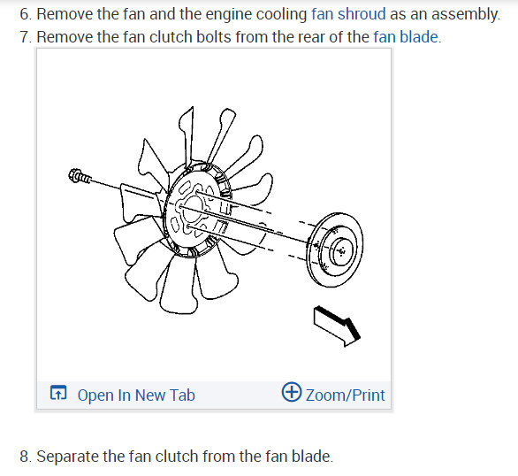

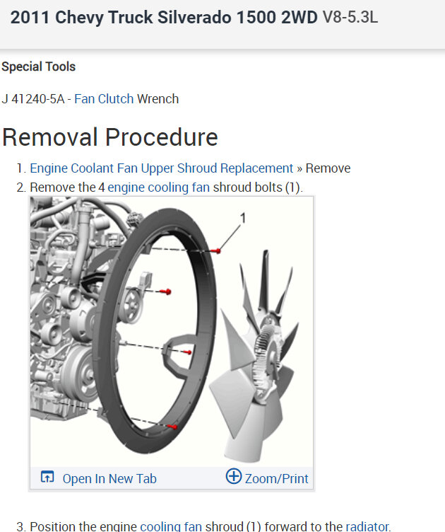

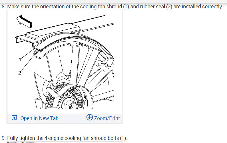

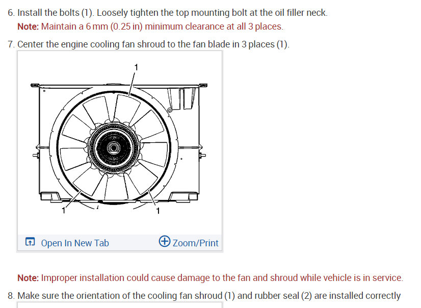

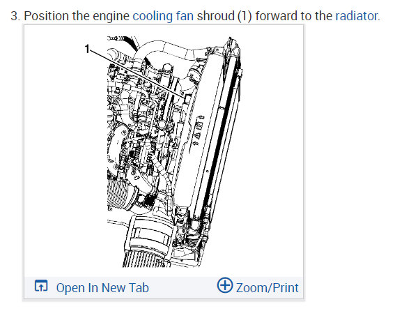

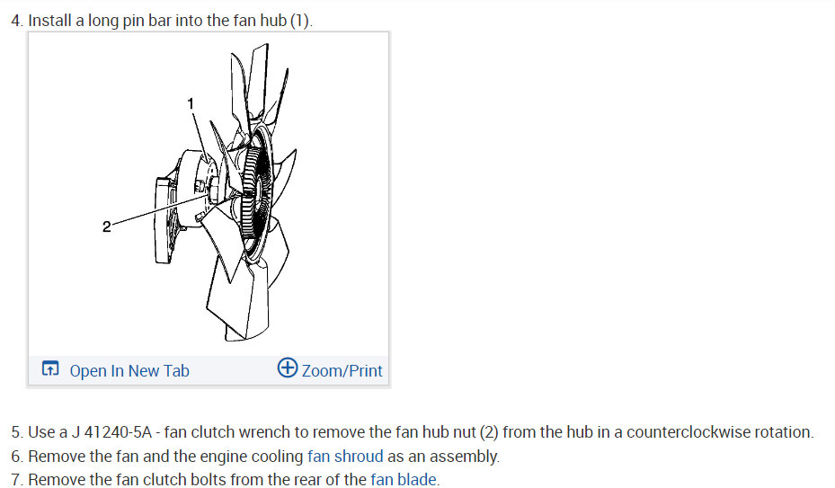

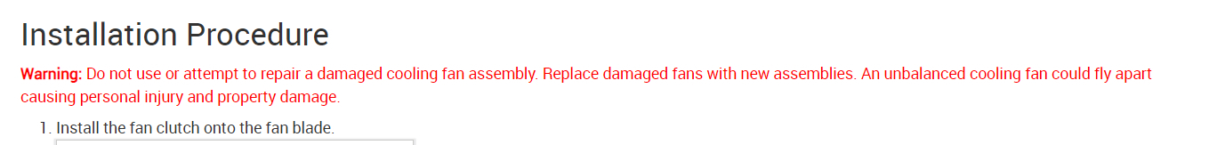

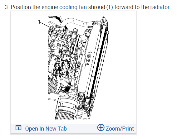

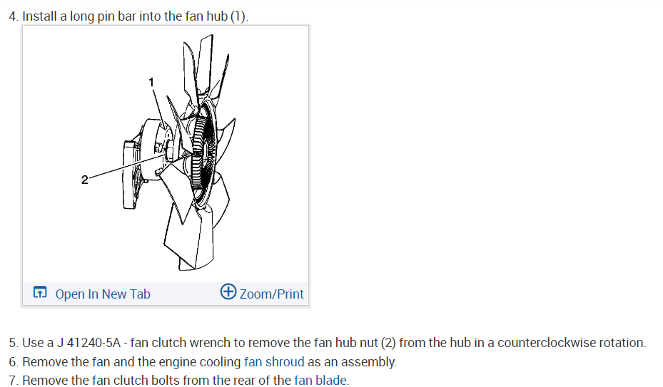

When the engine is running hot can you hear the clutch fan kick on? If not, then this is the problem. Here is a guide to help you as well, please go over it:
https://www.2carpros.com/articles/engine-overheating-or-running-hot
Here is a video to help you remove the fan clutch and I have included instructions in the images below for your car.
https://youtu.be/PoVQpbkCvtc?si=iHXlH_hbFN2Qsd5g
Check out the images (below). Please upload pictures or videos in your response of any problems so we can see what to help you with.
