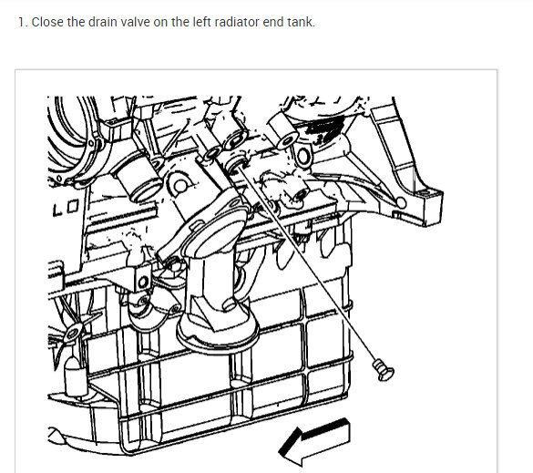

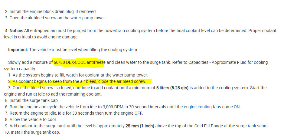

The thermostat should be reinstalled. It will prevent the engine from reaching operating temp in a specific amount of time. As a result, you will get a code indicating there is an issue.
As far as the overheating, does it happen at highway speed as well as stop and go traffic? If it is only stop and go, are the cooling fans turning on when the temperature starts to go up?

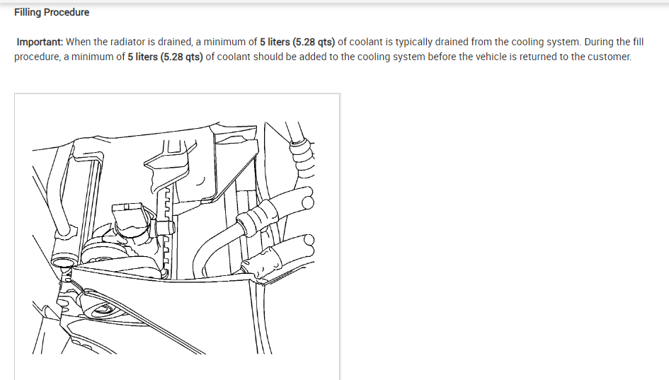

I attached the directions for refilling the cooling system below. Note, you need to use DexCool coolant or something that is universal and can mix with it. Let me know if that wasn't done.

It's only when the vehicle stops after running for 15 or so minutes the fans definitely kick on and sometimes help and sometimes don't. I used a universal antifreeze that was compatible with the vehicle.
