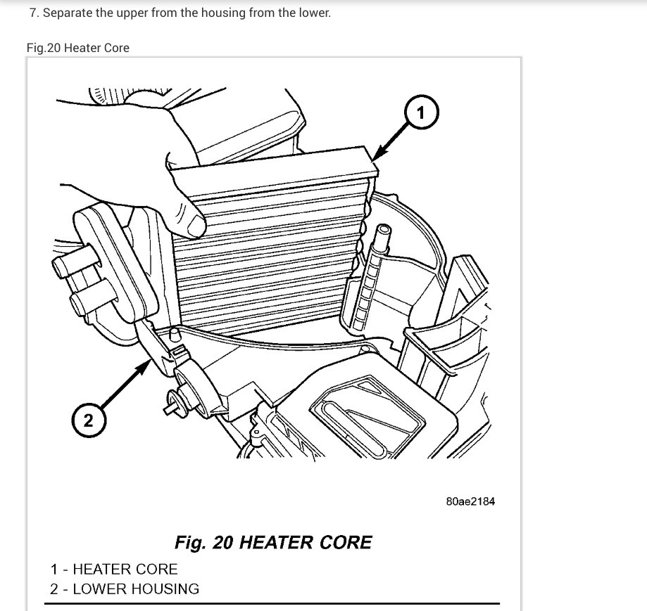

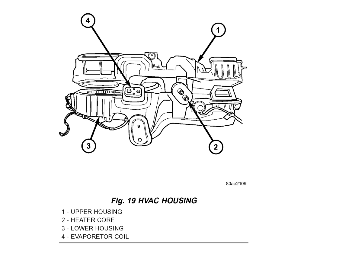

My car is overheating and this morning I got in and there was a frozen puddle of water on my passenger side floor.
Thursday, December 12th, 2019 AT 6:27 AM
12 Replies

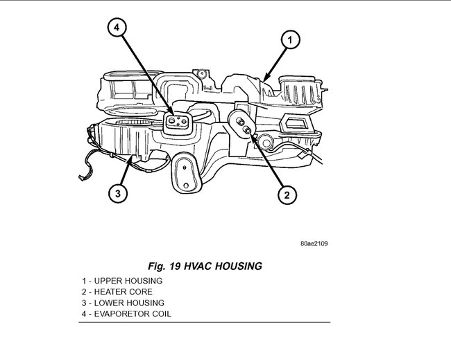

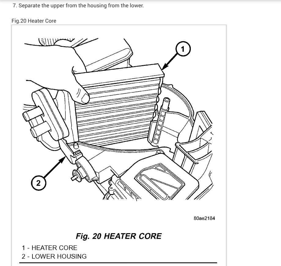

This is the heater core that has a leak. Due to the leak the coolant level is low and causes the overheating.
You could still have another issue causing the overheat but we need to start with this.
Let me know if you have questions. Thanks
Thursday, December 12th, 2019 AT 5:07 PM

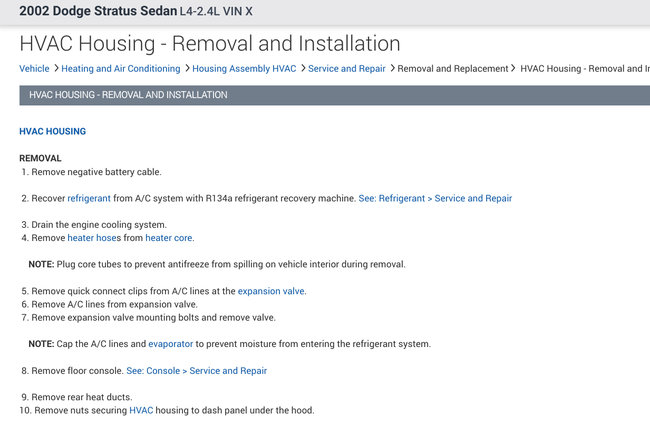

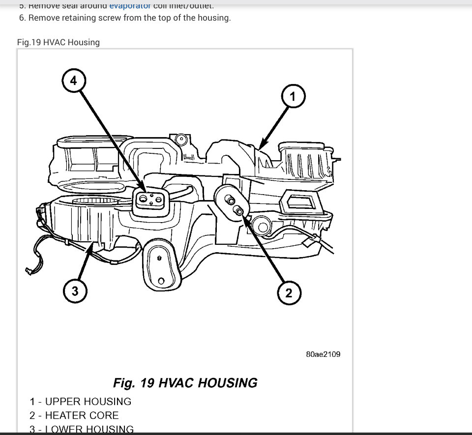

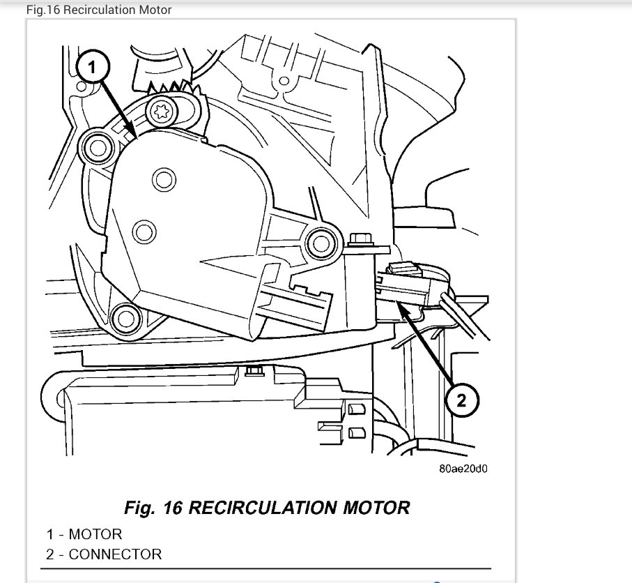

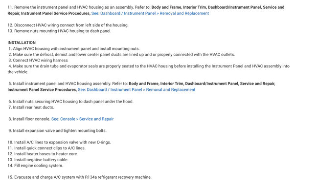

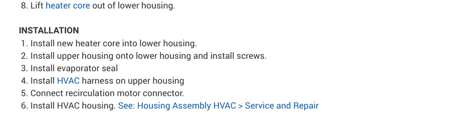

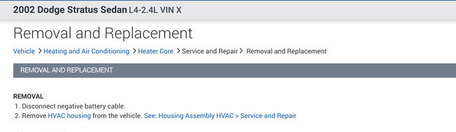

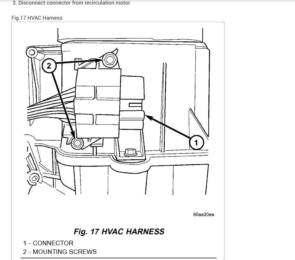

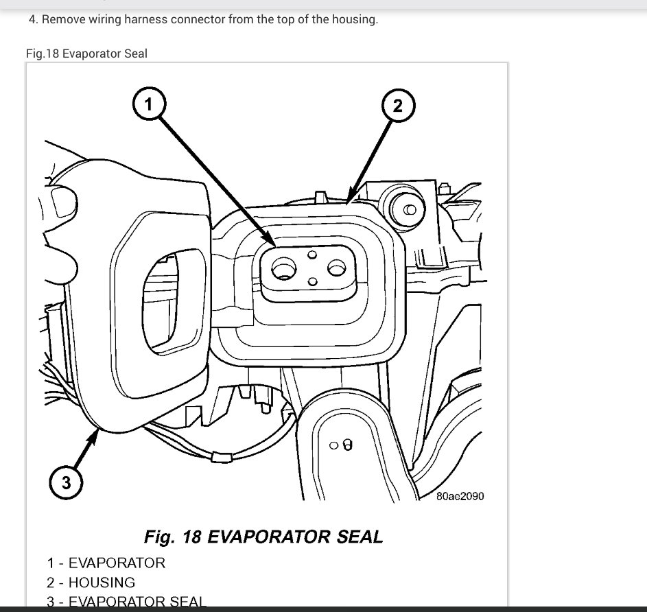

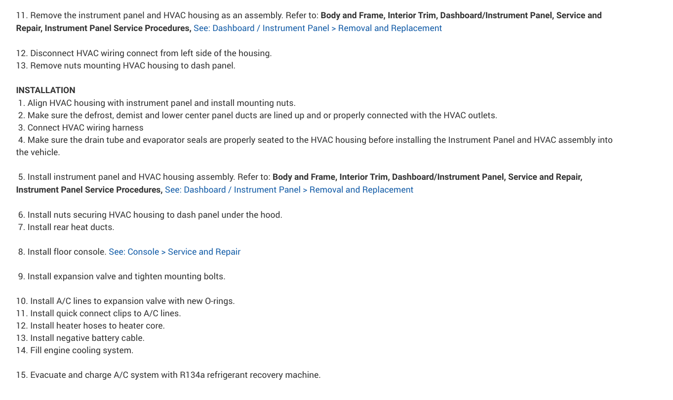

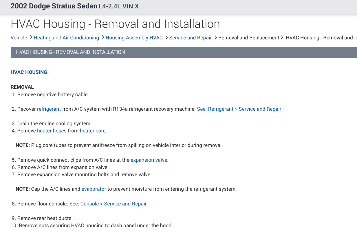

This sounds like your vehicle's heater core is leaking. In the diagrams down below I have included the instructions for the removal and installation of your vehicle's heater core. Please go through these guides and get back to us with how everything turns out.

The floor doesn't feel like antifreeze. Antifreeze has a certain feel to it plus antifreeze is not clear. I don't want to dig into my dashboard until I know for sure that's the problem. I just would think if it's my heater core my floor wouldn't have a actual frozen puddle that looks like water. I wouldn't think so anyway.
Saturday, December 14th, 2019 AT 9:11 AM
SCGRANTURISMO
  • 4,897 POSTS
Hello again,
Well, an easy way to ensure that your vehicle's cooling system doesn't have straight water running in it would be to simply take the cap of of the radiator and look inside to see if there is coolant or not. There really isn't anything else in your vehicle's dashboard that would leak any fluid at all, that's why I'm pretty sure that that's what itis. Please get back to us with what you are able to find out.

It's antifreeze in my radiator.
Monday, December 16th, 2019 AT 12:26 PM
SCGRANTURISMO
  • 4,897 POSTS
Hello again,
Okay, that's good. So if it was straight water, then can you please look around the front windshield and firewall for a possible entry way for water to have entered into the passenger compartment. It would have to be rain water getting in from somewhere. Please get back to us with what you are able to find out.

I'm afraid this is not going to be a simple problem to resolve. The issue is going to be internal to the HVAC housing. The air doors operate flaps inside the housing to direct air. I can't tell you the specific issue but usually the blend door is actually a dual door on a single shaft that operates within separate compartments for left and right vents. Something is either broken or no longer has good air seals and cool air is being mixed with the warm air. The easiest way to approach this would probably to just buy a whole used housing complete with all doors and actuators. If you take this one apart, you may or may not recognize the problem and it's a lot of work to get it out. The entire dash has to be removed.
