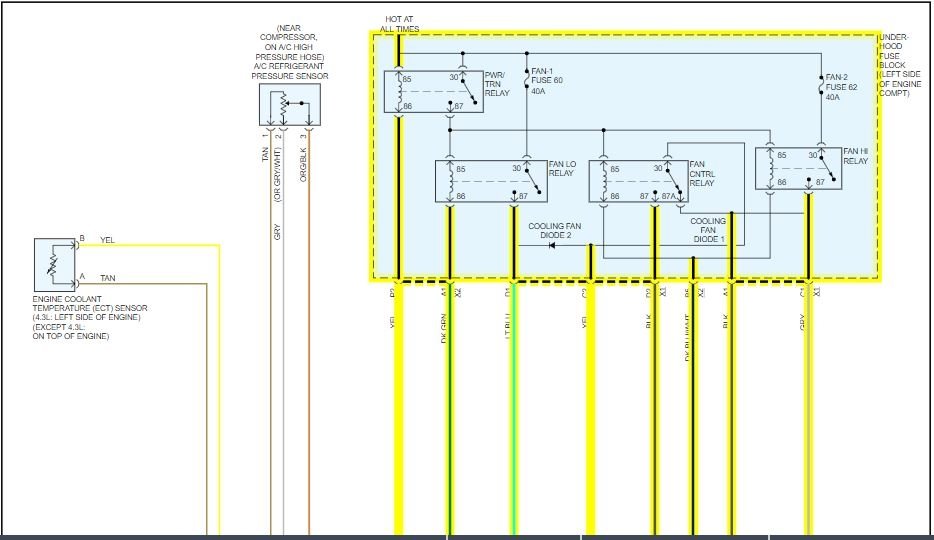

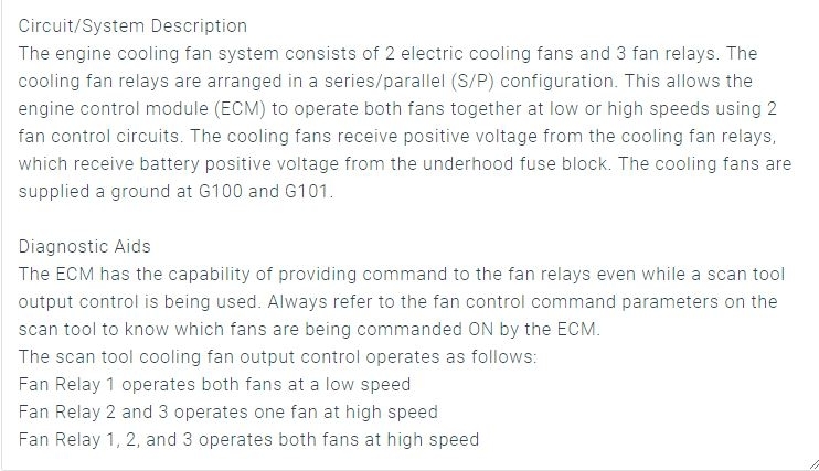

Are the cooling fans working?
https://www.2carpros.com/articles/engine-overheating-or-running-hot

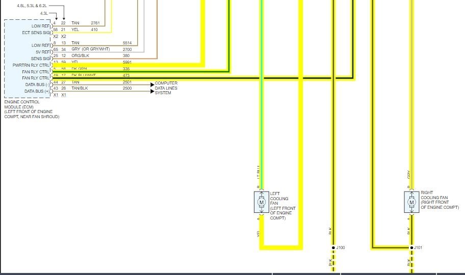

I attached a wiring diagram for you to view. Check the 2 fuses in the diagram for power on both sides.

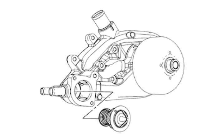

I would change the thermostat as well to be sure it is working correctly.
