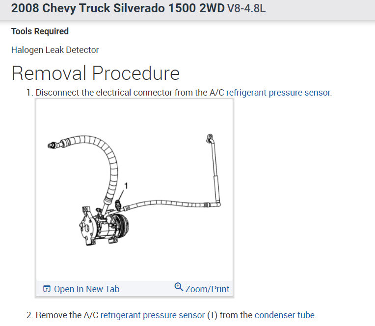

This can happen when the AC system is over charged which will trip the high pressure sensor for the system causing the AC engine hot warning. Here is a guide to help you with the problem.

The guy put too much Freon in it, let some out everything is great!

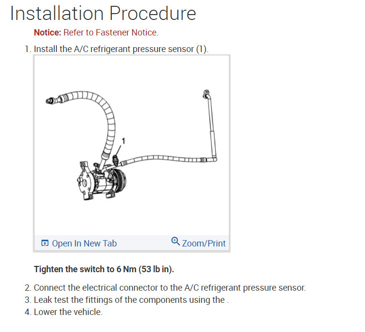

tis happens when the AC pressure sensor goes out, here is the location so you can replace it. Check out the diagrams (Below). Please let us know what happens.
Jun 1, 2021 at 11:27 AM (Merged)
ESTILL
yep this was the problem for my truck, thanks.

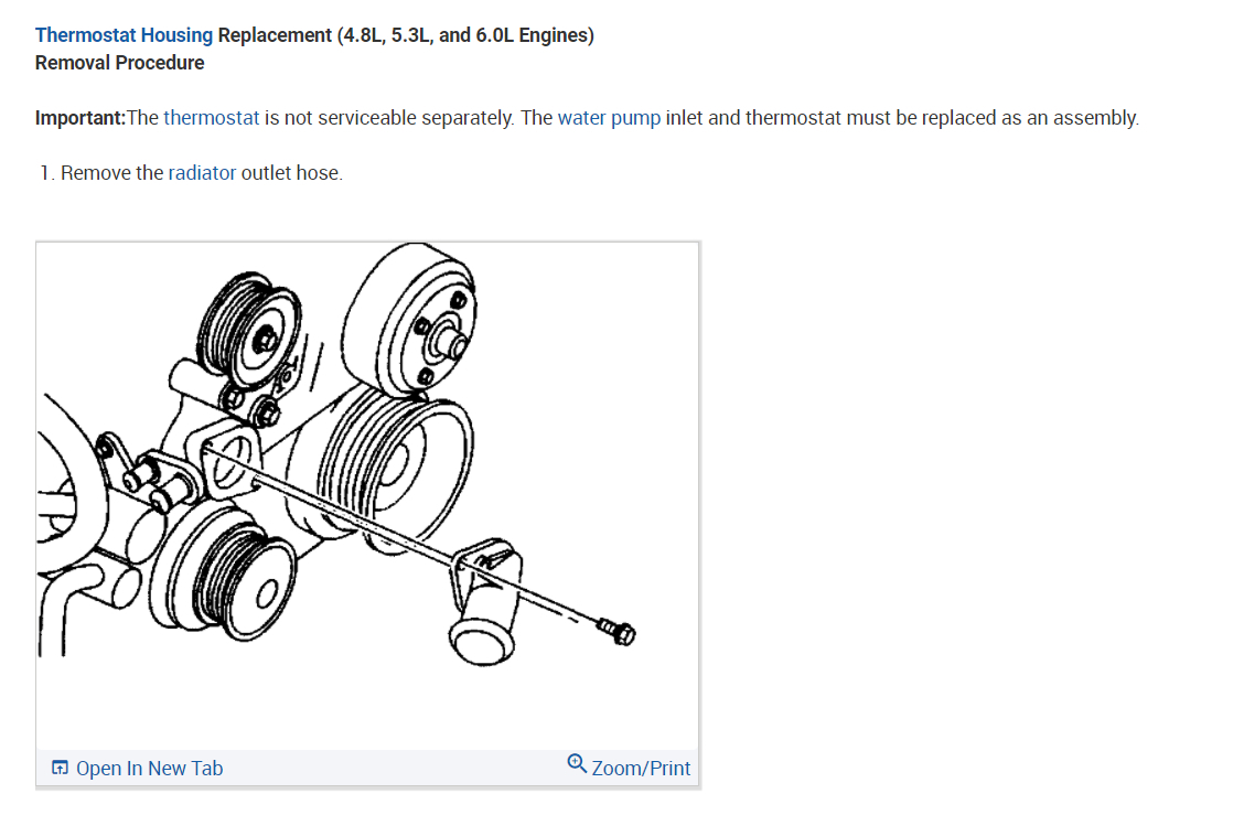

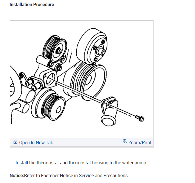

  • 110,244 POSTS

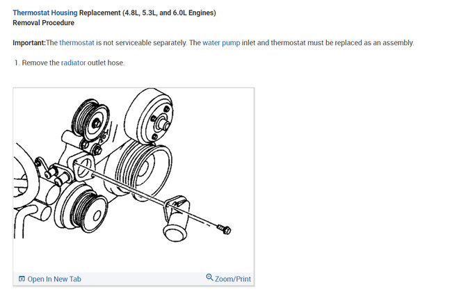

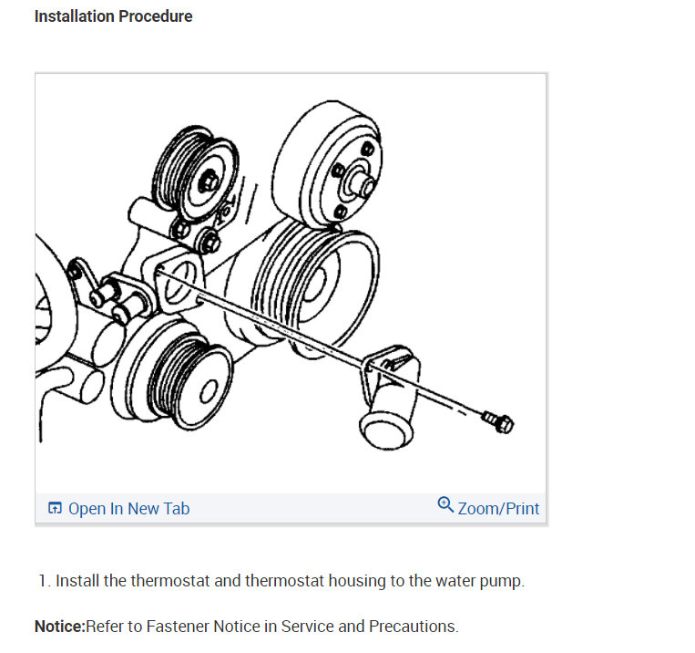

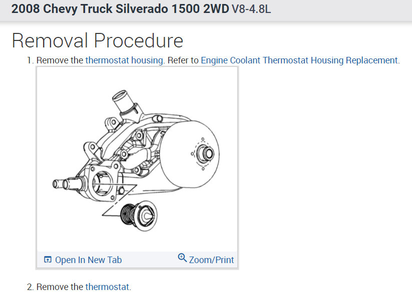

this will happen when the thermostat sticks closed. Here is a guide to help you step by step with instructions in the diagrams below to show you how on your car.
Check out the diagrams (Below). Please let us know what you find.

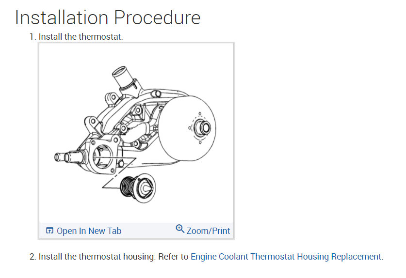

I would start by changing the thermostat. It may be stuck shut and not allowing ant coolant to circulate.
https://www.2carpros.com/articles/coolant-flush-and-refill-all-cars
I attached pictures and the procedure for you for the repair.
