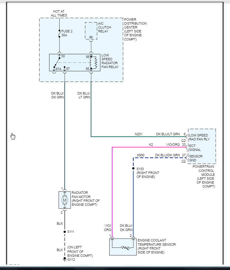

Alright, it started overheating on me Saturday. I had an oil change last Wednesday 9/30/20. i have changed the water pump yesterday 10/06/20 and the thermostat today and it is still overheating. I just need to know what else I can try to fix it.
Oct 7, 2020 at 4:02 AM

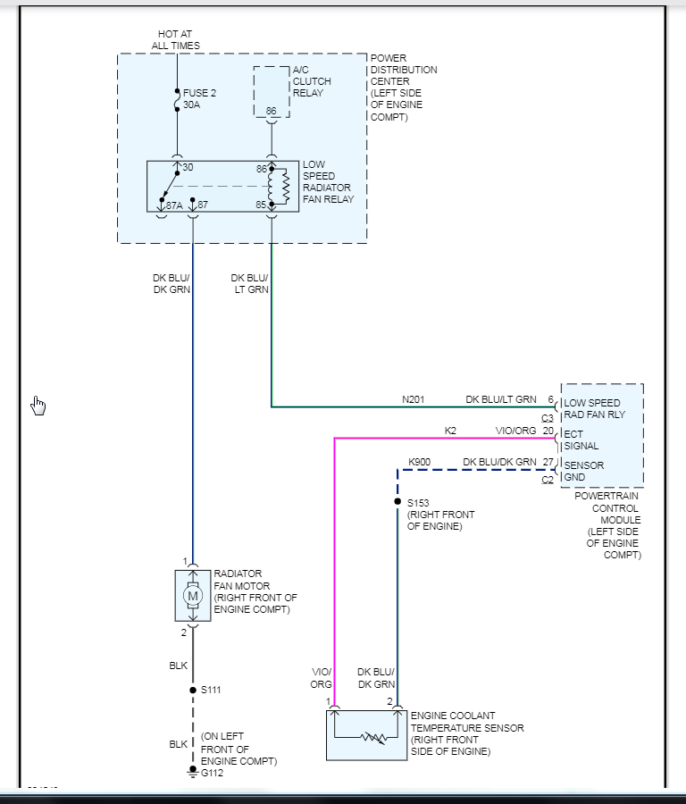

Couple things. When does it overheat? Idling or do you have to drive? Next is the cooling fan working? I attached the wiring diagram to check and make sure you have power if the fans are not working.
