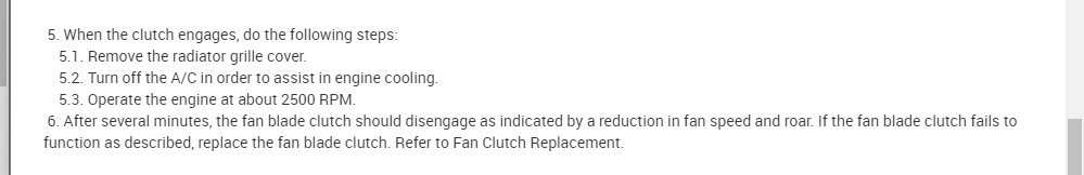

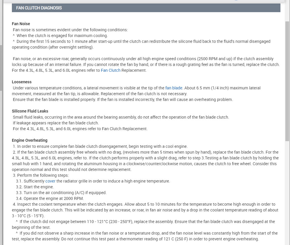

Basically, we need to start back at the beginning with this one because I suspect we have missed something so the next thing to check is if the fan is spinning on high when the engine is getting hot.
If not, then we most likely have an issue with the fan clutch.
https://www.2carpros.com/articles/fan-clutch-symptoms
Please see the attached info below on how to test the fan. Please run through all this info and let us know what questions you have. Thanks
