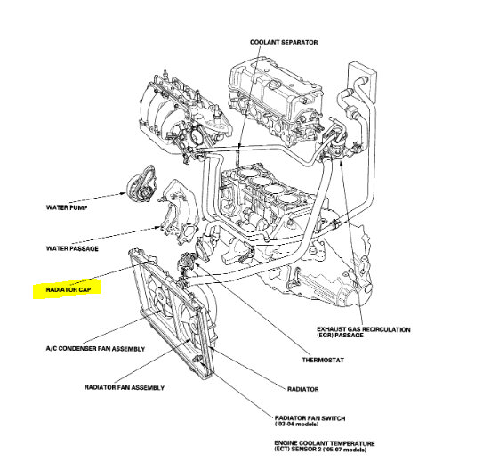

My car started to overheat yesterday and then the heat stopped working as well.

You are most likely low on engine coolant. Check that first. If it got low that quickly, check for leaks.
Here is a link that explains how to check, locate, and repair a leak:
https://www.2carpros.com/articles/car-is-leaking-coolant
If you look below, I attached an exploded view of the radiator and cooling system. When the engine is cold, remove the radiator cap and check the coolant level.
Let me know what you find.
See pic below.
